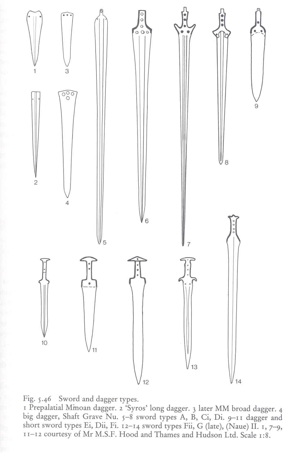

Below are a couple scanned images of Aegean Bronze Age swords - the first from Connolly (Odysseus), the second from Dickinson.
Good luck!
-Jess
Good luck!
-Jess
