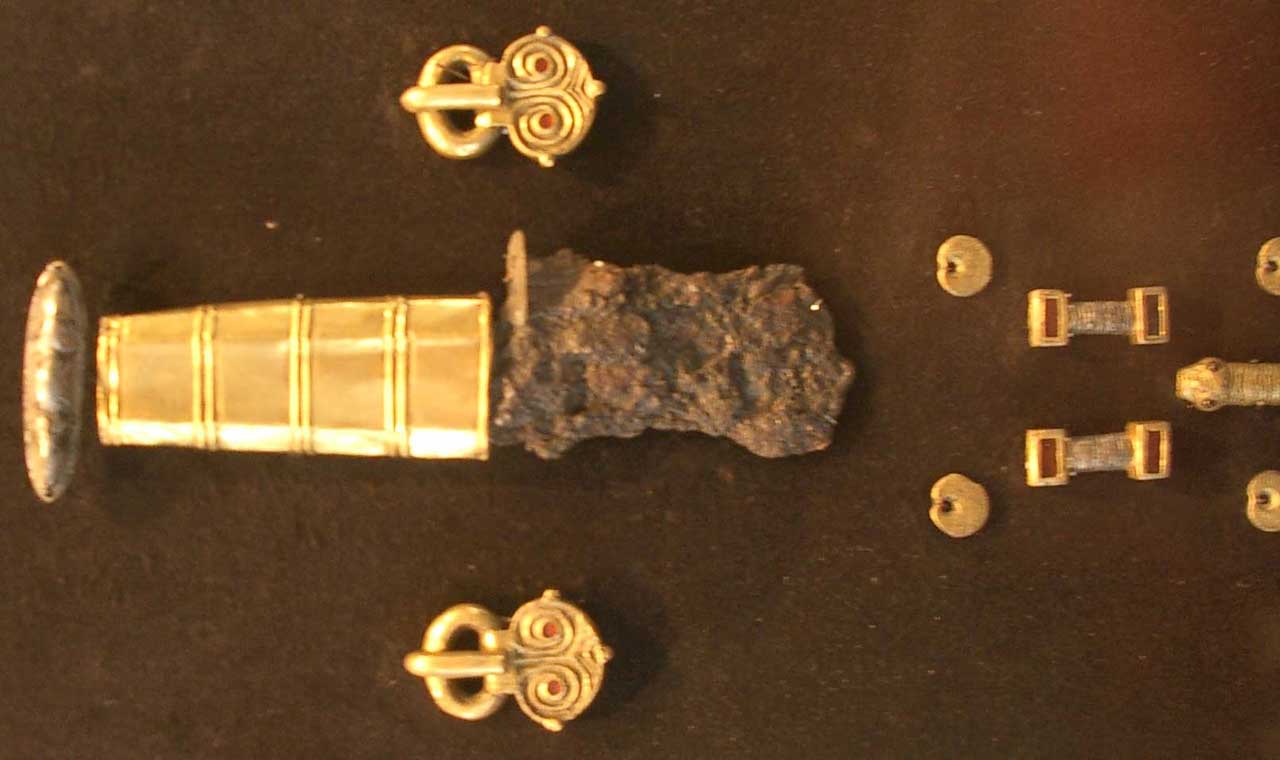

This is all as far as know, and it does involve some guesswork, but here goes:
- The pommel cap is probably hollow, and probably gold plated silver or bronze (Edit: Menghin lists the material as "gold")
- I guess the pommel cap was attached to the upper guard with hidden rivets / nails
- The guards were made of organic material, probably either wood or bone, covered with thin gold foil and cloisonné (edit: on the visible side only).
This picture, taken by Zach Luna at the exhibition "L'Epée" at the Musée de Cluny may clarify a few things.
 Attachment: 64.22 KB

Hi Paul, thanks for the pic, and for the info.
This pic clearly shows that the upper guard is now hollow, so it probably had an organic interior. It also shows that the upper guard is broken at both ends, so we can't tell if there were holes to allow for rivets. As for the pommel I've never seen a picture of the underside of it, so I don't know if it is solid or hollow, or if it has nails for riveting. So has anyone here ever seen the underside of the pommel on Childerics sword?
I do know (or at least according to Patrick Barta, who examined the original) that the pommel from the Blunica sword is solid gilt silver. Although the Blunica sword is a contemporary, and of the same type as, Childeric's sword, the pommel is slightly different, as the pommel of Blunica sword was cast in none piece with the top plate of the upper guard, while the Childeric swords pommel is seperate. Does anyone here have any info on other swords of this type, e.g. Snartemo, and their construction methods?
