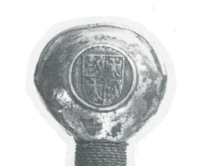

Here are three examples, all using enamel.
 Attachment: 68.88 KB

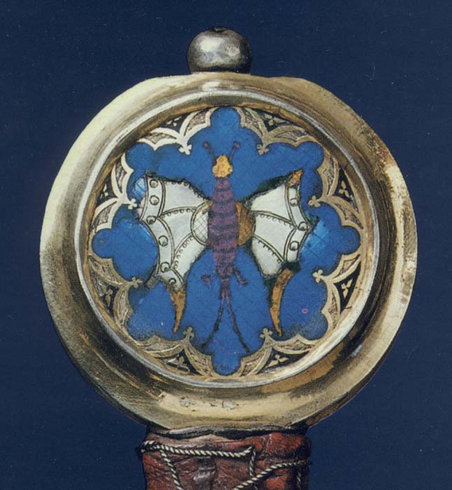

Not a conventional heraldic device, just an interesting butterfly.

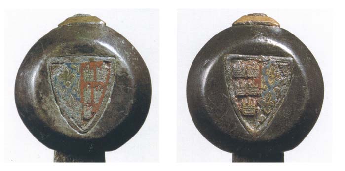

 Attachment: 34.36 KB
Pommel (obverse and reverse) of sword of Prince Alphonse, Count of Poitiers and Toulouse, ca. 1250
 Attachment: 65.72 KB
Sword from Toledo Cathedral
