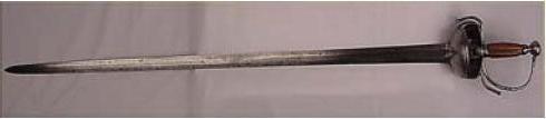

Here is a picture from Higgins Armory Museum of a bilbo in their collection. This piece is dated to 1st half of the 17th century. In case it is helpful, here is the description from their catalog:
Higgins Armory Museum wrote:
Steel double edge flattened hexagonal section wide blade tapering gently to spatulate point. Hollow-ground on both forte faces. Obverse face stamped "xx ENx RLQUE xGOEL x"; reverse "xxx EN x ALAMANIA x" (for 'Heinrich Kökl or Coel). Both terminating with anchor-like cross mark at end. Aysmmetrical bivalve iron shell bent toward guard, screwed to butterfly-shaped base plate of large arms of the hilt at short ricasso. Crossguard recurved in plane of blade with balustered teminals. Curved knuckle guard balustered at mid-height with similar terminal. Swollen pommel tapering to stout base. Wooden grip wrapped in braided brass wire & reinforced by iron strips on faces.
I marked in bold a part of the description that jives with Allan's comment.
 Attachment: 7.08 KB
HAM 671

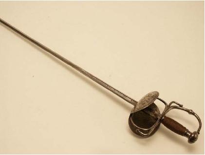

Here is another item from the Higgins Armory Museum, but they call this one a "Bilbo-Hilted Rapier". This catalog description also refers to the guard as having
... asymmetrical bivalve shell bent towards hilt ...
The hilt construction is a little clearer in this picture.
 Attachment: 10.41 KB
HAM 1803.1
- Sir Toby Belch
