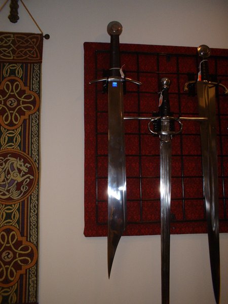

PostPosted: Sat 19 May, 2007 5:41 pm    Post subject:         Reply with quote
Well I liked it.
Nice balance not a boat anchor simply I would buy one if I could. has the potential to be a devastating cutter.

Hey thanks so much Duncan! I wasn't expecting a positive impression actually. I thought the balance would be off due to the size/thickness/shape of the blade, but I am pleasantly surprised.
Your picture is great because it shows the scale of the falcion compared to the other swords (BTW, Duncanm what's that one on the end, I don't recognize it, another new offering?). Seeing it next to the others makes it look more impressive and better proportions than the Kult of Athena stand alone pic.
I may have to pick one of these up and try it for myself.
It looks like their old Higgins Armoury sword they used to offer....I wonder if they're bringing it back?...I always thought it would make an interesting project piece.
