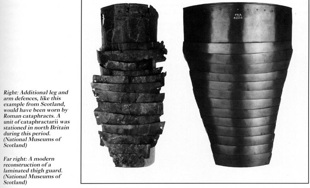

Amongst other things, it shows a excavated, banded tight guard, similar to the ones shown worn by catapractoi in the grafitis and reliefs...
Attachment: 67.89 KB

I have come across something somewhere which says that those "cuisses" might actually be vambraces. Either way their construction does seem to be similar to the limb defences apparently being worn by gladiators, Parthian cataphracts etc.
Elling Polden
Posted: Mon 20 Feb, 2006 12:52 pm Post subject: |
MOAOAOHAHA!!! Rise! Rise I say!
Hard to say, from the picture... But they could quite posibly be vambraces, especially if they have been flattened somewhat in the earth...

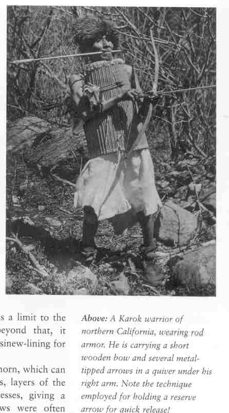

I have a soft spot for organic armour....plant fibers, wood, bone, horn, stone and minerals, stuff like that. Here's some examples of non typical body armour from various places in the world:
Attachment: 52.2 KB
Attachment: 71.85 KB
