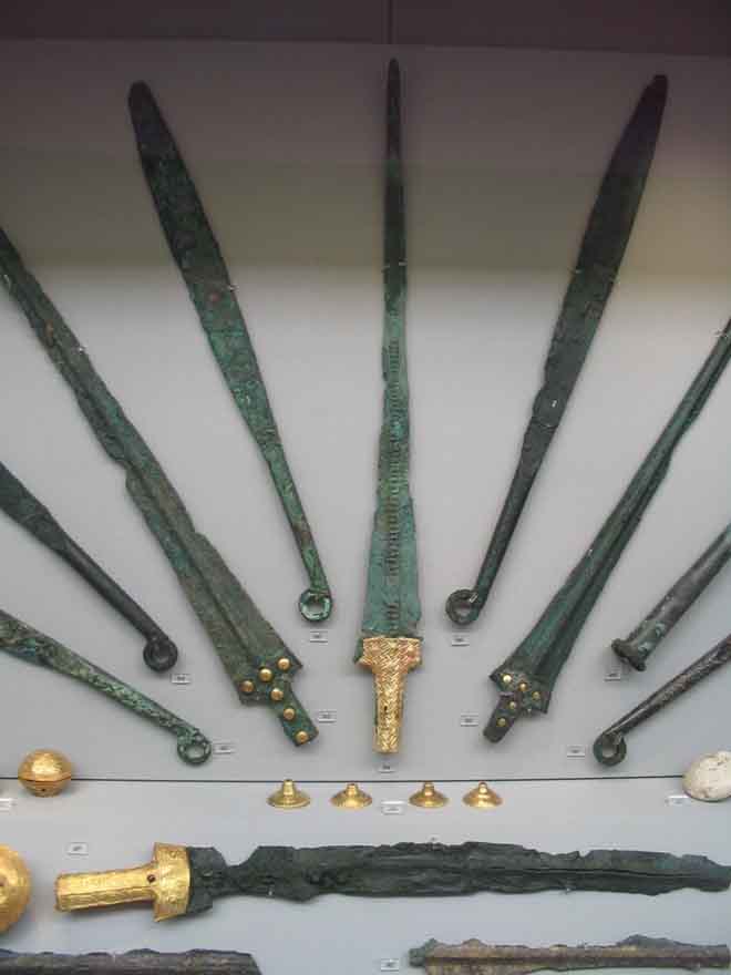

There are some bronze implements that are single-edged, with long round-section grips that end in a ring or loop. The whole thing is apparently cast in one piece, without anything that looks like a guard. I haven't seen any information on weights or thicknesses for these things, but I suspect they are cleavers meant for sacrificing animals. Ah, found a photo!
In any case, I don't *think* this could be a predecessor for the kopis. BUT there are some iron kopis-like blades that seem to be rather heavier, and have what seem to be thick rod tangs, or a thick square (diagonal) hilt/grip. Again, I'd call these "cleavers" and not swords. Some kind of cleaver, perhaps these exact things, are seen in vase paintings, being used to kill animals, not in combat.
Bottom line, although there might be some relation between the cleaver-tool and the kopis-weapon, it may only be superficial. And only the cleaver has a known Bronze Age ancestor.
Matthew
