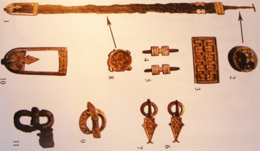

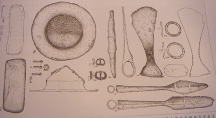

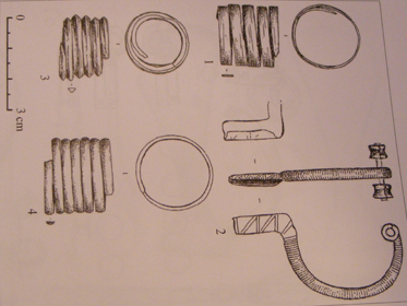

Greetings Till! OK,here I'm puting other artefacts from that grave No.5. Enjoy :-)
 Attachment: 103.12 KB
A belt buckle and spurs.
 Attachment: 120.02 KB
A whetstone,spears and shield umbo.
 Attachment: 111.22 KB
Finger rigs and brooch.
Proud to be where I was born !

Thank you for posting this info.

Now I really see some different stuff! The rings/bracelets and fibula for example. We don't have a lot about Lithuania in our library here. The Axehead is also interesting.

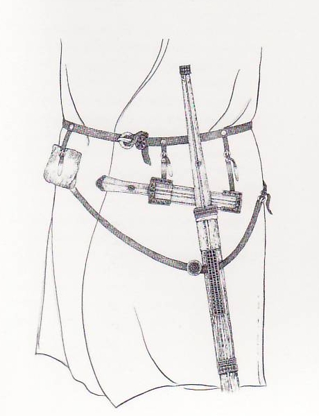

Concerning the hilt and scabbard of these swords, I have posted some pics from Nydam on the first page of this topic.
Does your sword have a flat rhombic pommelcap or is it more pyramid shaped mini pommel?
The hilt would be some form of H - shape liek the ones I posted. Concerning the scabbard: On your pictures you still see the baldric sliders in situ on the scabbard left side of the buckle:
a thinn baldric would go through them and be slung across the breast and right shoulder of the carrier while the sword would hang at his left side.

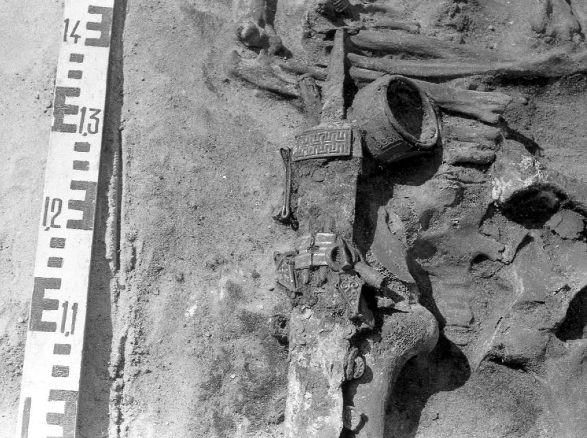

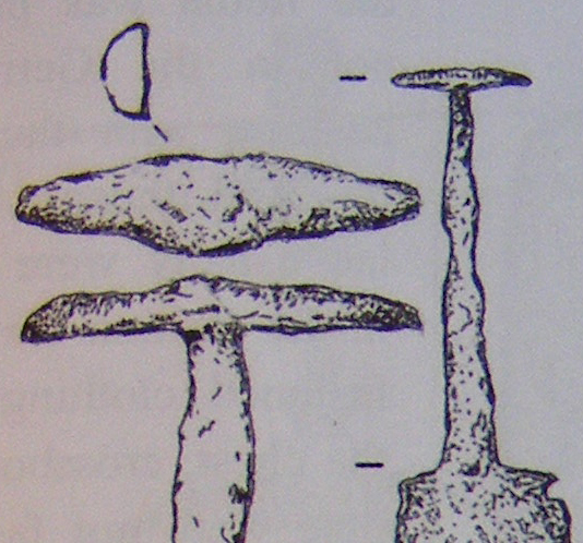

The pommelcap of this sword is more like stream-line rhomb(look to the attached photo). And really BIG thanx to You for the photo of Nydam(?)-second attached file.I'll make such kind of handlle. Artefact handle does made of wood or horn?I'll make from different kinds of wood,I wonder...
And the third photo is full set of sword and scabbard details.There are three small buckles and the larger one.The larger buckle is of belt.The three small ones are from baldric, is quiete sure.The smallest one buckle is for baldric catch.But I still don't understand for that are these two buchles(in situ they lie on the left and the right sides of scabbard).Any ideas?

Thanks Arunas, I was also wondering about the pommel cap, so thanks for those pics, especially the last one in colour, very helpful, thanks.

I have some drawings of different scabbard carrying methods but i need to go working now and can't scan them in and post them here. I will do it tomorrow.

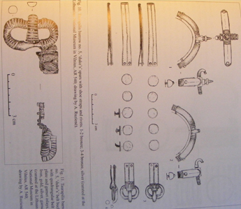

Here's another style of scabbard suspension from a hunnic kurgan grave in Brut/Russia (middle of the 5th century) I guess with the two buckles on each side of the slider, the sword could be detached from the belt/baldric. If this is the case, it would mean that it was directly attached to the main belt worn around the waist, but I'm not sure about it. : Worried .

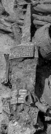

Hail to You, Till ! Thanx for the exertion, but this is not this sword "style". Look at the buckles on the left and right side of scabard ,they are nearby. And the buckle of baldric is lying under. Maybe the baldric belt was rolled up around the scabbard before the puting to the grave?
Any more iages about "wearing" such swords?
