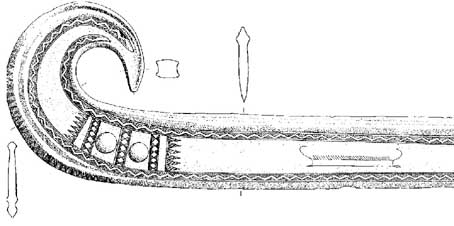

I managed to find the archaeological drawings of the two Danish finds of bronze age "scimitars".
They show that both were sharp in the straight section of the blade, but were more or less blunt in the curled up end.
I attach scans of the outer parts of the blades. I hope the scans are clear enough to make out the details in the cross sections.
The drawings show that the edges were shaped quite like that of an axe. Clearly sturdy enough to do damage on bone.
Both originals are a bit damaged, so it is no mystery one might think they are blunt, if you only see them as displyed in the rather dimly lit vitrines of the National Museum in Kopenhagen. As the curled up ends does not really show an edge, the impression that the whole blade might be blunt is easy to get.
The one I got to handle in Stockholm had the same cross section as the Danish ones: it is very similar in all respects. This would show that all three "weapons" would probably have been put to the same se, whatever that might have been.
Perhaps this can put a perspective on some seemingly blunt Kopesh as well: if the bronze is damaged by corrosion an axe style edge could well look like it has never been sharp. I do not mean to imply that all were originally sharp: the Iranian one in the British Museum was clearly blunt to begin with. I would expect other were just like that one.
 Attachment: 33.65 KB
 Attachment: 37.74 KB

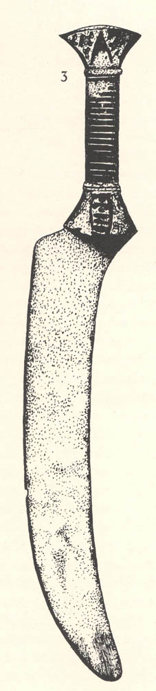

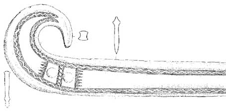

I just got some information on Canaanite khopesh examples from Brock. It comes from Swords and Daggers in Late Bronze Age Canaan by Sariel Shalev, part of the PBF series.
There are a total of 11 khopeshes, divided into 5 types designated Types 8A-E. I'll post a drawing of one from each type and information on all of each type. The shortest is 36.4cm long, the next shortest is 55cm and the longest is 64.2cm.
The author has an odd bit of terminology. He divides each into 3 parts: hilt, handle and blade. The hilt is what we'd expect by that term, but handle refers to the non-hilt, straight and unsharpened portion of the sword. The blade is the curved, sharpened portion. The maximum width and thickness he cites are for the hilt and I think they are for the fore-end of the hilt. The term he actually uses is hilt-base.
First up, Type 8A. Average length is 57.1cm, width is 4.2cm and thickness is around 1.7cm. On average the hilt is 20.8% of the total length and the blade is 52.7%. Now for the individual swords.
#165 from Gedor (cemetery), Judean Hills. L. 56.3cm, W. 4cm, Th. 1.8cm. The hilt is 24.2% of the total length, the handle is 24.2% and the blade is 52%; width is 7.1% of the length. L.B. II, first half of 14thC. Location unknown.
#166 from Gedor (cemetery), Judean Hills. L. 57.8cm, W. 4.4cm, Th. 1.6cm. The hilt is 21.3% of the total length, the handle is 24.7% and the blade is 54.5%; width is 7.6% of the length. L.B. II, first half of 14thC. Location unknown.
#167 from Gezer (tell), Shephelah Plain. L. 57.2cm, W. 4.2cm, Th. 1.6cm. The hilt is 22.9% of the total length, the handle is 25.3% and the blade is 51.7%; width is 7.3% of the length. Found with remains of ivory hilt plates. L.B. II, first half of 14thC. Location Museum Istanbul.
#168 Origin unknown, purchased in Beirut. L. 62.9cm, W. 4cm, Th. 1.5cm. The hilt is 12.3% of the total length, the handle is 25.3% and the blade is 51.3%; width 6.4% of the length. Thought to be L.B. II. Location Museum Munchen.
Now the drawing of #166.
http://1501bc.com/files/khopesh/Khopesh_8A_Ge..._14thC.jpg

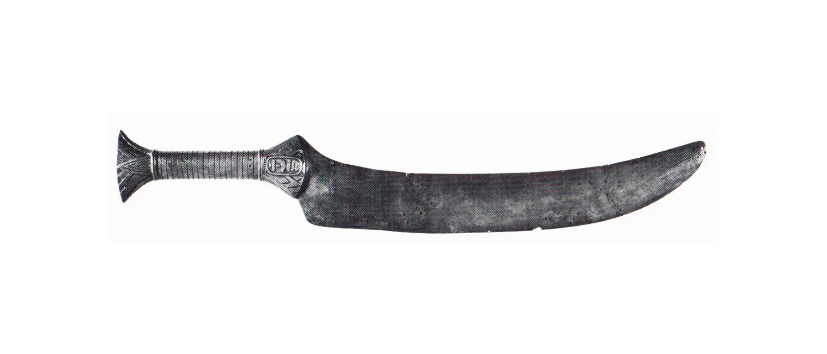

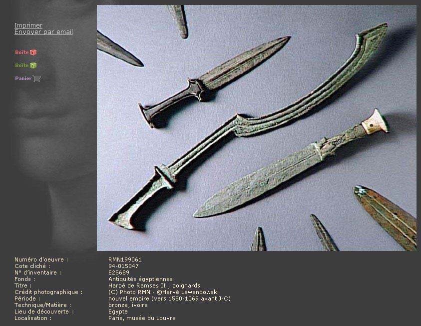

This may be the same khopesh, but I can't verify it:
http://1501bc.com/files/khopesh/Egyptian_swords.jpg[/quote]
Jeroen this is the same Khopesh, I found this on a French site, see attached.
Danny
 Attachment: 116.83 KB

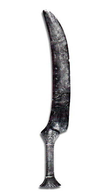

A short khopesh/knife:
Jeroen
Do you have further information on the khopesh above?
Why do you call it a Knife?
Do you have dimensions?
Thanks Danny
 Attachment: 99.39 KB
 Attachment: 59.89 KB
 Attachment: 65.53 KB
 Attachment: 109.2 KB
Jeroen
Until you posted this, I only had the picture.
It looks more like a curved knife then a khopesh. It doesn't have the straight unsharpened part between the grip and the curved blade.
No dimentions. Judging from the length of the grip, I'd guess it's 30cm, give or take a few cm.
