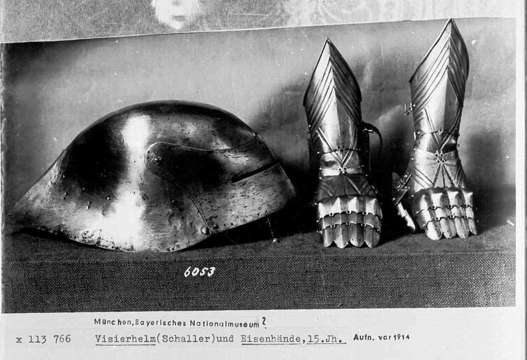

Dont know if pics of this BEAUTY has been posted before, but just to make 100% sure no lover of the 'Schwarze Schaller' goes without..;
"Black sallet. Southern German, circa 1490.
A light helmet forged in one piece with a widely extended skull and lightly pulled-in sides. The ridged neck protector coming to a point. Clearly visible hammer marks. There is minor damage both at the left temple and on the right side. The smooth visor (possibly replaced) has a broad eye slit and opens upwards. The hinges have crenellated edges and embossed decoration. There is a spring latch on the right side. Surrounding lining rivets with remnants of the original leather. Visor and skull are surrounded with double holes for attaching a fabric cover. On the inside an old label from the Leichtle collection in Kempten, as well as the engraving "IKL" (Iohann Leichtle Kempten). Attached collection label from the Kempten City Museum, where is was on loan from 1946 - 2006. Height 21.5 cm. Length 45 cm. Weight 1580 grams.
Cf. a nearly identical example in the Kunsthistorisches Museum Wien illustrated in Howard M. Curtis. 2500 Years of European Helmets, pp 172 f."
It was up for auction on Hermann Historica recently, went for 30000€ if im not misstaking.
My query is about this one; (it is sometimes caregorized as a 'black sallet' but it really only shares the "style" and not the "black" (forge rough) surface that im assuming is the reason for the name.)
What im looking for is any better pictures of this one, and any further info.

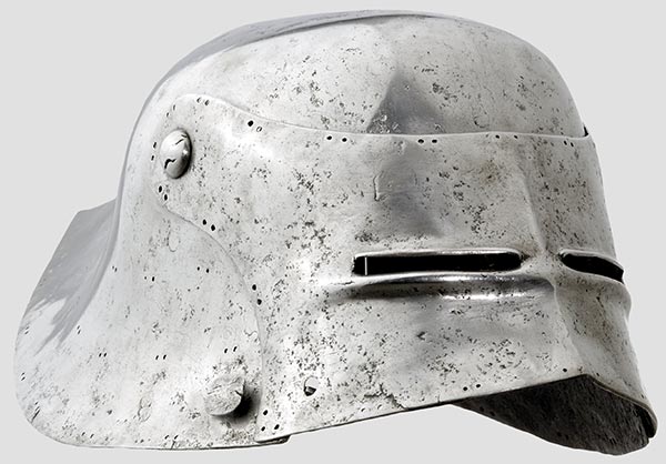

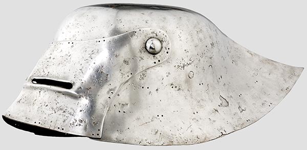

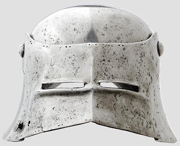

Not sorry to resurrect this thread, here is another WONDERFUL specimen:
"German black sallet, circa 1490. Skull forged in one piece with a long ridged neck protector. Movable visor with two separate eye slits surrounded by protective ridges. A spring-loaded latch on the right side. Lining rivets around the inside. The rim and the sides have numerous double holes for attaching a missing cloth cover. Height 19.5 cm. Length 49 cm. Weight 2503 grams."
A sidenote is that this "black-sallet" is the whitest helmet ive ever seen!

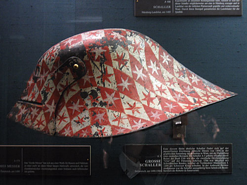

I got questions to the German "Black" Sallet, c.1490 with Painted Decoration
I have heard it belongs to the Royal Armouries in Leeds.
Do someone have another pictures from this sallet, maybe from the front, back and upside, or do have connection to the Royal Armouries, I would pay for good pictures Wink .

Front of German "Black" Sallet, c.1490 with Painted Decoration

This example is from the Bayerisches Nationalmuseum in Munich. I could locate a link with an other but not a better picture of a.m. sallet:
http://picasaweb.google.be/true.fork/ArmourIn...4002648226
Best
Oliver

One can safely assume that most if not all of these helmets were left scaly black and rough from the hammer. The state the polished specimens are in suggests they have been polished some time later, presumably in the 19th century.
The Munich specimen looks thin like tinfoil. I am pretty sure a piece in a very bad state of conservation has been overly polished by some 19th century curate in order to turn it it into yet another shiney knightly helmet. Same goes for the two sallets from Herman Historica.
Not only do these helmets look odd- they are odd. Most of the were worn like kettle hats or morions, the visor serving more or less only as a decorative element. If you pulled the helmet down that you could look through the visor´s slits, the rear would stand up at a grotesque angle.
Have a close look at Albrecht Dürer´s engravings and the preliminary sketches to "Knight, Death and the Devil", or at contemporary work by Israhel van Meckenem and others- their sallets look out of shape.
They are.
The tail protects the neck, the skull conforms more or less to the wearer´s head, and the lower edge of the visor protrudes around the wearer´s face like on a morion or a late kettle hat. These helmets actually are worked in the shape of a roughly shaped, tilted- back sallet, just like the pseudo- corinthian helmets of antiquity that sported all features of the classical corinthian helmet, cheekpieces, nasal and all, only that they were worn on top of the head like a tilted- back corintihian helmet.

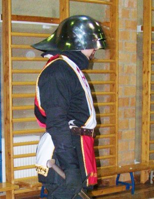

Okay, since the last time I wrote my armourer created a Black Sallet for me, which is not a replica, and not so well made, in fact, but still the functionalities are the same. It's still shiny, I am thinking about painting it to one of the main colours we know (the red one, or the yellow-flamed one... or the Vienna? let's see.)
I have experienced the following:
Yes, the helmet is generally a good one used as a kettlehat with a bevor. Looks great, feels great. But when I take an armoured stance for halfswording, the eyeslits are in a good position to see through them! And while fast riding (charging?), this is the case as well, the tail protects the neck while the exeslits get to the right place.
There is another possible explanation I heard, that these openings were in use during sieges, while climbing a ladder. Sadly, there were not so many actual stromings of fortresses, when it came to a siege. So this is not so likely in my opinion.
