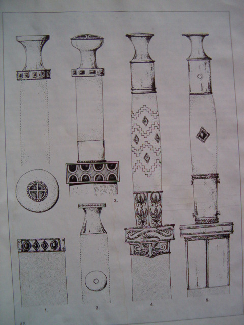

Stephen, according to István Bóna (in the "Migration period sword" topic) it is an easter sword of iranian origin.
F.e. the swords in the 5. picture in my first post there are iranian (ok, sarmatian. At that time was the ruler class in Persia, Khusan, and Baktria sarmatian, and their warriors were bodyguards in most of the Asian countries).
Zoltán

I just looked at the 5 drawings in your post on the migration period sword thread and I'm sorry but I still dont see any resemblance between them and the Stilicho sword, but then again maybe I could be missing something.
Persian swords from Istvan Bona:
http://www.myArmoury.com/talk/download.php?id=30493
Stilicho dyptich:
http://upload.wikimedia.org/wikipedia/commons...iptych.jpg
Commonalities:
- Short, thick guard
- More or less same pommel
Difference:
- the shape of the hilt
Nevertheless, I agree with Zoltán that Stilicho's sword is most likely of Persian origin. To be honest, I couldn't think of a better origin...

PostPosted: Thu 21 Oct, 2010 2:09 pm    Post subject:         Reply with quote
I'm not so sure here.
I'm no expert in persian arms but I always thought that their swords would rather look like the one Shapur II. is depicted with on this 4th century silver dish.
During my brief web search I didn' t find any other kind of sassanian hilt design then this until much later.
Also Henrik stated that these swords would rather be sarmatian then sassanian swords.
Have similar swords been found in Persia?
And I finally would disagree with your opinion that the pommel of Stilichos sword looks like the pommels of the sarmatian swords we currently speak about. The vase shaped pommels of the sarmatian swords are very different from Stilichos.
His pommel looks either mushroom shaped (there ring some bells in my head, I will look into my library later on, I think I've seen this somewhere else already...) or like a small upper guard with a rounded pommel.
Definitely not sarmatian to me.

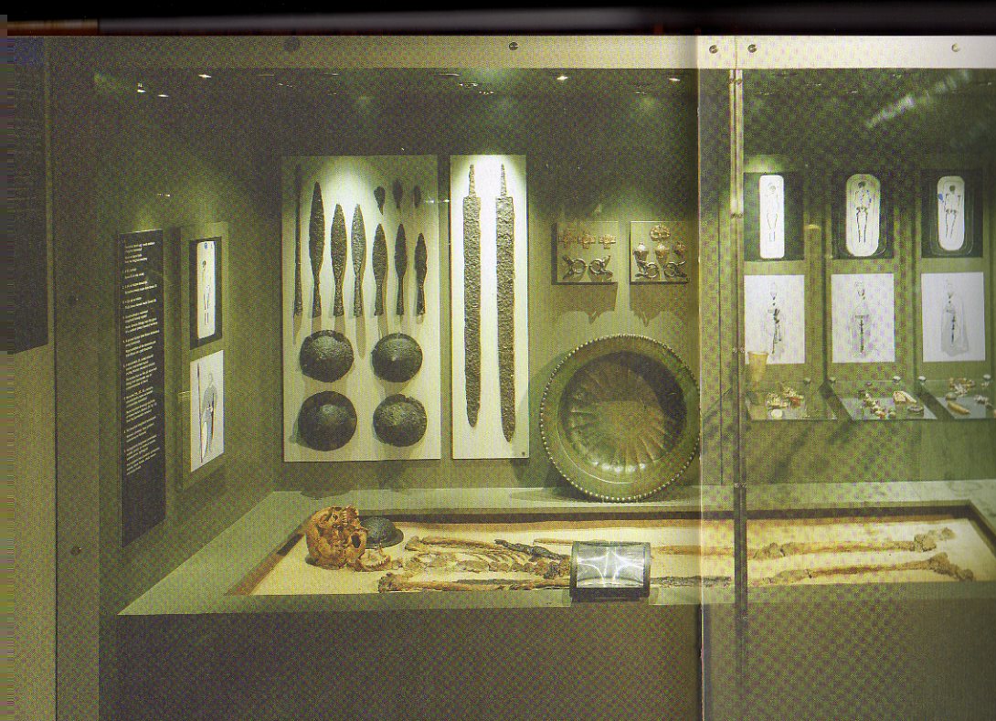

Gepide weapons in the Hungarian national Museum, and a german sword from the 5th Century, From Csillag Ferenc: Kardok történelmünkben. A very good book with a lot of blades and manufacture marks, but the first 3000 years of the sword is shown on one page, the other 140 pages are full with the 11-20 century..., so after my favourite times...
Regards:
Zoltán

The caption to the picture from Bona reads:
"With the eastern Huns common double edged swords and daggers of Persian type" and "pallash-shaped Hunnic swordtype of Sassanid-Persian origin."
The find places:
1) Kalinino, Crimea
2) Kerch grave 145, Crimea
3) Cilibium gravefield 1, grave 43, Abchazia (dagger)
4) Turajewo, kurgan V, Tartar autonomous region, USSR
5) Musljumowo, Perm government, USSR (reconstruction)
To the Stilicho diptych, Bona says "The sword, hanging from an Iranian-inner Asian belt, is not comparable to contemporary images, and betrays oriental, probably Hunnic connections."
I'm not an expert on Persian weapons, but the rest of Istvan Bona's book "Das Hunnenreich" (Konrad Theiss Verlag, 1991) seems to be well researched, so I trust his opinion on this matter as well.

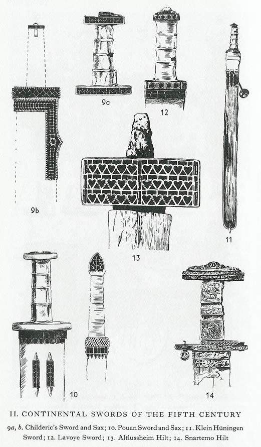

Till J. Lodemann wrote:
this sword does definetely look like the ones from the ivory dyptichs. But given the distance in time, there might not be a significant connection between them.
Nice sword, but I'm not sure that the way they layed the parts out is correct. For instance, the "pommel" seems like a hanger to me...
But regarding the time-frame, the website says 400-450 C.E., From Kerch. So that is Stilicho's time. The diptych was carved in 395, according Wikipedia, so if both dates are correct, then it would be possible that Stilicho's sword is related to this one.
It's dated to the second half of the 5th century and was found in Lavoy, France, grave 319b. You can see a thumbnail of it about half way down this page (btw, if anyone has a better image of this sword I'd be very gratefull if you could post it)
See attachment.Happy

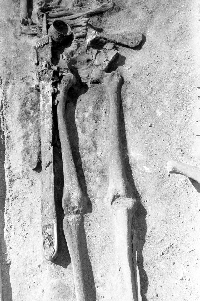

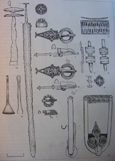

Surprise! Sword aged 4th-5th century from Baltic lands,Taurapilis cemetary.
 Attachment: 31.42 KB
 Attachment: 42.62 KB
 Attachment: 161.94 KB
 Attachment: 137.61 KB
Proud to be where I was born !

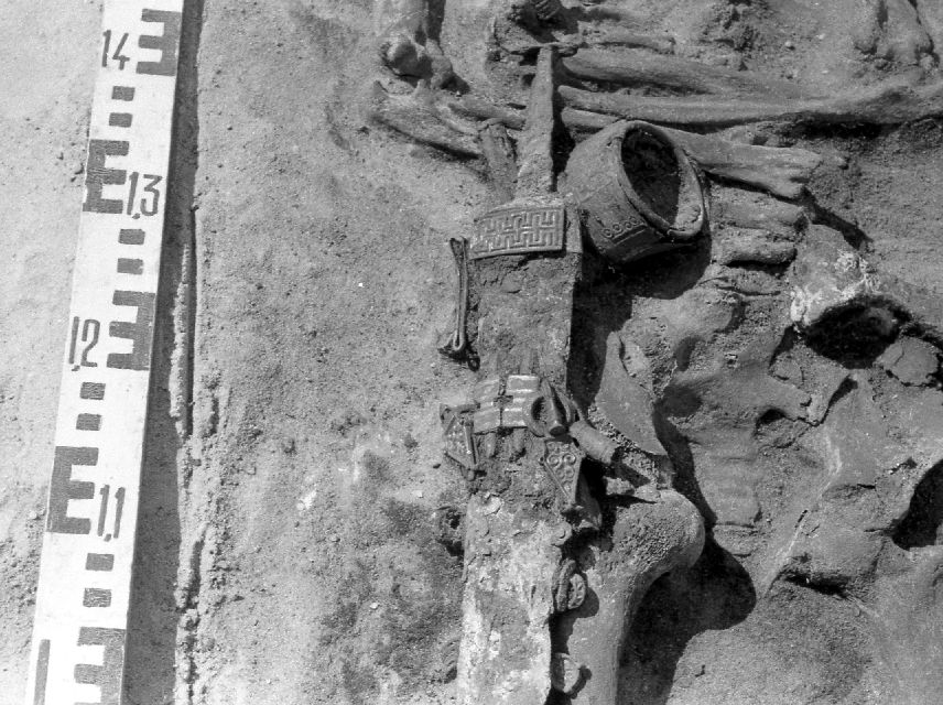

Scott Hrouda
Location: Minnesota, USA
Joined: 17 Nov 2006
Likes: 15 pages
Reading list: 87 books
Posts: 643
PostPosted: Sat 29 Jan, 2011 8:50 am    Post subject:         Reply with quote
Those are great photos of the sheathed sword shown, in context, with the remains of the owner during mid-excavation. Thank you so much for sharing these photographs. Happy
Don't overlook the beautiful axe head laying on his other hip! What is the cylindrical object near the hilt of the sword?

Arunas Bugvilionis
Location: Lithuania, Baltic tribes, Vilkatlakai
Joined: 24 Jan 2011
Posts: 41
PostPosted: Sat 29 Jan, 2011 2:50 pm    Post subject:         Reply with quote
Yeah, Lithuanian axes from that period are really beautiful.I promise in near future shall place some.
The cilindrical object is a silver binding of drinking horn.
Another interesting thing to the left of the sword is bronze pincette,quite popular part of the kit in 4th-5th C in Lithuania.A tool for higiene?

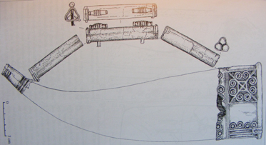

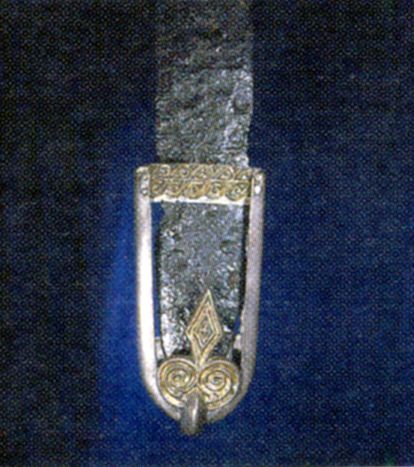

Here is full set of sword and scabbard details.
 Attachment: 104 KB
 Attachment: 79.19 KB
Drinking horn

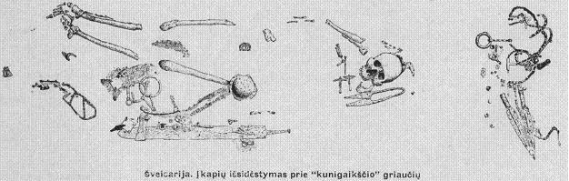

Arunas Bugvilionis
Joined: 24 Jan 2011
Posts: 41
PostPosted: Sun 30 Jan, 2011 2:12 am    Post subject:         Reply with quote

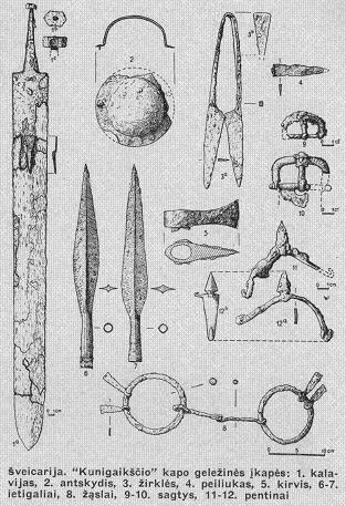

Another "spatha" from Baltic tribe Yotvingians cemetary Shwaicarja dated 4th-5th C.
 Attachment: 46.58 KB
 Attachment: 35.96 KB

Interesting sword for such a remote region. It seems Germanic, resembling one of the swords from Krefeld-Gellep, dated to the early 5th. C. But why does a Germanic sword end up in the Baltic?
Also, could you tell me a bit more about the method of dating of these swords? If your sword is significantly earlier than the one from Krefeld-Gellep, it may mean that for some reason the Baltic was somehow earlier with that style. I thought that that style was a development from Roman forms, but if "your" sword is earlier, then that may not make much sense.

In return of the Taurapilis burial date, there are some means by that was settled a date.Firstly, East Lithuanians(Taurapilis burial is within their area) in the end of 4th - the beginning of 6th C buried their dead not burned(from the begining of 6th C they begun burning their deads).All entombed bodies was unburned.Secondly, date was settled by other artefacts,especially paillettes. This burial ground was investigated in 1972 year,when Soviet Lithuanian archeology was really poor,so unfortunatelly they couldn't use any modern technologies.
In return of that grave No.5 (where the sword was founded), it is dated to the second half of 5th- the begining of 6th C. That is really interesting, that only one grave(so called "grand duke's grave") was with such luxuriuos imported artefacts,all the others in that Taurapilis burial ground founded artefacts,was common Eastern Lithuanian's things. Even in that grave No. 5 only sword with scabbard details(and some buckles and I forgot a drinking horn...)was imported,other things(an axe,spears,shield,paillettes and other) was common, Baltic.It seems that this man participated in some actions with Germanic tribes,maybe war march or trades.
Second sword from Svaicarija is dated to the end of 4th - 5th C.

Till J. Lodemann
Joined: 15 Jan 2007
Posts: 97
PostPosted: Tue 08 Feb, 2011 8:46 am    Post subject:         Reply with quote
Intersting.
There was a long history of cultural exchange between the peoples of Scandinavia and the southern Baltic. Connexions have been documented for Himlingøje horizon in the 3rd century, for example.
But although I'm no expert in baltic archeology, in the drawings you posted I only see items similar to the latest horizons of the danish bog offerings which are dated to the second half of the 5th century. Blade, pommel cap, belt fittings, and scabbard parts are all typical scandinavian examples of later fifth century styles.
The buckles and scabbard chape and mouth are nice examples of northern kerbschnitt designs.
The same goes for the Shwaicarja burial - lovely boad swordblade by the way - all the stuff seems quite scandinavian to me, too (but maybe younger?).
On the other hand, one should be carefull with ethnical implications, as I said earlier, the items traveled a lot and the concept of belonging to a certain ethnia by birth was unknown to the people of this time. So the whole matter is a bit messy.
Could you post some pictures of the baltic stuff? What else was in grave 5 from Taurapilis? Would be realy nice to see that.

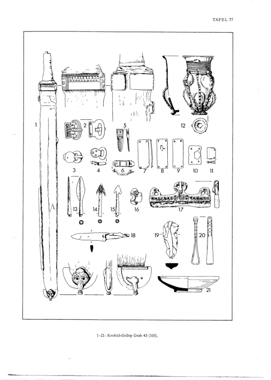

Concering the spatha from Krefeld-Gellep, I think Paul means the one from grave 43?
 Attachment: 120.09 KB
