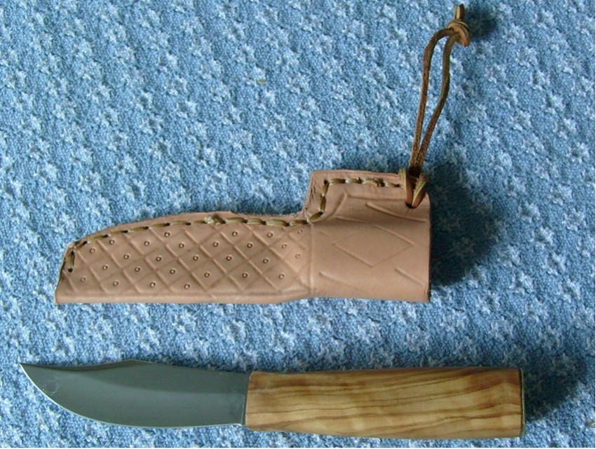

This is a small belt knife I finished, wanted something early medieval looking. Blade is under 4 inches and inset into the olive wood handle. There is a brass butt cap, and the tang is peened over. Wasn't pleased with the leather, as it was not cured all the way, and as such would not take tooling very well. But as I wanted a "commoner" knife, I think it turned out pretty well.

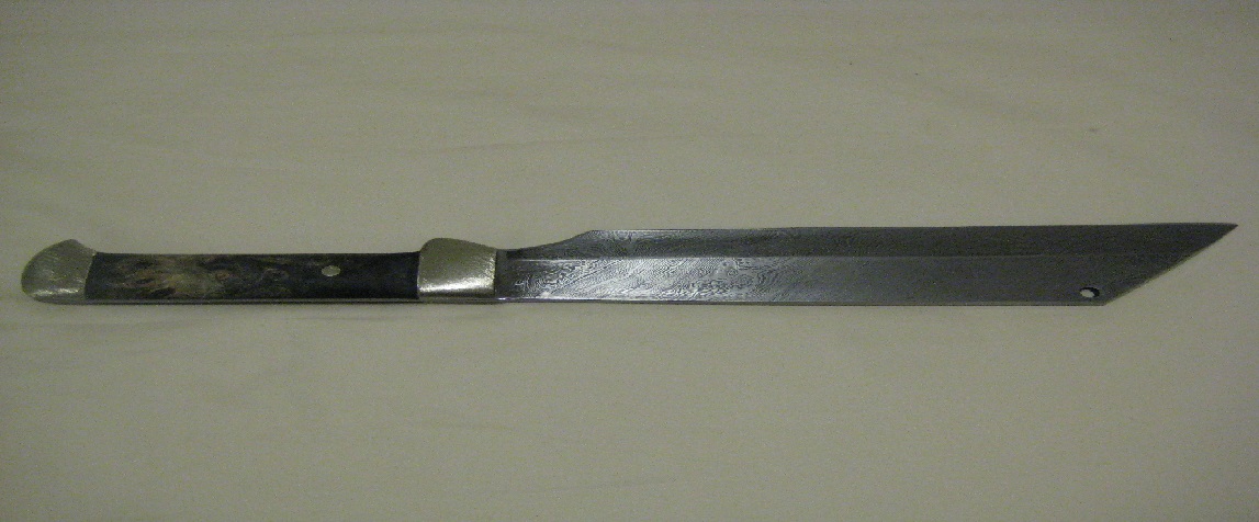

Here's a big seax I recently finished. Blade by Michael Pikula, the rest by me. Overall length 24", blade length 16.5". Width at base: 1.8". Thickness at base: 0.2", more like .25" towards the break. Width where the spine breaks: 1.7". Handle of old ash.

Your handle carving is amazing! Beautiful!!.........McM

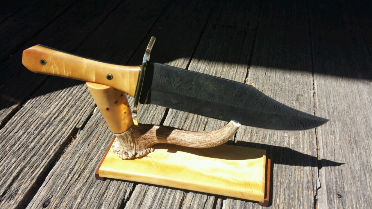

Hi all some very good projects and work in here,wonderful to see people haveing a go as they say here in oz
Anyway here is a pic of my last knife project hope you like it

That is a very nice looking bowie knife: I really like the colour of the wooden handle. what type of wood is it ?
Guesses: Tiger Maple, osage orange or pau amerello ? It could be something else, but it's really nice wood.
The blade seems to be pattern welded but the pic is a little dark on the blade.
Dimensions and other statistics might also be nice to know.

Hi well its a unique timber that only comes from here in Tasmania it's called Huon pine normally it's way to soft to use for a knife handle, but I was lucky enough to find some Huon fiddle back so it's hard enough to use yes it's Damascus steel will pin some better pics and the dimensions as well

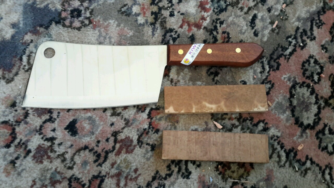

Hey all I need to have projects going on most of the time
Anyway this is a easy project and I will do it step buy step note I work in metric there are plenty of online coversion gizmos To help the Imperial people
This picture has the standard cleaver with the new handle scales

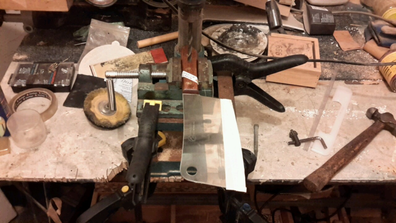

so now we have the cleaver in the drill press secured with a drill vice, clamped to the press and the table. the blade is taped with 3 or 4 layers for safety reasons, we will drill out the tops of all 3 rivets then (hopefully) punch out the 3 pins Saving the original Handle for a template

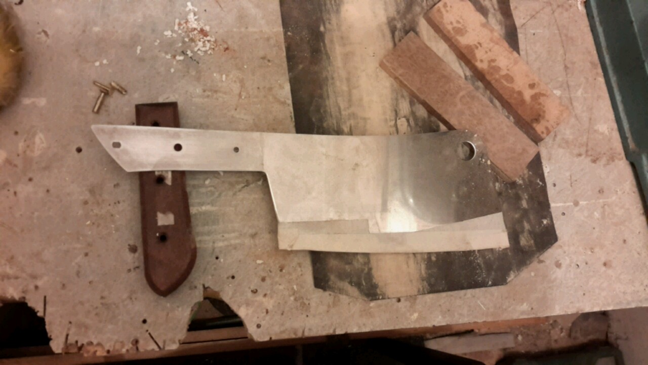

Ok so now we have the 3 rivets drilled and punched out, and the intact original Handle removed
