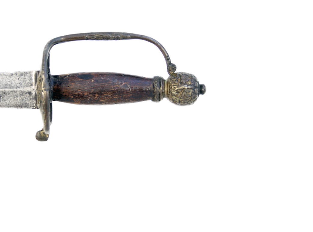

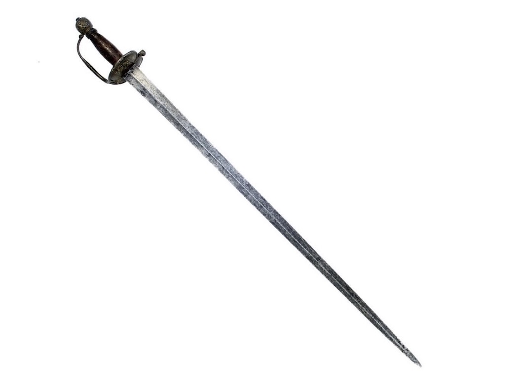

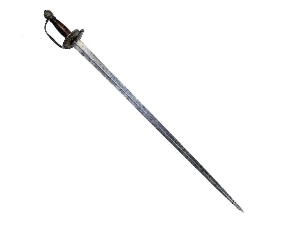

PostPosted: Wed 21 Apr, 2021 1:41 am    Post subject:         Reply with quote
Hello All,
I hope this sword is relevant to the topic.
It is English and comes from the late 17th C (so I'm told), weighs 580 grammes with a blade 29 inches long.
As such it is relatively short, light and handy. The blade is stiff and the edges are still sharp.
I was told by the dealer I bought it from a number of years ago that it was likely a 'side sword' (an almost pointlessly vague term it seems to me) made for a small person in a military context.
I am sceptical of that interpretation however (partly due to the handle length) and suspect that rather than being a smallish sword for a smallish soldier it was a smallish sword for civilian carry and use.
Where do you think it fits within the broader discussion?
Best wishes,
Adam

PostPosted: Wed 21 Apr, 2021 5:57 am    Post subject:         Reply with quote
Adam, I agree that "side sword" is not a very useful term! I think I would call it an early smallsword or spadroon, one that could thrust through buff coats and great coats and mess up hands and faces with the edge.
It looks like a Parry type 3 or Oakeshott type XV blade (I wish there was a way of saying "somewhere in the family of" in the Oakeshott typology). If you could measure the thickness of the spine every 10 cm or 20 cm, we could see if if has the 'hockey stick' distal taper of some of the long rapiers or more like a late medieval sword.

PostPosted: Wed 21 Apr, 2021 7:37 am    Post subject:         Reply with quote
Thanks Sean.
Taper metrics measured from the base of the blade to about 4cm from the tip are as follows:
Distal:
Base: 5.7mm
10cm: 4.5mm
20cm: 3.8mm
30cm: 3.7mm
40cm: 3.5mm
50cm: 3.2mm
60cm: 2.9mm
70cm: 2.1mm
Profile:
Base: 34mm
10cm: 29mm
20cm: 27mm
30cm: 25mm
40cm: 23.7mm
50cm: 21.5mm
60cm: 19.6mm
70cm: 13.5mm
While it is quite light I certainly wouldn't want to be hit with it!
