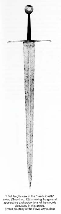

It was a privilege to study from outstanding example that now resides in the Royal Armouries in Leeds. The Principe is made as an homage to these swords and could not have been made without the knowledge gained from the documentation of the original masterpiece. |
Based on this description, it ought to look like the one below or very similar to it.

Eric McHugh and did a research trip to England a few years back. One of our stops was the Royal Armories in Leeds. Robert Woosnam-Savage was our kind and generous host. It was a very memorable visit where we got opportunity to examine and document several highly interesting swords. The XVIIIc from the Alexandria arsenal was one of them.
Several of these swords survive. They are all of a similar shape but seems to all vary a bit in size and some proportions (like grip length to blade length proportion for example) All are big swords and all are very broad. They are made according to the same concept but without an ambition for cookie cutter repetition.
The sword that resides in the Leeds collection weight some 1640 grams or 3,6 pounds. It is a little longer in the blade than the Principe and has a slightly shorter grip. Other swords are shorter than the Principe and the blade width varies. The Principe with its slightly wider blade and slightly different proportions is not intended to be a replica of the original in the Royal Armouries. It is made to fill the place of a sibling in the larger group of swords. It is in the handling characteristics and dynamic quality that the Principe will come closest to the original in the RA in Leeds. That sword is outstanding and has qualities in heft and balance that I really want to emulate in the design of the Principe.

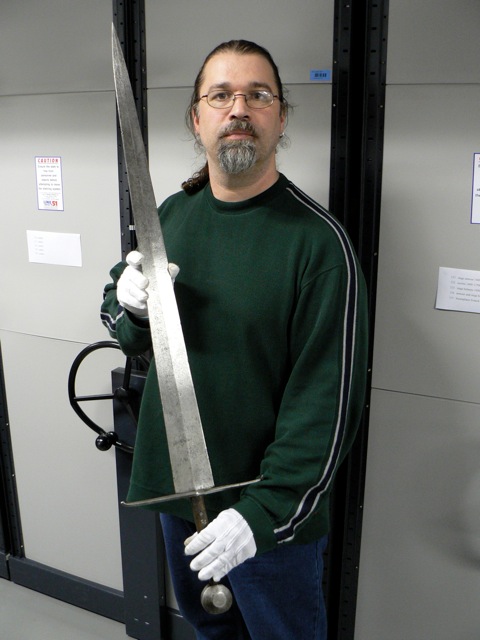

Below a snapshot of Eric. He is a big guy and yet the sword stands out as a large and broad one. It is difficult to make justice to the physical presence of these swords in a photo like this. Magnificent swords in just about any aspect. I hope you will find this sword type as interesting as I do.
