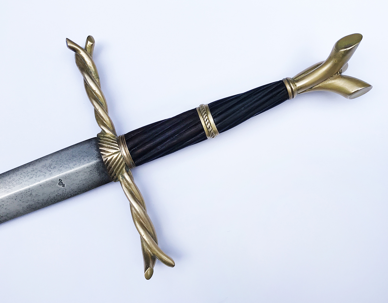

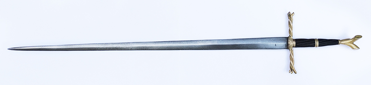

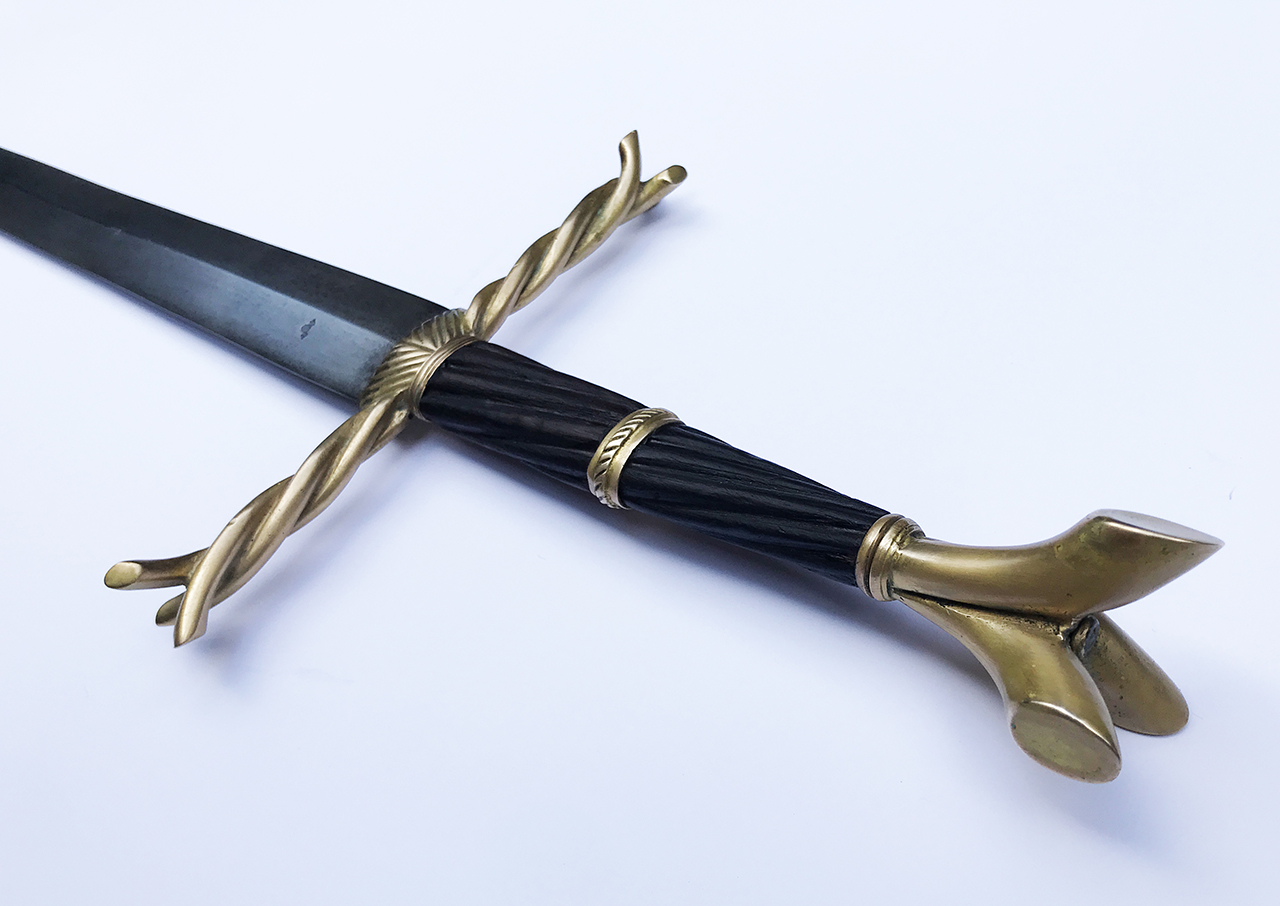

Hey, folks! I have failed to post a few recent projects here, even while enjoying seeing and reading about what others are doing. I'll start with the most recent and work backwards.
The Royal Armouries commissioned a reproduction of their famous IX.949 "writhen hilt sword". Most of you are familiar with that sword, but if not you can read about it here: https://royalarmouries.org/stories/our-collection/object-of-the-month-for-december-the-writhen-hilt-sword/?fbclid=IwAR1m4pqkhiZDUo3eL1y-12g8Lcgn4i3AlFq1umht5F81Iwjf6V94mLrjkHo
...and see stats and wonderful photos here: https://collections.royalarmouries.org/object/rac-object-104.html
The reproduction originally sold for around £175.00, which apparently didn't reflect it's position in the market–I'm guessing it was too expensive for casual collectors and museum visitors while also looking too irregular for collectors who have a machine-age expectation of handmade objects. For whatever reason, it ended up at The Knight Shop for £72 and remains there, but that's too low for this piece. Fellow MA member Julien M got one of those and tipped me to what I think is a fantastic bargain. Here's what it looks like on the shelf: https://www.theknightshop.com/royal-armouries-writhen-hilt-sword
What It Isn't: This is not going to make you happy if you're looking for Albion build quality for $92. The blade is not heat-treated and the threaded pommel and compression-style assembly seemed a bit wobbly to me. The tall brass nut locking down the pommel may have been peened. I had to cut it off to disassemble the sword. The shaping and finishing of the narrow Type XVIII blade was authentically medieval, but not in the sense most collectors appreciate–irregular polish, waviness of section and profile and some slight warping at the distal end due to the lack of heat treatment. The sword that came to me even had the slight sloping of the shoulders of the blade to fit the faux chappe that is cast in a piece with quillons. For me, all of that wonkiness is an argument in favor of this piece.
What It is: Compare the reproduction to the detailed photos of the original and find an exceptional attention to detail and scale. The cost savings are in overseas manufacture and the mild blade, NOT in the research. Tod, in his video discussion of IX.949 and his own amazing reproduction, mentions that he handled the original as part of a project for the RA. If this sword was that project, it's no wonder "the bones are good." There's even a blade marking that mimics the unidentifiable mark on the original. The reproduction's mark looks suspiciously like the RA's equally-famous horned armet. Kudos to whoever went to great lengths to get it right and communicate the information to the manufacturer, no matter what the manufacturer did with it.
Mine arrived well packed in an impressive RA-branded black and yellow box. I'm not a hoarder, but I still have that tucked away for now. I've seen the original sword up-close and was amazed that it's so small. I think we tend to oversize these objects in our imagination. This one is true to the original. As I examined the piece, the only aesthetic complaint I could find in comparison to the original is that the section of the grip elements seems to be very slightly smaller than that of the original. Some might also object to the superior casting and finish of the reproduction's furniture. How's that for nitpicking?
I don't love the plastic look of highly polished brass, but I recognize that the original was gilded and all about high-status bling. I thought I would give this thing an appropriate scabbard and suspension, but when I finished stripping and rebuilding the hilt and started on the scabbard core, I suddenly realized that this would be too much finery for my tastes. I want IX.949 as it exists now, naked and scarred and full of stories.
So, I returned to the full range of antiquing techniques I described in an article for this site many years ago: http://myArmoury.com/feature_antique.html
I had somewhat disavowed that kind of work in the decade+ since, but I have used aspects of it on some knife projects recently. Once I got into this sword project I recalled what fun it is to bash a good reproduction with various tools, mash it against the floor, fume the brass and spoil the blade (after a simple and effective polish) with misused cold blueing solution and a homemade solution of salt and vinegar. I didn't take this quite as far as the original, and there's no good way to match the pattern of wear and corrosion of the gilded original furniture. But this project has far more character than what came out of the box. For $90 and shipping, I'm more than pleased.
By the way, I tried the reproduction hilt on a Hanwei-Tinker bastard sword blade. It'll work if you slope the shoulders of the blade slightly, getting even closer to the look of the original. I'm sure there would be other fitting to be done to make the switch, but it could be done if the mild blade bothers you. Just be aware that the HT blade is heavier, and there isn't much in the way of pommel as counterweight, so you might not like the feel of that sword.
