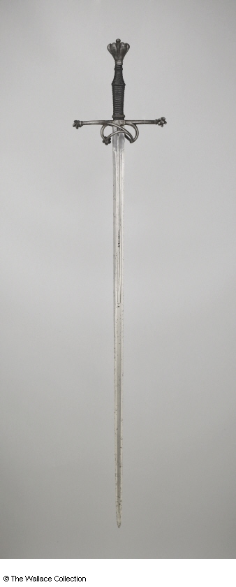

Here are a few more late bastards - photos from the Wallace Collection. I really like A492.
Edited to add - the published weight of 3.13 kg for A491 (almost 7 lbs.) must be wrong. It can't be that heavy.

A482 - c. 1525 - length 99.8cm - 2.17kg
Attachment: 43.4 KB
A491 - c. 1615 - length 95.4cm - 3.13kg
Attachment: 32.67 KB
A492 - c. 1530 - length 103cm - 1.3kg
Posted: Thu 09 Feb, 2012 1:08 pm Post subject: |
Roger Hooper wrote: | Here are a few more late bastards - photos from the Wallace Collection. I really like A492. |
I also like the A492 sword as well! I'd like to see a replica made of it. It's fantastic.
Longsword
Unknown Artist / Maker
Germany
c. 1530 - c. 1540 (pommel and guards (German))
probably late 16th century (blade)
Iron or steel, rope and leather, blackened
Length: 103.5 cm
Length: 17.5 cm, grip
Width: 2.8 cm
Weight: 1.3 kg
Inscription: 'SIGNOR' with a cross on both sides
A492
European Armoury I
Attachment: 51.39 KB
Longsword, A492 Copyright © The Wallace Collection [ Download ]
Roger Hooper
Posted: Thu 09 Feb, 2012 1:37 pm Post subject: |
Nathan Robinson wrote: |
I wonder where one can find more photos of the A492? - close-ups of the hilt, and a view of the other side. Perhaps the new Wallace Collection book + USB has multiple pictures of it.
