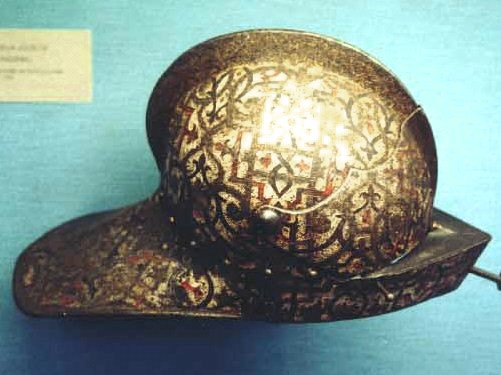

Posts: 323 Location: Telemark, Norway
Sun 06 Apr, 2008 2:55 am
Corey,
The original sallet that you show, is in fact enamelled. The armourer Kunz Löchner of Nüremberg made a number of armours, for both man and horse, with this elaborate decorative treatment on. Great view of the helmet though ! :)
Painted armour is something that we see all too seldom these days, and it is nice to see some people going to such great lengths to achieve the proper effect.

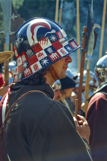

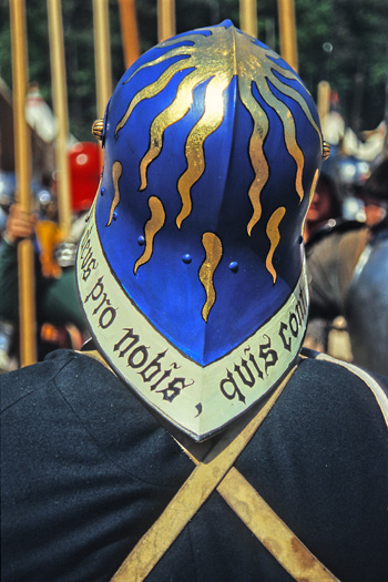

Here's my personal favorite example of a modern painted sallet:
Attachment: 130.77 KB
Posts: 5,981 Location: Birmingham, Alabama
Fri 21 Nov, 2008 10:53 am
By the way, when I was thinking about doing something like this I Googled "free medieval fonts" and came up with some nice gothic German fonts. You just download, key-in your text, change the font, adjust the size to suit your border and print. You can either just copy by eye or outline the letters with pinpricks, tape the page to helmet and spraypaint in a color slightly lighter than the background. When dry, you can remove the paper and play connect-the-dots to finish the border, covering the guide dots.
