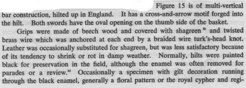

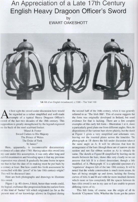

The article to which Eljay referred , Mac
The Nineteenth Park Lane Arms Fair, 2002, copyright D.A. Oliver
 Attachment: 88.5 KB
 Attachment: 101.5 KB

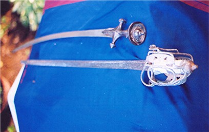

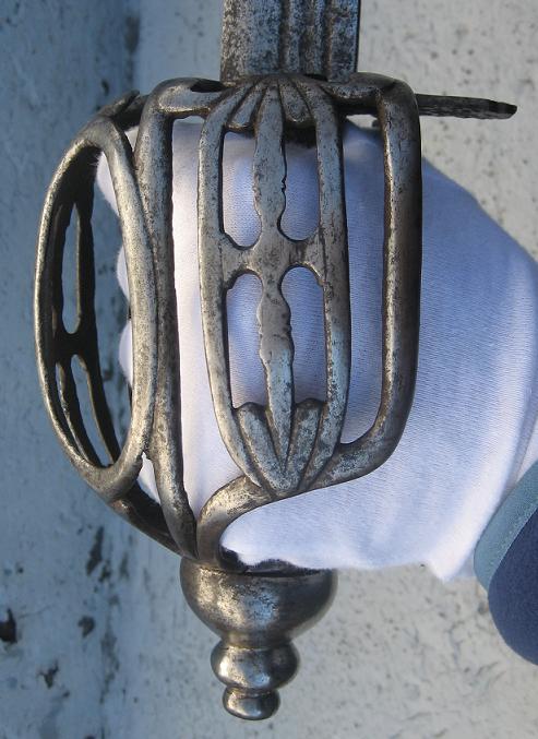

Here's a pic of a Horseman's basket c1750, that belongs to a friend. The oval ring on this is a bit hard
to make out, but it's the best pic I have of it. This is the one I told you about that's hanging in my workshop now. Some igit painted the basket with silver paint, so I'm trying to gently remove it and restore/preserve it the best I can.
Bill

ElJay and Mac, that is a very interesting article--thank you for sharing. I look forward to re-examining my basket hilt with an "unconditioned" eye (although the approximate date of ca.1750 probably won't change). I bought it from a well-known dealer in London, and it was (if I remember correctly) described as being ca.1780-1790. That date sis certainly possible, but all of the examples I have come across have been dates to ca.1750. I have always had the suspicion that the blade is older, mostly because of the faint king's head mark (and there is also just something about the blade).
Bill, I hope you can share some pics of the horseman's basket hilt post restoration/preservation. It looks like it should clean up nicely! (And perhaps it would be a good advertisement for your services?)

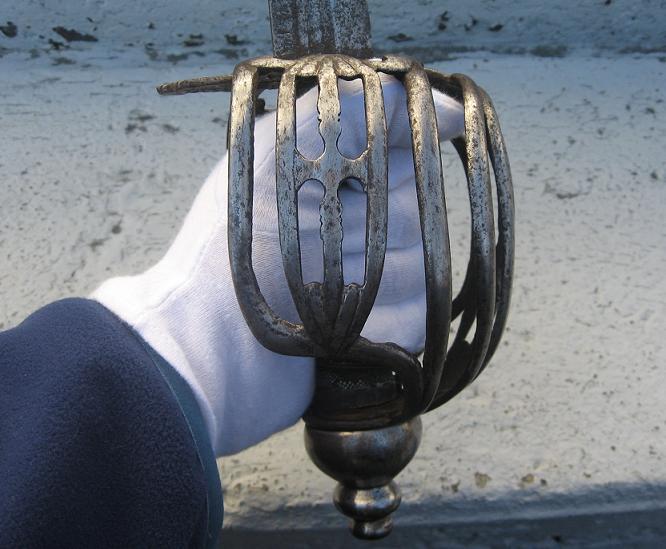

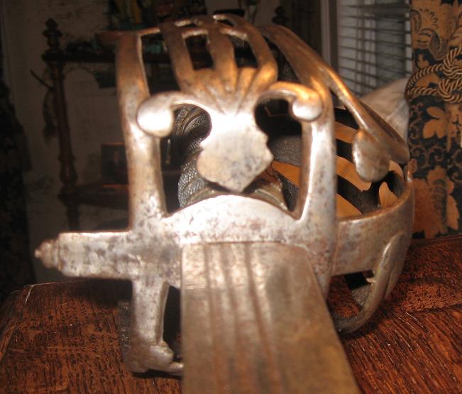

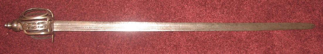

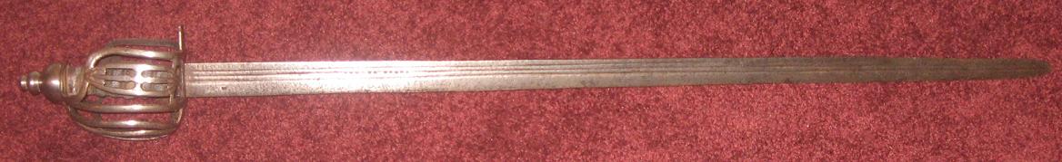

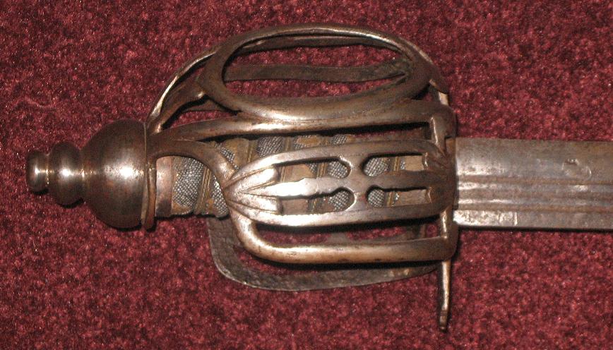

While visiting my parents for the holidays, I spent some time with the swords that still reside at my childhood home. I took some time to photograph a few of my better swords. One of these is the basket hilt that inspired this thread. I thought I would share some photos along with some detailed statistics. (Be sure to click on the links to view all of the photos I have attached.)
Blade:
34 ½” long
1 3/8” wide at the shoulder
7 ¼” false edge
Fullers:
1/8” wide (each)
Two fullers run the entire length of the blade
One fuller measures approximately 17 ¼”
Tang:
13/16” wide at the shoulder, peened at the pommel
Hilt:
6 ¼” long
Basket:
4 ½” long
4 ¼” wide
3” deep (not including quillon)
Bars are between 3/16” and ¼” wide and are approximately 1/8” thick
Reins Ring:
2 ¾” long
1 9/16” wide
Quillon:
1”
Pommel:
1 ¾” long
1 9/16” wide at base
1” wide at center
5/8” wide at terminus
Grip:
4 3/16” long
Weight:
2 lbs. 7 oz.
CoP:
Approximately 23 ½” from hilt
PoB:
Approximately 4 ½” from hilt

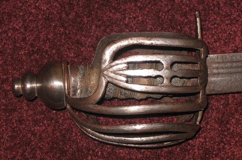

 Attachment: 92.71 KB
Close-up of basket including oval reins ring.
 Attachment: 93.98 KB
Close-up of inside of basket and grip.
 Attachment: 49.91 KB
Close-up of basket--view from the blade.

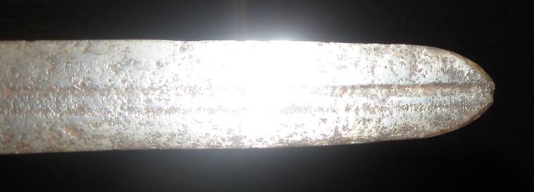

 Attachment: 24.36 KB
Close-up of blade point.
 Attachment: 44.15 KB
Overall view. [ Download ]
 Attachment: 40.95 KB
 Attachment: 89.36 KB
Close-up of basket. [ Download ]
 Attachment: 114.1 KB
Last edited by Jonathan Hopkins on Mon 01 Jan, 2007 9:24 pm; edited 1 time in total

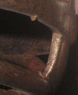

Here are a few more photos including a close up of the ANDREA FARARA marking, a king's head mark, and damage to the basket that appears to have been caused by a blade trying to penetrate an opening. Basket-cases, enjoy!
Jonathan
 Attachment: 66.93 KB
Close-up of fullers and ANDREA FARARA marking.
 Attachment: 4.38 KB
Close-up of king's head mark.
 Attachment: 9.13 KB
Close-up of possible battle damage to the basket

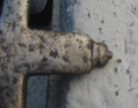

PostPosted: Wed 03 Jan, 2007 4:03 am    Post subject:         Reply with quote
Hi Jonahan
Thanks for sharing the details on this nice piece of yours (excellent photos, too).
Is the overall length, including pommel, 40-3/4" inches ?
Interesting how the wrist guard terminates ... does it appear a piece is missing, or is that its design ?
Also the blades tip, with fuller running out, looks to have been shortened/reground ?
Happy New Year, Mac
XX ANDRIA XX FARARA XX
Mac's PictureTrail
Jonathan Hopkins
PostPosted: Wed 03 Jan, 2007 7:05 am    Post subject:         Reply with quote
Thanks, Mac.
Yes, the overall length is 40 3/4" including the pommel. The blade appears to have been sharpened and resharpened many times, including the tip. I would guess that the blade was either shortened through repeated sharpening or that it was perhaps shortened deliberately. The third fuller ends where the false edge begins.
The quillon is strange. It looks incomplete, but if it is really broken then the break was pretty clean and probably happened during the sword's service life. I brought this sword back to VT with me, so when the back steps are dry I'll go outside and get some better photos that do not feature a reflection of my camera's flash!
Jonathan

The weather in VT is great today, so I snapped a few more photos. First up is a mediocre shot of the quillon to help answer Mac's question. The other photos are the obligatory sword in hand shots (which demonstrate the close fit of the basket around the hand), as well as a shot of the inside of the basket.
Jonathan
 Attachment: 20.18 KB
Quillon
 Attachment: 53.27 KB
Sword in hand
 Attachment: 47.98 KB
Sword in hand
 Attachment: 55.37 KB
Sword in hand
 Attachment: 56.29 KB
Grip and inside of basket
