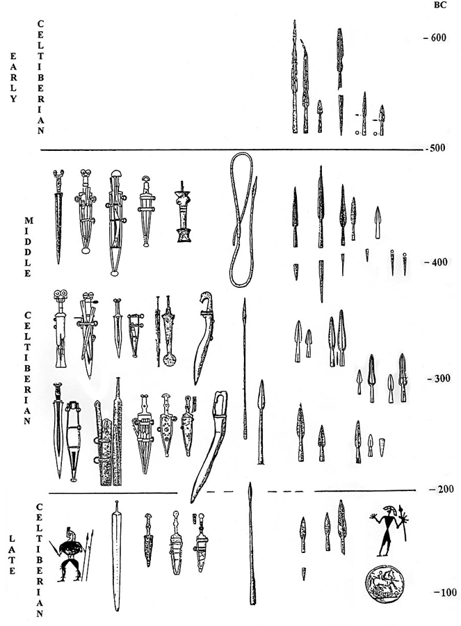

Attached image is from Journal of Interdisciplinary Celtic Studies, volume 6, "War and Society in the CeltIberian World", Martin Gorbea and Alberto Lorrio. It shows the time frame of the Hispanic-Iberian long form of leaf blade to the West as being around 300 to 200 B.C.
Attachment: 147.1 KB
Leaf blades are LONG gone by the Migration era. In Western Europe they are mostly on their way out when the Iron Age starts, though Spain hung on a while longer. As mentioned, the Mainz style Roman gladius was in use into the first century AD, but I'm not sure if that is really considered a leaf shape. But it disappears well before the Migration era starts.
