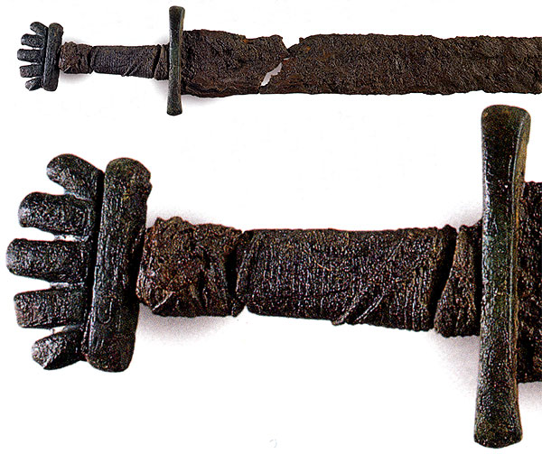

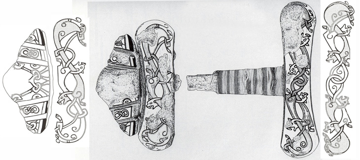

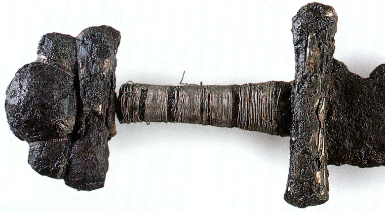

While browsing the shelves of "Half Price Books" I found an interesting survey book on the Vikings. It is entitled "Vikings: The North Atlantic Saga" ed. William Fitzhugh and Elisabeth Ward. (Forward by Hillary Rodham Clinton Eek! )
There were a few interesting pictures of Viking swords... a couple I had never seen with wire grips still in place. This got me to thinking that the Viking Sagas mention swords being bound in silver. I envision the grips being bound with silver wire. However I have seen very few Viking swords with wire grips. However the non-ferrous wire should be preserved even if the wooden core has rotted away. The fact that a few swords have the wire wrapped tightly around the bare tang suggests that the loose wire may have been found with the sword and was simply coiled around the tang by the person who found the sword. I wonder how many Viking swords were found with the wire and the time was not taken to preserve the wire with the sword. I am also suprised by how many Viking swords in Ian Peirce's "Swords of the Viking Age" have the twisted wire decoration on the pommel missing. Another observation is that it seems that the pommel wire is either all there or it is all missing. This suggests to me that maybe, on some swords, the wire was removed before the sword was buried or sacrificed to the lake or bog. If so the wire of the grip may have been taken also. So there may have been many more Viking swords "bound in silver" then what we see in collections today.
Another observation is that the wire binding on the type S sword seems to be twisted at intervals so that when wrapped around the grip it produces alternating twisted and untwisted sections. Thinking about how the pattern welded blades were made, you see a similar twisted and untwisted section of the rods which also produces alternation straight and pattern portions of the blade. See and example here:

If the wire on a swords pommel assembly is missing it's more than likely due to the method of construction than from any intentional act. These wire decorations were not soldered or otherwise permanently affixed. They were pressed into place and held firm by a friction fit. They may have fallen out during use in the swords lifetime, or possibly could have come loose due to the deterioration of the hilts surface. There's absolutely no evidence to support the theory that they were intentionally removed.
As for swords with the wire wrapped around the bare tang: I highly suspect that this was either done by the person who found the sword during excavation, or by a museum employee who decided it looked better that way, or by a victorian era collector who decided to dress up his antique. In the latter two cases the wire may not even be indigenous to the sword.

There are enough swords with silver wire wrap surviving that we can know some about this. The interesting hint it gives us is that at the later viking age it seems to be fairly common with very slim grips on some hilt types. In some cases the wire has been rewrapped or at least re-wound around the tang at restoration, but enough survive intact for us to see that there was not that much material between the tang and the wire; only very thin slats of wood (usually four, one on each side of the tang, sometimes two slats in a sandwich construction).
There are swords with surviving grips not bound in wire that are also very thin, or narrow, so this shows a trend. To my mind it seems to be more common towards the 11th C. Earlier on grips were wider but flat instead. I must ask for some caution with this observation, because it is based on a small number of surviving sword grips. There is a trend though, I think.
Some of the illustrations Kirk has posted shows very clearly how grips could have looked with alternating twisted and untwisted portions. The same effect you see on some well preserved knife grips that often can have a "ferrule" towards the blade made up from twisted wire, looking exactly like this (Wire bound around a section of the wooden grip, sometimes the wood beneath the wire is grooved to create a textured surface of the wire bind, much like some 16th & 17th C rapier grips).
When the texts talk about a hilt wrapped in silver we could well believe it is exactly that. Sometimes the term is more uncertain, like silvered or silver encased. In those cases it could be a hilt with furniture embelished with silver with or without a silver wire wrapped grip.

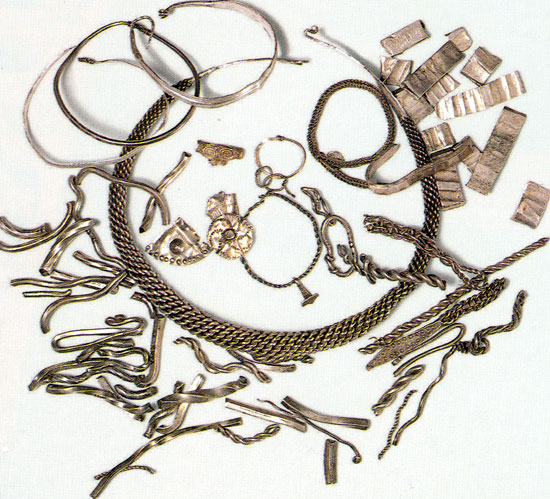

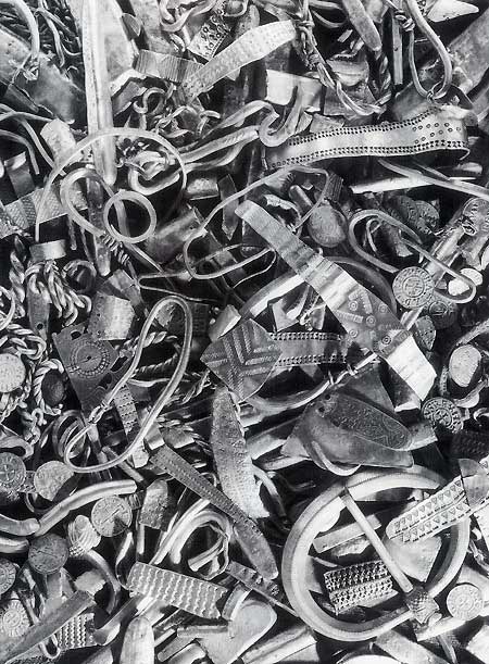

The first is the weakest and is based upon the Viking economy. The warlord was often called the "breaker of rings" because he had his silver and gold war plunder made into rings and would break off pieces and give to who he wanted. It was almost like a form of currency and he was Mr. Greenspan Big Grin As such, when the sword was placed in the burial it might be in character to break or remove the removable parts as a form of payment of some kind.
The second argument has to do with why only that strand of wire would be valuable... It would be easy to remove and easy to melt down and used in a larger object. (plus the warlord got to keep the fighting part of the sword for the after life). It would be harder to melt the sword just to get the other silver inlayed and plated on the surface, however the wire was much easier to pry out or unwrap.
In any case, the few pictures of hacksilver hoards I have seen do contain little tiny pieces of twisted wire. This would be evidence that they did consider little tiny pieces of silver wire to be worth hoarding.
This long post (thanks for reading) all began with the ideas that there is no evidence to refute my theory... Strangely enough there is... As a matter of fact I posted three pictures of it in the thread starter. All three of the sword hilts have the wire removed from the pommel yet still retain all or much of the silver wire around the grip. Why would they take the wire in the pommel and not on the grip... Now that certainly refutes my theory, doesn't it Eek! WTF?! Sad Cry Mad Evil Wink
