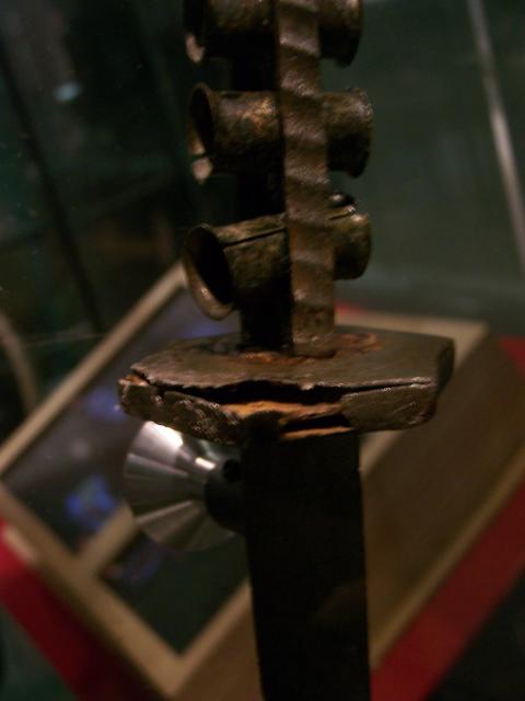

And Matt Easton made this photo of a dagger in the Museum of London. Note the open seam of the rivets and the flared lips, which are not really peened flat. Rather, they appear to have simply been flared out by the same method described in the link above. So maybe the holes in the scales should have slight, conical countersinks rather than flat countersinks.
 Attachment: 22.23 KB

PostPosted: Wed 28 Nov, 2007 9:26 am    Post subject:         Reply with quote
You know I looked at that knife and even have 3 images of it on my site and I didn't realize until now that those were large hollow rivets.

PostPosted: Wed 28 Nov, 2007 10:51 am    Post subject:         Reply with quote
I think the epiphany for me as far as the hollow rivets are concerned is that what looks like thick-walled tubing may actually be thin-walled tubing with a lip/peen. That makes things much easier, and should give a neater finished appearance.

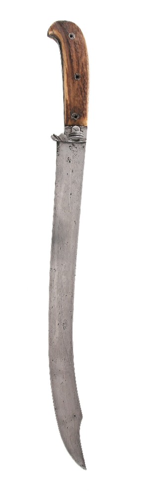

Hi Sean,
Not sure if it helps but I found this photo. It's not exactly medieval (circa 1650 apparently) but it looks like what you are after and was described by the auction house as a german hunting knife.
Darren.
