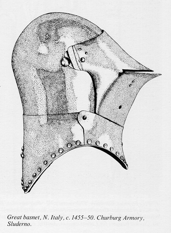

I think it's a reference to this type of helmet:
 Attachment: 122.11 KB
(Picture scanned from "The Complete Encyclopedia of Arms and Weapons", edited by Leonid Tarassuk and Claude Blair.)

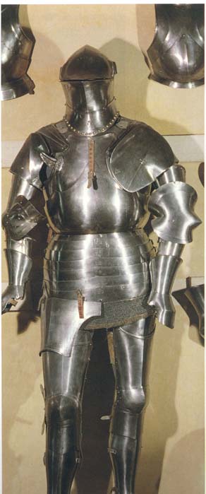

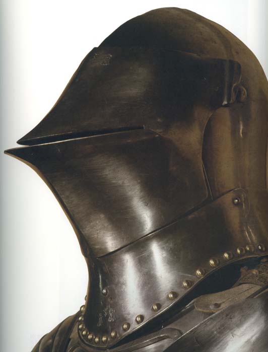

Here are two more pics of the Churburg great bascinet.
 Attachment: 36.72 KB
 Attachment: 35.74 KB
