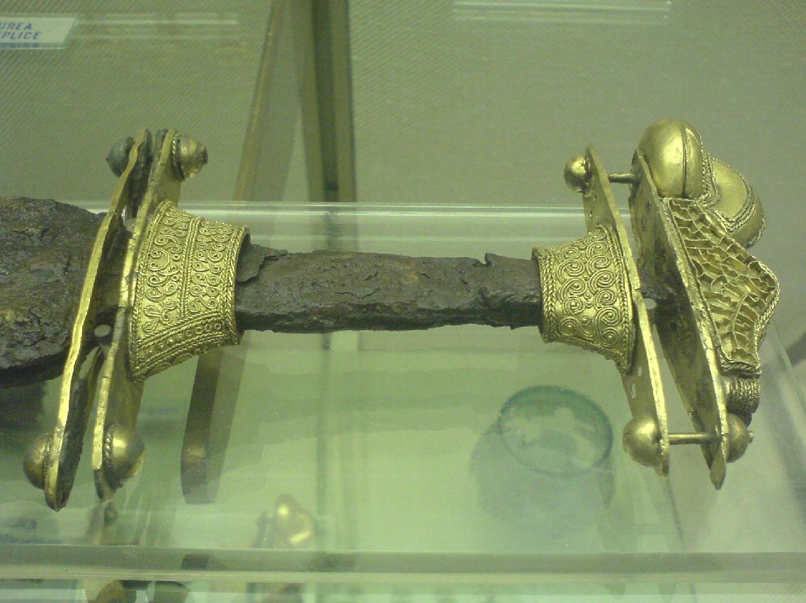

The first thing i'd like to share with you is an amazing sword from the migration period. It was found in the necropoly of Nocera Umbra (200km from Roma), a "cemetery" developed between 570 and 640 AD.
The hilt is unbelivable, entirely made in gold and finely decoreted, is one of the most beatiful thing i've ever seen. The upper guard is affixed to the tang and the pommel is riveted to the upper guard in a sort of "Petersen type R" ante litteram.
I try to mesure the sword but was hard with the the protecion-glass, i think it's under 90cm all.
Here a photo that count more than one thousand words.

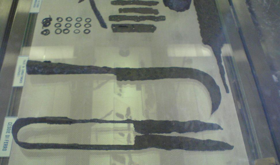

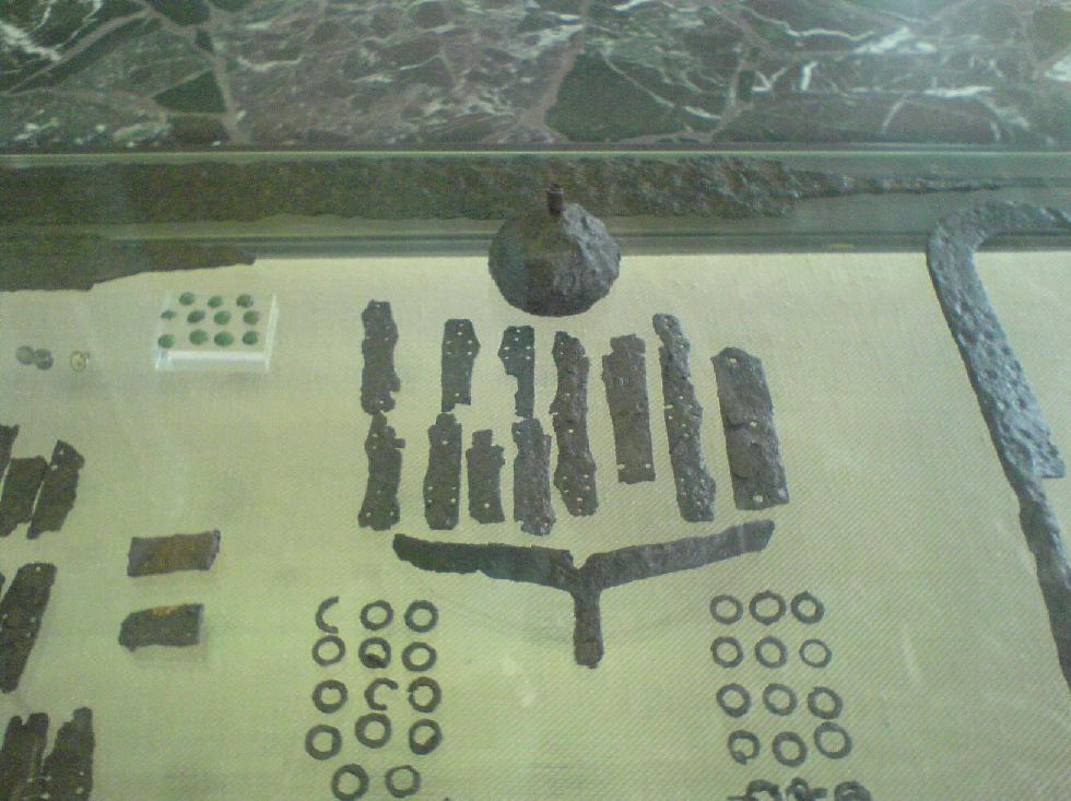

In that museum, that is half mile from home, there is another sword like that, with a different hilt, other simply sword (all very close to spatha), a dozen of sax and a particular weapon, one harpago (a sort of sickle mounted on a staff), and a lot of spear points (seveal are very fine manufactured).
Maybe the best thing of the museum is the "funeral corredo" (all the thing put in the tomb with the corpse) of tomb 119 from Castel Tirosino. It his the most complete longbard corredo ever found in Europe. This Longobard was probably an high ranked official and was buried with a complete lamellar armor and a wonderful lamellar elm with a rigid forehead and nose protection. The stripes of metal were fixed to this rigid piece at the bottom and fixed to a round element in the upper part. A sax, a sword, a spear and an harpago complete his offensive equipment. For defense he had also a round shield. The fornitures and decorations found demostrates a Byzantine influence in longbard art. Very close to the Esarcato and to the Adriatic Sea, the centre-Italy longbard showed soon the most incredible mix of pure roman, byzantine and barbaric traditions.

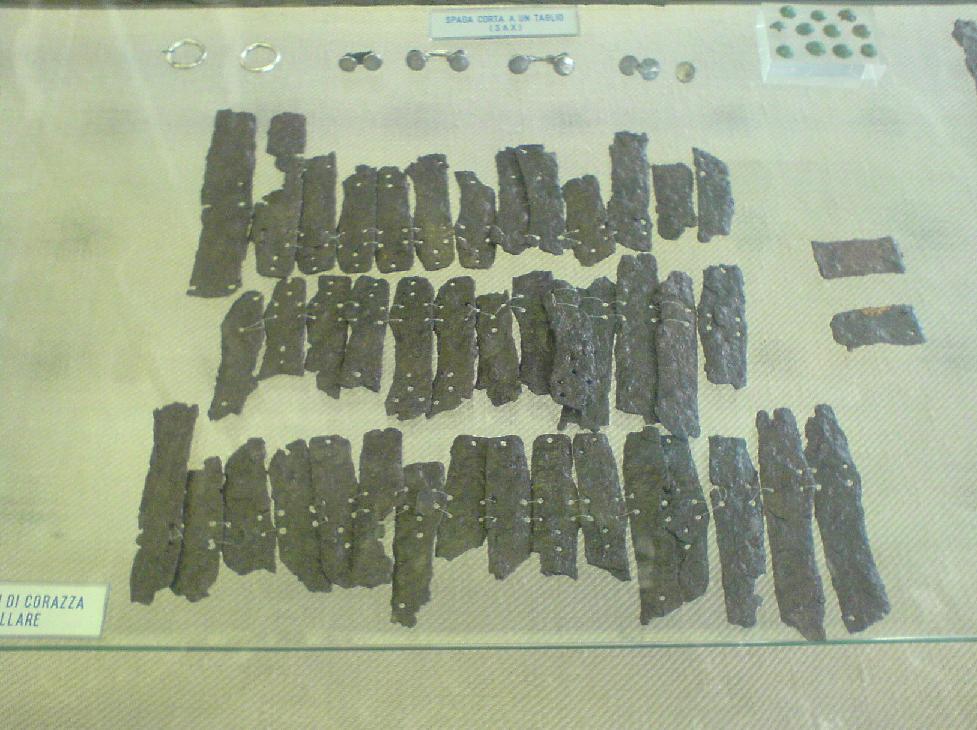

the lamellar elm [ Download ]
 Attachment: 105.82 KB
lamellar armor [ Download ]

the "harpago" [ Download ]

PostPosted: Wed 11 Apr, 2007 10:44 am    Post subject: inlay?         Reply with quote
Hi Gabriele
On the pommel on the sword in your first post, is there any suggestion of glass or similar inlay in the spaces in the net pattern on the pommel face?

Good question. I ask myself the same thing when i saw the pommel. I think it is a possibility. Infact if you draw an imaginary line in the middle of pommel's face you have 2 simmetrical parts. Maybe there was a pattern made by small pieces of coloured glass (considering the byzantine influence).
On the other hand a simple geometrical design, without inlaids, reduces the weight of the pommel and it's high decorative too. Moreover we have several exemples of bizantine inlaids with glass, and all of theose came till present days intact, so it's strange that none a single piece of glass was in the pommel.
A good point. I wonder if organic inlays were ever used in place of glass or garnet - maybe a dark wood or a patterned horn or something that disappeared in the same way that the spacers between the metal plates on the upper and lower guards disappeared.
Geoff
Beat me to it, was wondering if at one time it might have looked something like the Sutton Hoo pommell...
I think it's a realistic ipotesis....
