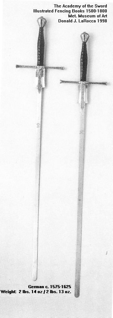

I have a question, however: Why the fuller? We have extant Paratschwert (training swords) from this period at the Met (see attached picture) and they have no fullers, nor do any of those portrayed in any of the Fechtbücher that I have seen show fullers.
I understand that Albion is using the fullers to balance the swords, of course, just as they did with their Liechtenauer training sword, but I don't get why they had to use a modern approach (yes, I know fullers are medieval but they don't appear to have been used on these kinds of swords--if I'm mistaken then please accept my sincere apologies for this post) when a medieval approach is available.
I felt the same sort of disappointment about the Liechtenauer when it came out: Here we had a medieval problem--how to make a (relatively) safe sword for practice. You have to thicken the edge for safety but that ruins the balance, so you have to come up with a way to adjust the balance of the weapon and also add some flex to the blade for thrusting. There are a number of potential solutions from exotic materials (tungsten perhaps) to geometry (as they did with the Liechtenauer), but to my mind the best solution would have been to study what medieval men did to solve the problem (since for once we actually know) and then apply that solution. If we're practicing a medieval art shouldn't we look for medieval solutions to the problems they faced wherever possible?
I have been eagerly looking forward to the Meyer for some time now since I really do consider Albion's swords to be the best out there, but after seeing these pictures I think I will regretfully have to stick with Arms and Armor's Fechtespiel which, while not as well made as some of the swords I've seen from Albion, is still very, very good and is more true to the art I practice.
 Attachment: 115.55 KB
Training Swords at the Met [ Download ]

PostPosted: Mon 02 Apr, 2007 6:12 pm    Post subject:         Reply with quote
I guess it depends on the goal: Making a safe training sword with the handling as close as possible to a sharp sword or to make a reproduction of a period training sword ?
In period there may have been much less concern about accidental wounds and fewer liability lawyers. Wink Laughing Out Loud
In part training with a blunt that can hurt you badly but not as badly as a sharp might have in period been considered part of learning to deal with fear, pain and injury in a realistic manner ? Having to face real swords in real life would change ones perception about how safe a training tool should be, and a higher level of risk and skill in handling a training sword would have been the norm and even preferable ?

I have Arms and Armor's Fechterspiel. I don't see how it's any less safe in spite of being a very close replica of the real things. Weight, size, all are very similar to Albion's Meyer. I do not believe safety is an issue here.

The Meyer is built and designed mimic the heft and behaviour of sharp longswords, just like the historical federswords were made to funciton as swords while remaining relatively safe to use.
If you look closely through the many historical images depicting these training swords you will se that there is quite some variation to the cross section hinted by lines and shadows. It seems that both midribds (hollow ground edge bevels on each side?) and fullers were introduced in the making of these training swords. There are only very few of these remaining as actual specimen in museums: they will not show a representation of the full spectrum of the shape of these swords originally could have. There are limits to what you can do with a rectangular cross section and still remain safe according to modern standards. To bring the blade to where I wanted it in handling I needed to base the design on measurements of actual sharp swords while basing the design of the shape on represetnations in art for the visual shape.
I have seen and handled "safe" blunt single hand training blades that would easily have lacerated the opponent (even if not cutting deep or severing bone) Perhaps even the capability of sometimes causing a superficial wound was actually the intention: bouting to first blood? A thin section like that (*not* a safe 2mm edge, rather 0,5 mm!) will also allow you to get a handling that is very close to that of a sharp sword. This is not a feasible design solution for modern practitioners however, even if it is realistic and historically accurate.
When I designed the Meyer I made the blade so it could behave very closely to sharp long swords of the same general size and wight. To do this and also have a safe edge you need to use fullers to remove "dead meat" from the middle of the blade. A fuller will also increase flexibility somewhat, compared to the same cross section without a fuller. In this case this is a good thing.
I still wanted a reasonable stiffness in the forte, to avoid an overly wobbly blade. The idea is that you should be able to preform techniques involving blade contact without the training swords bouncing away from each other: this will be harmful for a development of good technique. The flexibility is such that you can train thrusts if you have adequate protective gear. I would not suggest full force thrusts: those will bruise and could possibly crack ribs, but a controlled thrust against stiff padding should be possible. Thusting is always dangerous, so caution always needs to be observed when training these techniques.
The Meyer is more flexible than the Liechtenauer. It is not meant to be so flexible that the thrust is favoured on expense on its behaviour in other types of sword play. You can make it more flexible, but the price is a blade that wobbles and bounces in parries and deflections.
The Meyer have the same size and radius in the point as the Liechtenauer, but it might look broader since the whole blade is slimmer.
The Meyer have an increased edge thickness towards the base, reaching a maximum of some 5 mm just in front of the ricasso. Towards the point the edge thickness decreases to 2 mm. The blunt edge is rounded, naturally.
The cross section can be likened to an H-beam with rounded hollows. It is indeed a way to retain the same mass at any given point as that a sharp blade of the same weight would have.
The Liechtenauer has a constant 2 mm edge thickness, but benefits form the same cross section.
In weight the Meyer is very close to the Munich.
It could be compared in handling to lighter long swords in the NG line, but is not meant to precicely duplicate any specific sword. In handling it compares pretty closely to the Count, Steward, and the coming Hauptmann and Markgraf. Possibly also the Crecy.
The Meyer is quicker and more nimble than the Liechtenauer. It is also more flexible.
The swords in the Maestro Line are built and finished in a different way than Next generation swords, therefore it is not possible to make comparisons in amount of detailing and complexity. There are different factors that add up to work hours in the two lines because of different finishing techniques. Quite a bit of thought has gone into developing a design and manufacture that allows defined and developed blade shapes and detailed hilts to be offered at a low cost. Safety, realistic handling and structural integrity has been the first three priorities in the development of these swords.
