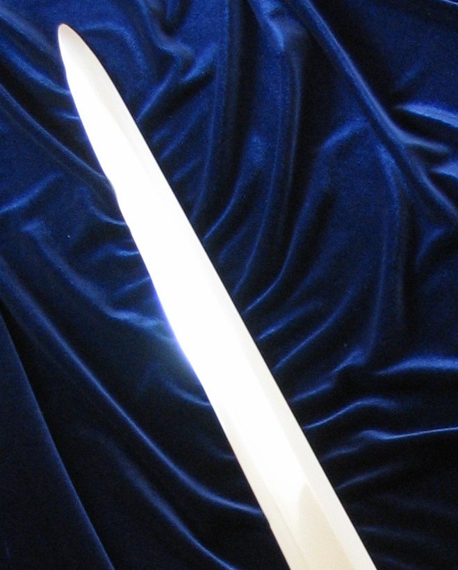

Perhaps some different shots of the tip/last 3rd of the blade.
Joe,i have clipped one of the larger pics to give some idea,hope this helps a bit.
 Attachment: 106.56 KB
