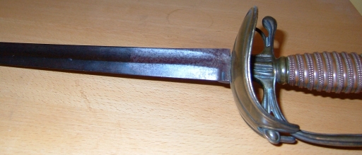

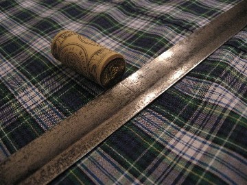

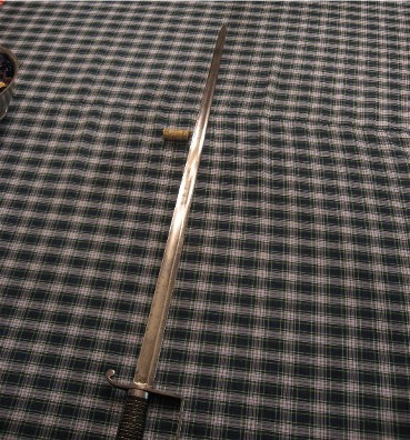

Hello friends.
I recently purchased an antique sword. Age is about 200 years. The sword seems to be in very good condition, except for one major problem. Before I get into that, PLEASE NOTE that I don’t want to discuss the sale itself, how it happened or who the seller is. I will state that the seller has thus far been very responsive. He has offered to refund my purchase in full. Alternatively, when I brought up the possibility of a repair, he offered to pay for that and discount the sword, if I wish to try that.
The problem is this - the sword has a crack in the blade. :cry: The crack is located approximately 18 inches from the cross / 14 inches from the tip. It is a through crack, i.e., through the entire thickness of the blade, and perpendicular to the length of the blade. The crack is about 13/16 inch long, thus running from the blade back, about 1/2 way to the blade edge, so this is a significant crack. I have attached some photos, below. (The crack is located next to the cork)
My questions for my fellow forumites are as follow:
1. Can such a crack be repaired? If so, how should such a repair be done? What are the risks and any special precautions that should be taken?
2. Even if the crack can be repaired, should such a repair be attempted? Why? Why not?
Why am I asking? Other than the crack, I really like the sword.

I would accept the person's offer for a partial refund. If the sword was damaged in transit, insurance will take care of it. I would not fix the crack. It does not detract from the appearance, but a repair would be much more noticable. Cracks and imperfections are expected in antique weapons and collectors usually tolerate such damage, as long as the weapon is not in danger of falling apart. As long as you treat it with caution and dont attempt to swing the weapon, you should be fine.

Hi Steve,
My sympathy on what may end up being a tough choice. Only you can say whether it is the one you can live without. Also between you and the seller would be an adjustment, repair or no.
There are some real whizzes out there and welding technology is such that it could be welded pretty easily. If it were a piece headed for complete restoration, it might be worth it. The thing is that there is no real way to do it cleanly without a great difference in appearance. It could also be brazed with a hard silver solder. Dismounted and headed for complete refinishing, there are some forging options but is it really a sword to spend that much on.
Appearance is the only real downside to a weld or braze. It is not something you mean to use in striking, or other real use. That is probably a good argument for not repairing it, if the main purpose is appreciation. It survived in its current state for some time (looks like to me) and would probably still outlive us all with due respect in handling.
I'm sure some others will probably have good thoughts on this. I have seen blades that have been repaired, so there is the option. It just becomes a matter of justification. I don't have a good suggestion on who to approach. I do know a pretty techy welder but couldn't warrant an outcome (if he were interested). There are sword restorers around.
Cheers and best of luck with a happy outcome

I would tend to agree with Don on this. Any repair will involve heat and that heat is of a temperature that will screw with the temper of the blade before you even tackle the esthetics issues that will arise. I've cleaned a fair number of welds in my time to be "seamless" but it takes alot of time and coupled with the temper issue I would say leave it alone if you opt to keep it. I wouldn't fault you at all for taking him up on the discount if you opt to hold onto it as you paid a very respectable dollar for this one based on it not having this flaw or for that matter asking for your cash back if your so inclined but I wouldn't try to restore it.

My personal preference, if the sword was mine, would be to ask for a price reduction and keep it as is. It is a really beautiful example of a stirrup-hilted spadroon, and who knows, maybe the damage is period? The soldering fixes I have seen are quite visible and turn me off to a sword. In most cases (that I have seen), this type of fix is the result of a complete break in a blade. Whether or not it should be attempted is a personal decision and will depend on one's goals as a collector. Once again, if I was in this situation, I would ask myself how a fix would contribute to or enhance the sword. For me, a fix would not add anything becuase I would not be swinging the sword or using it to cut, etc. If the crack is so severe as to compromise the integrity of the blade (i.e., it's gonna break) and I was keeping the sword, I would probably opt to preserve it rather than let it fall apart.
(Hmm...Did that answer any questions or was I just preaching?)

I would either leave it as-is or send it back for a full refund. A repair would compromise any value it has as an antique. Not to mention that a repair would be somewhat tricky, not knowing exactly what the blade is made of, how it was heat treated ,etc.

If you are mainly concerned about preventing the crack from propagating, I would propose a repair using one of the aircraft-grade epoxies intended for steel, such as Loctite Hysol 9460. This way you do not need heat for the repair. The area should be carefully cleaned with a solvent such as acetone before applying the epoxy. This particular epoxy cures gray in color, but there are similar Hysol epoxies that cure white, so you could stain it to match the blade color.

Antiques cannot be touched as long as you want to preserve them.
Any intervention that would be not completely reversible would not be accepted by any real expert in museum care.
Just leave as it is, the crack is part of it history.

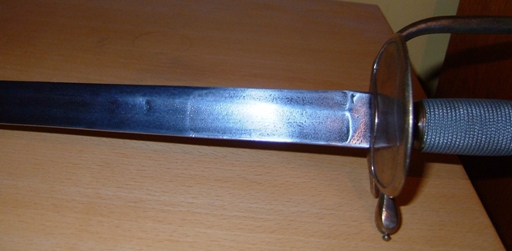

I concur completely. Additionally you'd probably reduce the value of the piece by about a third at the very least. As it is it's just wear and tear to a greater or lesser extent.
The marks look a bit like a "scarf weld" from the pictures. The sort found near the hilt, and show different patenation between the iron and steel.

...The marks look a bit like a "scarf weld" from the pictures. The sort found near the hilt, and show different patenation between the iron and steel....
Please pardon my ignorance, David, but, what is a "scarf weld"?

It is where a softer steel forte and tang are welded to a harder steel blade by overlapping. It's often seen on blades from the early 1780s and before. It appears as a line across the flat of the blade at different places on either side and sometimes a diagonal line across the spine. Usually it is done about 3" from the guard. It shows up sometimes because the aging of the steel produces different colours
Like this:

Thanks for that bit of information, David. I am now wondering if my late 18th century British hanger has such a weld. It is much more discernable in person:
It still lives in Wisconsin, so I cannot inspect it at the moment (d'oh!). Sorry if this is straying off-topic!
