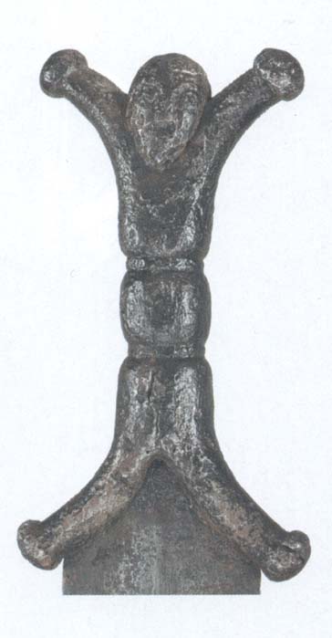

From much of what I've read and heard, typical Celtic Anthropomorphic-hilted swords were fairly short, perhaps even of large dagger length. They are also regarded by some as possibly only ceremonial weapons because of their size. I've heard the Del Tin version (~24.5" overall) referred to as overly long as well (Edit: the sword the DT is loosely based on has an overall length of 19.5", making the DT overly long for what it's replicating).
Well, here's one to skew the averages and curve. :) This anthro-hilted sword is from Sotheby's December 2003 auction. Its blade is listed as being 29 5/8 inches long.
What is a more "typical" or "average" length?

circa 4th-1st Century BC
Attachment: 30.25 KB
Attachment: 64.03 KB

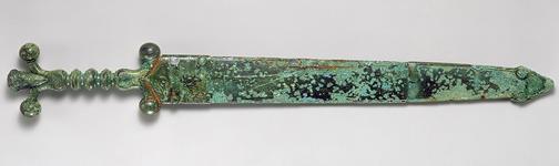

Here's the information about the sword from the Metropolitan Museum of Art (the photo is below):
| Metropolitan Museum of Art wrote: |
Sword, mid-1st century B.C.; Late Iron Age (La Tène)
Celtic
Iron blade, copper alloy hilt and scabbard; L. 19 3/4 in. (50 cm)
Rogers Fund, 1999 (1999.94a-d)
This sword offers eloquent testimony to the value that Celts placed on war and weaponry. Celtic artists often ingeniously integrated animal and human forms in the decoration of precious objects; here a warrior serves as the dramatic hilt for a double-edged sword. With its carefully defined features and finely drawn curls, the figure's head contrasts with the abstract form of the limbs and body. The arms and legs are V-shaped, terminating in round knobs, while the body is made up of three turned ring moldings. The scabbard, now amalgamated to the iron blade, still displays much of its original ornamentation in the form of three small hemispheres on the front upper end, a molding element at the tip, and an elaborate loop at the back for attaching the scabbard to a belt. Swords with an anthropoid hilt are characteristic of Celtic Europe in the first century B.C., with some fifty surviving from this period. Their inclusion in richly outfitted graves suggests that they were the valued property of aristocratic warriors. They may have been meant to enhance the power of the owner, or perhaps served as talismans in battle. |
Others may very well find many more examples. I thought I would post what I found, even if some were only roughly similar to the anthropomorphic hilt swords. It is interesting that the ones I found were much shorter than the 29 5/8 inch one that Chad posted (overall lengths of 24 inches, 20 inches, 16 inches, and 19 3/4 inches respectively).
