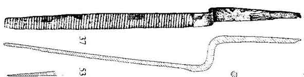

PostPosted: Sun 15 Feb, 2004 12:33 am    Post subject:         Quote
Two files from the Mästermyr find, a traveling blacksmiths toolbox from around AD 1000:
 Attachment: 38.42 KB
Profile PM Website

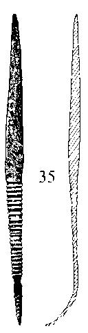

PostPosted: Sun 15 Feb, 2004 12:35 am    Post subject:         Quote
Another file:
 Attachment: 31.89 KB

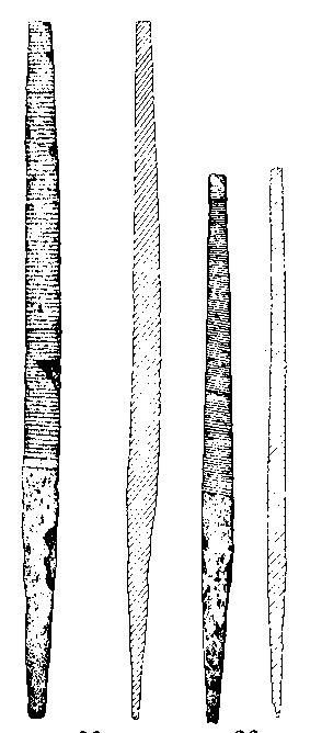

PostPosted: Sun 15 Feb, 2004 12:37 am    Post subject:         Quote
Another:
 Attachment: 12.57 KB

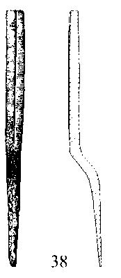

PostPosted: Sun 15 Feb, 2004 12:40 am    Post subject:         Quote
And yet another. Note the cut dividing the file lenghtwise. It creates two files side by side. It seems one could file a surface and get a small elevated ridge...
 Attachment: 10.47 KB

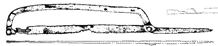

PostPosted: Sun 15 Feb, 2004 12:42 am    Post subject:         Quote
And last, a saw much like a modern hobby saw. It has a dismountable blade with fine teeth.
 Attachment: 27.72 KB
