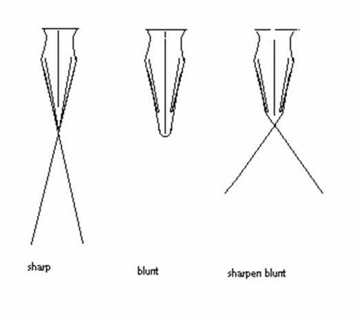

PostPosted: Sun 07 Dec, 2003 5:53 am    Post subject:         Quote
A picture done in paint, just to illustrate what happens when you sharpen a blunt compared with a blade that is sharp to begin with.
You can still cut with it, but it is not optimal.
(I´m sorry about the quality of it all, but it was done in haste.)

PostPosted: Sun 07 Dec, 2003 1:51 pm    Post subject: sharpening DT         Quote
The edge on my Del Tin 2132 is not nearly as blunt as on the drawing of mr. Hörnell.On the ISF I've read that a great deal of the medieval swords were having an edge in the form of an apple-seed. That would give a more durable edge in battle.
So I think that from the basis 0.5mm edge on my deltin there has to be made a decent edge. I have an old (about 200 years) Dutch cavalry saber that have the same "appleseed"edge,

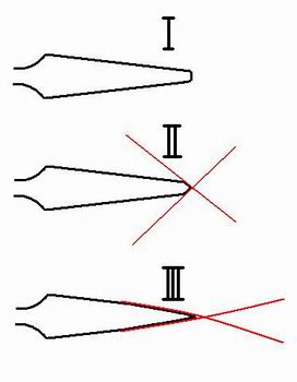

PostPosted: Sun 07 Dec, 2003 4:22 pm    Post subject:         Quote
A common mistake with sword edges is to make the edge bevels too short. In pic I, you have the standard semi-blunt Del Tin edge, in II the rather common "sharp blunt", as Fredrik put it. In III, you have a smoother transition from blade flat to edge ("appleseed"). The latter requires more work, but results in a better-cutting edge.

PostPosted: Sun 07 Dec, 2003 5:10 pm    Post subject:         Quote
Hello Bjorn,
So are you saying that it's possible to sharpen a typical Del Tin blunt edge(say for example, the 2140) into one with an "appleseed" like edge? I was talking to a person that I consider fairly knowledgable today about such things, and his opinion was that if a sword was meant to be a blunt, (with a 1.5-2mm edge) then it would be very difficult to change it.
My Del Tin swords with the old Krupp steel seem to have .5mm edges, maybe less (I only have a clear plexy glass metric ruler to measure) so it would seem that they could be sharpened to have a decent edge.
In an earlier post, you said that the standard Del Tin edge is .7 mm. That would seem to be similiar to my swords, and if sharpened correctly, would make for a decent cutter?
Thank you.
Mike West
Profile PM
PostPosted: Sun 07 Dec, 2003 5:15 pm    Post subject:         Quote
Of course it's possible. As has been said in this topic a few times now, it just requires the change of blade geometry and not just the sharpening of the edge. Look at Bjorn's image, above, to illustrate the point.
