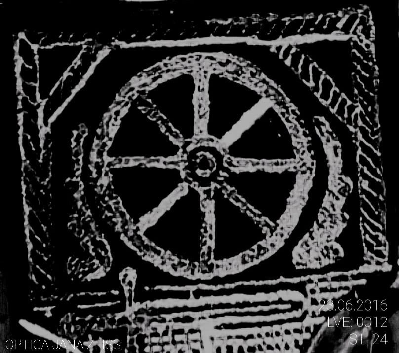

I have come across something that I cant seem to place. First the sword has a round tip, one that I have never seen before. Which of course rules out any thrusting capabilities and makes me believe it is either a show piece or has a special purpose.
Does anyone have any ideas or know what it is? I am thinking Italian, ca. 17th-18th C.?

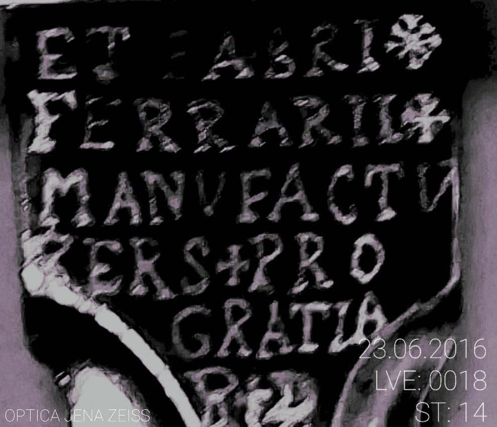

Also, authenticity, from the photos the wear seems legit. However, because of the text, which can be seen in the microscope views, it gives me the feel that it could be modern??

I have no knowledge of Latin whatsoever, but according to google translate the inscription in the fuller partially reads something like:
Lived without respect
The other inscription says something about "and ....blacksmiths...." and "for grace"
Perhaps translating the entire inscription might shed some light on its history.
The other side of the blade has what appears to be a wheel similar to that on other execution swords from the Renaissance.
I would hazard a guess that it is a depiction of "Rota Fortunae" or fortune's wheel.
In Medieval Europe It often had the connotation of the tragic downfall of the mighty and that death comes unexpectedly.
All of which seems to be consistent with it being an implement of execution.
