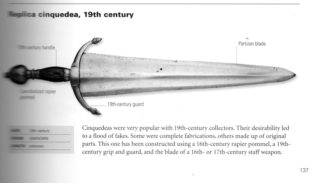

19th-century cinquedea from The Complete Illustrated History of Knives, Swords, Spears & Daggers. I imagine the reused parts make this one a lower-end repro/fake.
Sorry about the blurred edge, it's a thick little book and I wasn't able to press the scanner lid down because my computer and scanner are in two different rooms.

Wow what a frankenstein! Thank you for the example. That's exactly the type of example I am looking for.
