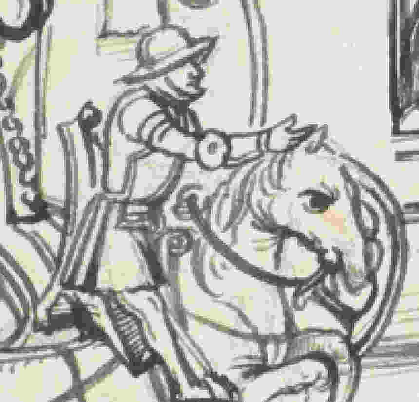

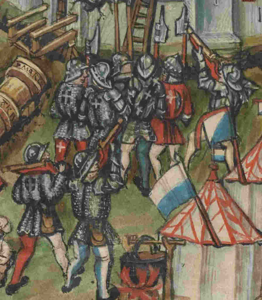

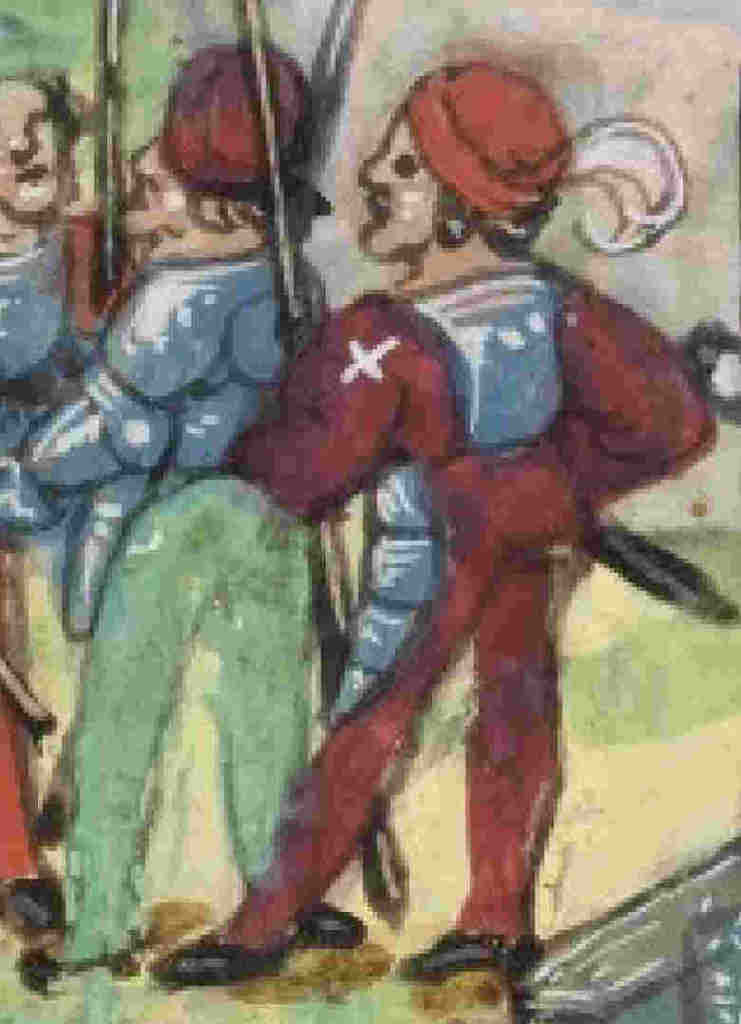

In the late 15th to mid 16h centuries, how common was it for soldiers to wear breastplates with no back plates? Was this the norm or was it relatively rare?
I've seen in art, depictions of what appear to be levies and city militias wearing little more than a breastplate (no back plate) sometimes with a helmet and occasionally gauntlets. It also seems that light cavalry Frei-Lanzer/demi-lance/coustiller armour ranged from gauntlets, a mail shirt worn under a breastplate (no back plate) a sallet and occasionally a bevor to the same outfit with light arm harnesses and knee length leg harnesses added. The lower legs being protected only by boots. By the 16th century you sometimes see Landsknechts wearing a breastplate and back plate and a helmet of some kind and Frei-Lanzers/demi-lances/coustillers wearing a breastplate with backplate and articulated assets, mail shirt underneath (or just sleeves), gauntlets and an armet.

The first image shows a mounted crossbowman, which is bellow the rank of men-at-arms and of which couldn't afford full armor (for example, the book Lisboa e a Guerra had a royal decree stating that people with enough income to afford the weapons and full armor had be promoted from the crossbowmen class to the MAA class)
The second isn't a frontal cuirass, the whole piece is actually underneath the clothes, sometimes these hide fully or partially the cuirass (arm harness, however, is normally worn OVER the clothes). The soldier in the picture is a light cavalrymen. Both mounted crossbowmen and light cavalrymen came from somewhat mid-class citizens who couldn't afford the cost of being a propper men-at-arms. I highly recommend you read Daniel's article on German light cavalry: http://kriegsbuch.blogspot.com/2016/01/the-ap...n.html?m=1

The last two images are representing infantrymen. Veteran and more wealthy infantrymen would manage to get more pieces of armor to be more well-clad; since they couldn't afford the whole suit, they would buy or use the most important pieces for them; that's why, for example, the Jack Chains, or cadenas in Castillian, emerged. Frontline pikemen and billmen, light cavalrymen, veteran and richer archers and crossbowmen often have these partially armored fitting.

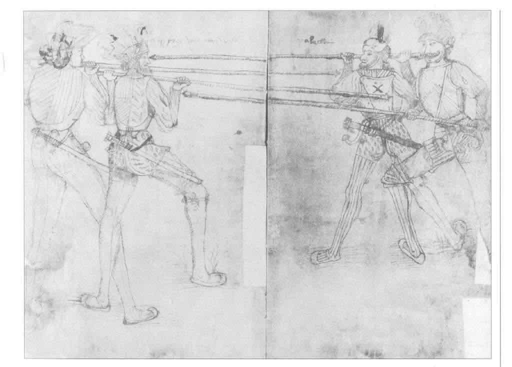

1500's Dolstein description of the swedish army and german Landsknecht soldiers show that frontline pikemen wore full cuirasses, tasset, and arm harness; while both the normal pikemen and the doppelsoldner (by this time only the halberdiers, the two handers not being introduced yet) had at least the frontal cuirass.

I've seen Dolnsteins drawings and they are very interesting. However, while some of them show men in the front ranks in light plate arm harnesses, others show these men wearing only breastplates, possibly back plates and tassets. Plus, other images, like the "Schlacht vor den Toren Nürnbergs"/"Schlacht im Walde" show men on foot wearing breast only and guys on horse back wearing breast plates under a tunic and bits and pieces of plate arm armour over their tunic. Some of them wear only pauldrons and couters over the tunic. So I'm guessing they'd have worn mail arm armour under the tunic because when these guys wore a light plate arm harness the entire thing was usually worn over the tunic unless it had wide puffy sleeves to accommodate the couters. Another thing is that I have been rifling through Mathias Goll's dissertation and I found what looks like 'back plate upgrade kits' for breast only plates. and I think one of the guys in Dolnstein's drawings is actually wearing one of these (the one with an X on his back).

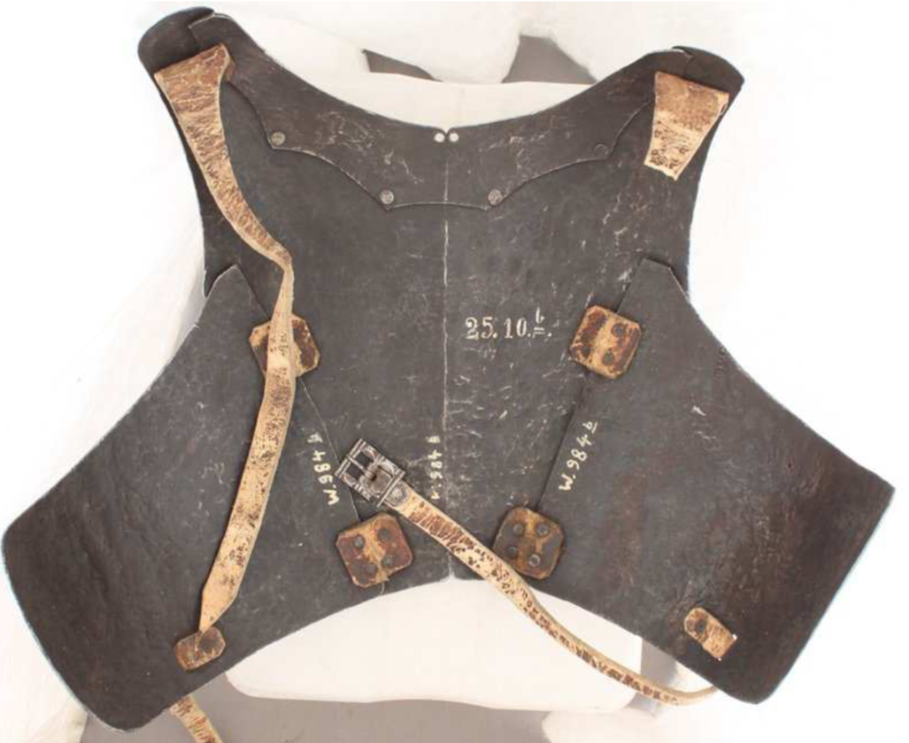

Finally, about mail, it was worn far into the 16th century. Generally I think a lot of cavalry began to shed full plate as early as the 1470s. The images from the Hausbuch are emblematic of that. I don't think the lancers in that book were wearing arm harnesses, the sleeves on their tunics could not accommodate the couters with sleeves that tight. They might be wearing back plates, it is impossible to tell with them wearing those tunics. After Pavia the lightening trend was only re-enforced. By the 1540s I'm seeing people in three quarter or half plate suits. I've seen images of cavalry from the 1540s and 50s wearing mail sleeves with a full plate cuirass and gauntlets, bourgonet or even an armet and by now carrying pistols and a war hammer.
P.S. I think the back plate in the last image which is tied to the mail shirt may be a fake but it gives an idea of what these retrofit back plates looked like when worn.

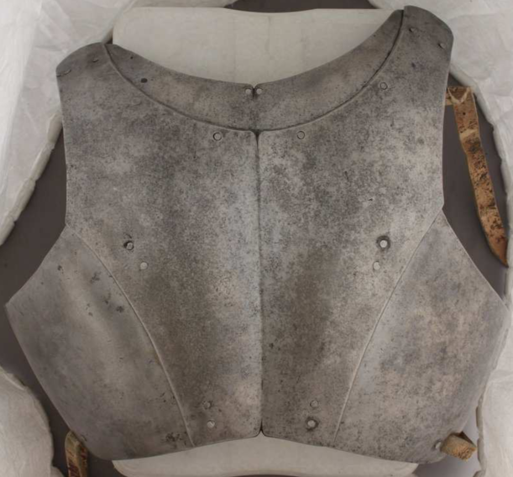

I'm going to acquire a replica of those breasts and backs shown above, so I suppose I'll find out myself. In the mean time I can only go by period sources who say that no lesser people than the Emperor Maximilian I and several of his high nobles preferred to wear a 'Knechtishcen Harnisch' it being so much more comfortable to wear for long periods than full plate. There must be a reason people who could afford full plate chose to wear a three quarter or a half suit or even a half suit with no vambraces and even a breast with no back. Here is one example, This being Engelbrecht I van Nassau-Dillenburg and Jan IV van Nassau, on a relief made in c.a. 1475. These two were the counts of Nassau and as such not exactly destitute and yet the figure at the back is wearing what is clearly a breastplate designed for use with a back plate but he wears it strapped to a gambeson without the back plate. There must have been a reason to leave the back plate off even though he had one. Having worn chain mail over a gambeson myself for hours on end I can't imagine it was weight so it must have been something else and the only thing I can imagine is agility. That having been said we're getting a bit off topic here. All I really wanted out of this thread was to know is how common breastplate only armour was, not challenge the dogma of armour scholarship.
