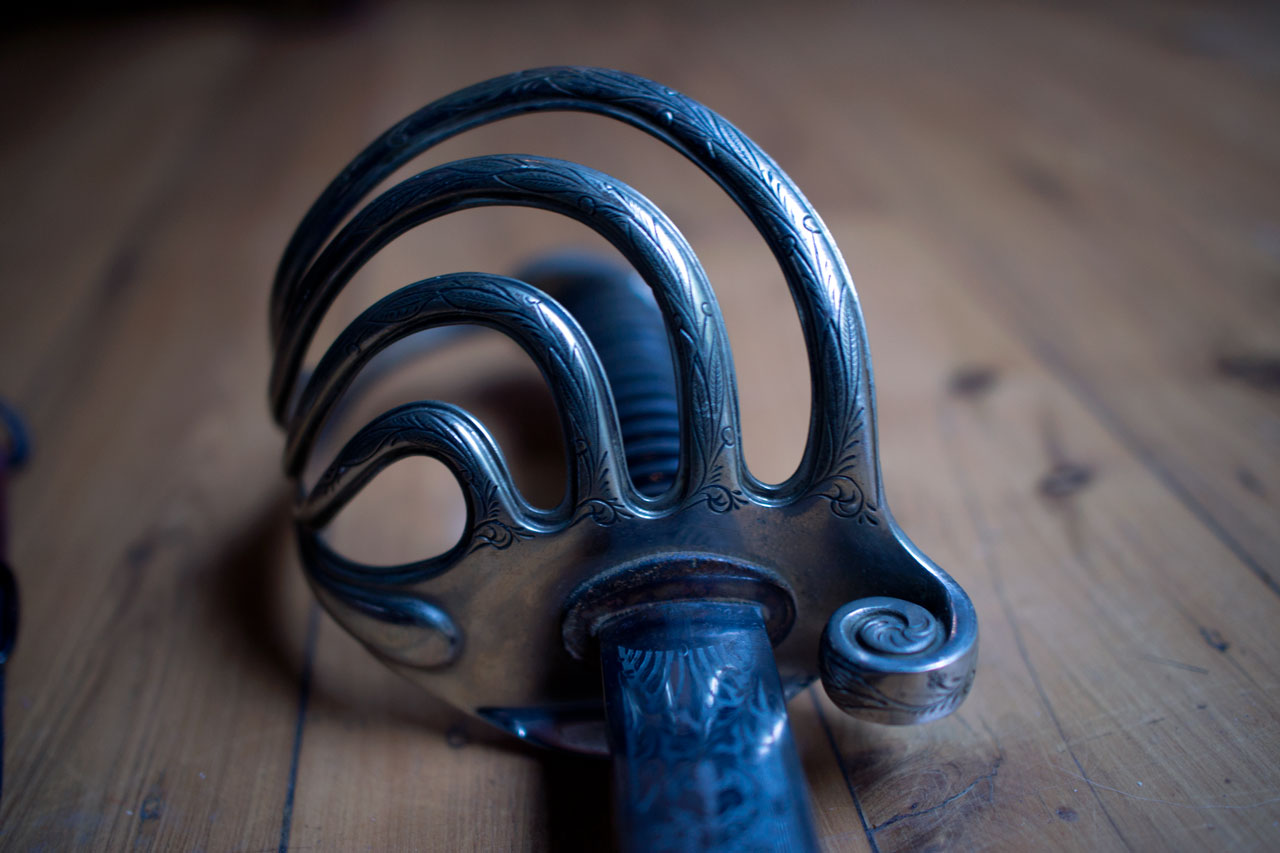

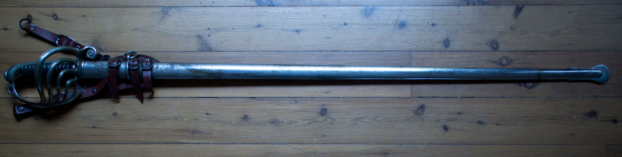

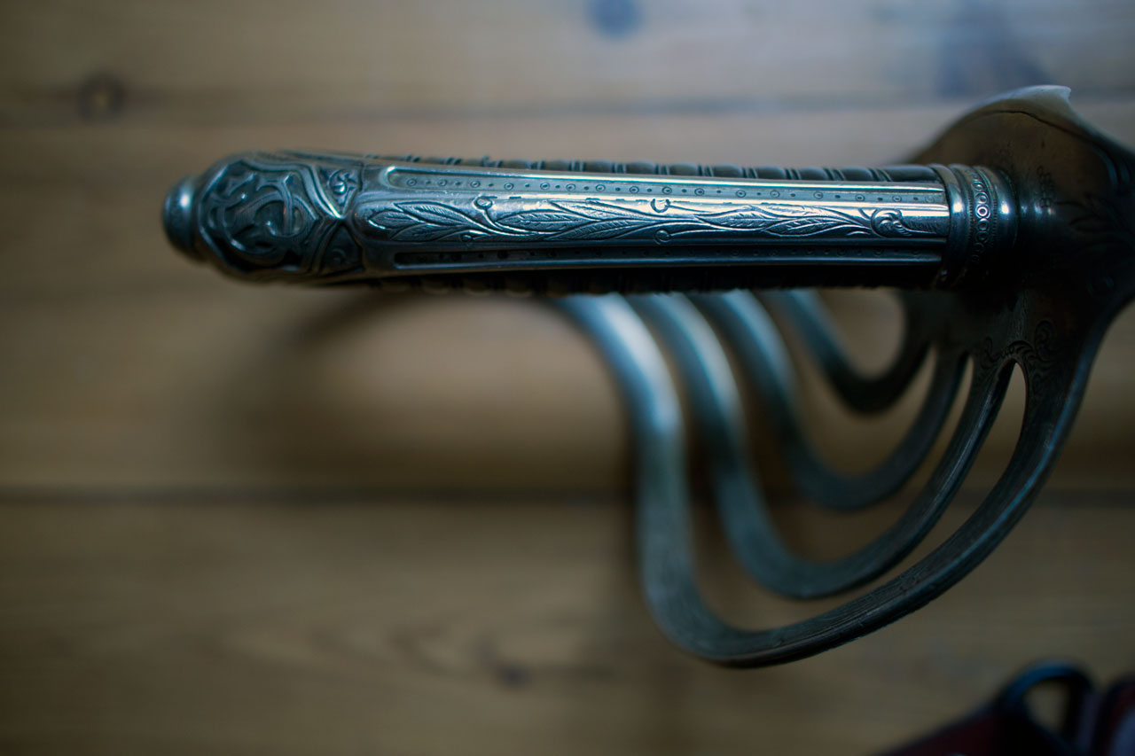

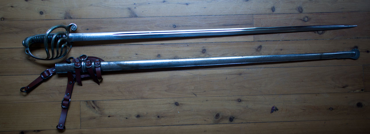

So I've decided that I'm gonna start posting a few of my antiques, starting with one of my more recent acquisitions.
(I know the color is off, but I was in a hurry, as I am rehilting a basket hilt repro, and converting a broken feder for one handed use. More on that later if anyone is interested.)

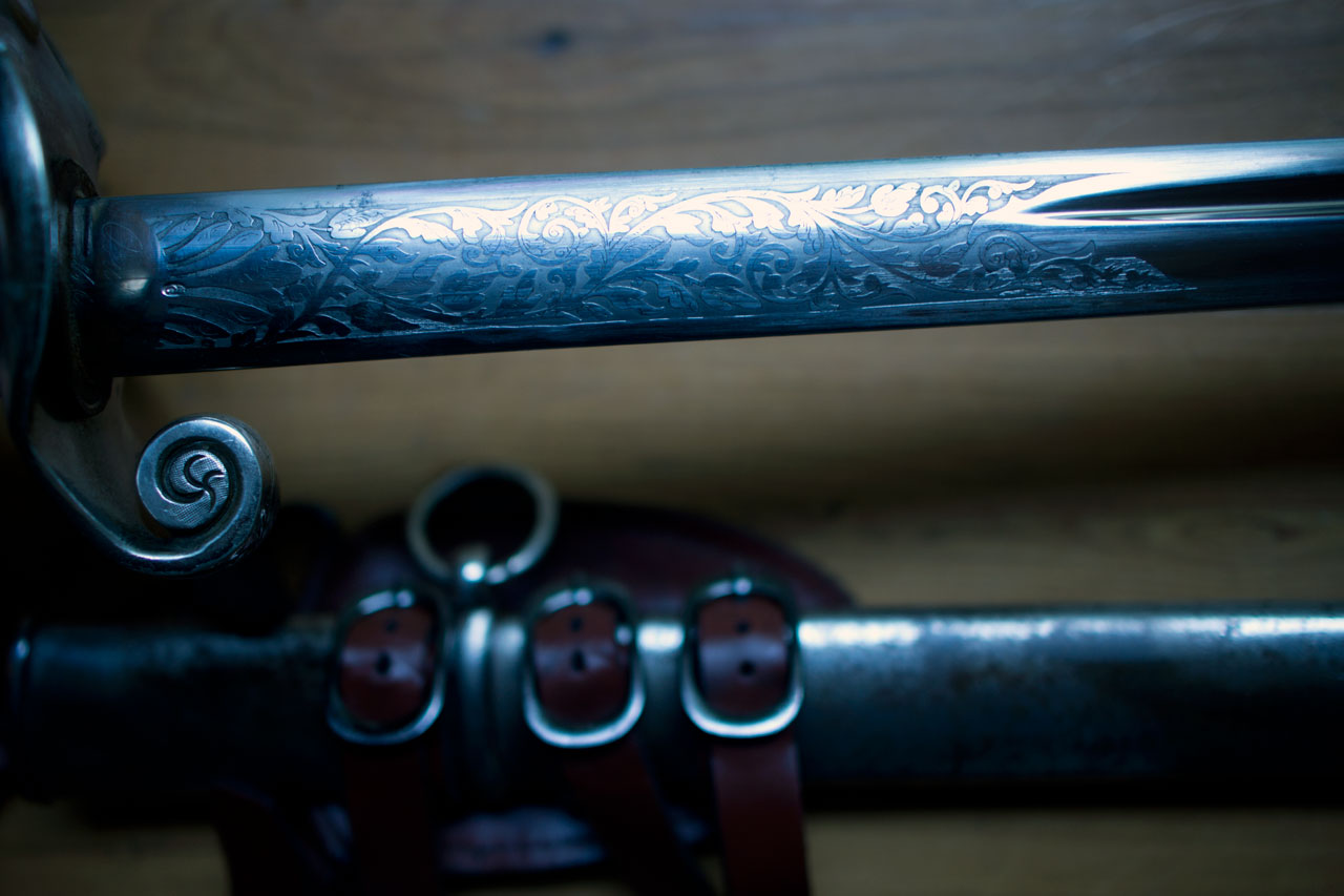

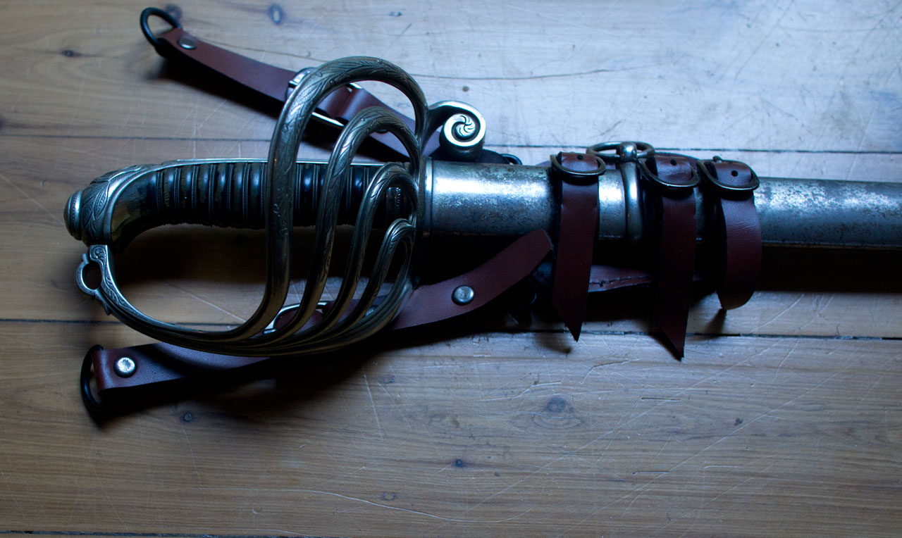

DESIGN: This is the 1882 French model infantry officers sword (épée d'Officier d'infanterie Mle 1882), which was a stiff, thrust-centric sword with no real edge to speak of. The profile taper is pronounced and fairly even, with the blade forming a very neat point, however the distal taper is somewhat less pronounced, adding to the stiffness of the blade.
This particular model is highly decorated, and though the blade is of Klingenthal / coulaux manufacture, the hilt seems to have been made by a custom cutler. This particular hilt has an additional bar added, for extra hand protection.
Many french swords used "german silver" or nickel silver for their hilts, this however has a steel hilt, coated nickel.
This example has a vertical sword knot loop, rather than the horizontal one of earlier specimens, which afforded easier tying of the knot, as well as slightly better durability.
The blade is highly compromised in terms of it's thrusting bias, and has a oval cross section with two offset fullers which are deep and narrow, making this blade very hard to flex. If flexed the blade quickly returns to true.
The blade and hilt are nickel coated, as is the steel dress scabbard. The grip is made of horn, presumably buffalo. There is a single wire in the wrap missing, however given the age of the sword the condition is superb. There is some damage to the plating on the hilt and scabbard, however the blade is without any form of tarnish.
History: This pattern of sword would have seen use in world war 1, however this particular example predates those events, and has not seen use.
The blade is made, as noted, in Klingenthal, the national manufacturing facility for swords in France, however the word itself is German for "valley of the blades".

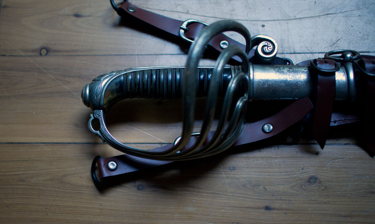

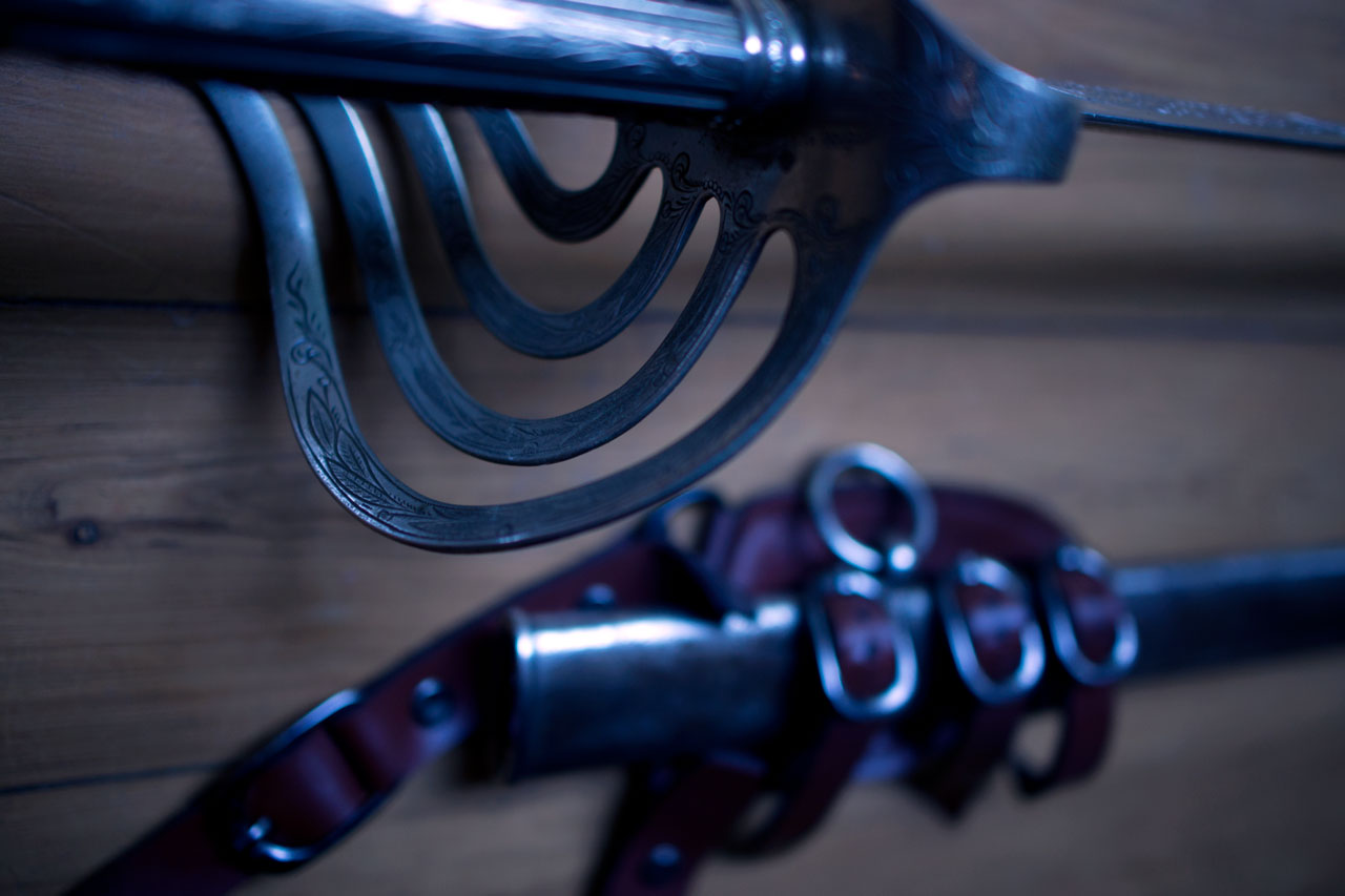

Note, the hanging system here pictured is in fact a polish system, as this sword type was used by a polish regiment (from what I can gather, the "Blue Army") where it was known as a "hallerówka", after General Jozef Haller.
It is also possible that someone just chucked a polish hanging system onto it for fun a some point in history.
This sword was made in July of 1896, as noted on the etched blade. There is a faint inscription of Klingenthal on one side, with Coulaux Cie on the other. The proof marks, having been covered by the nickel coating applied by the private cutler as difficult to discern.
The floral motifs and initials on the backstrap are elaborate and delicate, and mark this as a superior officers sword (as opposed to the standard model which was not decorated.) A similar sword is on display at the Australian War Memorial,

A nice piece. Have you been able to determine what the letters of the monogram are? (they are not shown straight on and upright in your photo). The suspension is interesting, perhaps for mounted infantry or artillery officer? I have a pre-1882 sword of this type with the same offset groves (cannelure). No doubt the grip is buffalon horn. I was perplexed with a jet black grip wondering if it was plastic but was assured it is horn. Another later sword though, was indeed plastic.
If was done by a private cutler, there should be a cartouche of some type on the base of the guard by the blade (usually on the blade side).
GC
