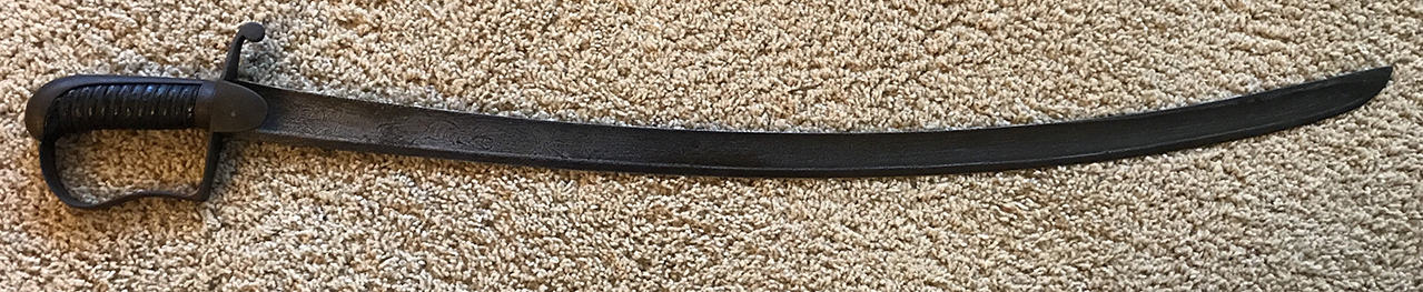

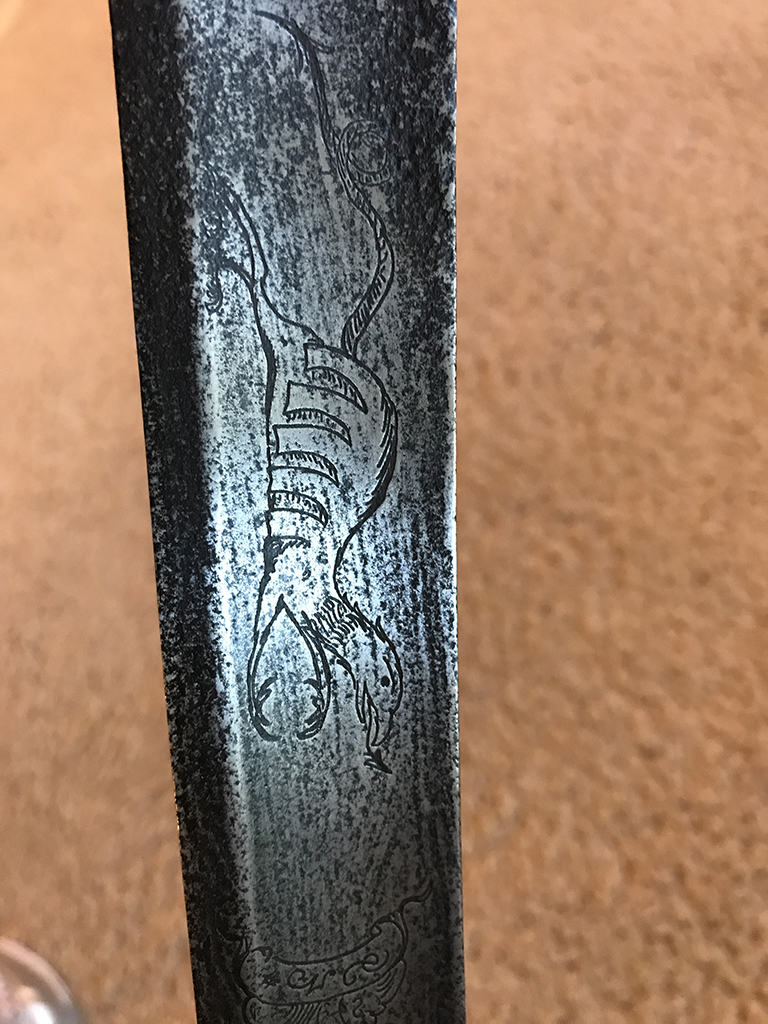

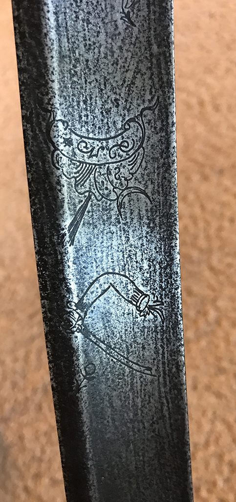

Hi all,
I'm new here because I just bought my first sword and I'm hoping someone can tell me if it's real or a fake/reproduction. And also if you have time, a few quick pointers about how you can tell.
Also, should I clean the blade? It's quite dark but I'm afraid to mess around with it. It almost looks like it has some dark material wiped onto it.
Thanks!

Glen A Cleeton
Posted: Thu 18 Jan, 2018 4:24 am Post subject: |
Welcome aboard Scott
It looks ok to me. The blade etching looks interesting. It is hard to tell what the covering might be. Sometimes varnish was used to preserve blades. You might try using acetone on the metal but if the coating is also on the leather, that can cause some issues. Use whatever solvent you use on a pot and let it soften the coating, then to be scrubbed off with copper, bronze or even fine steel wool. I use copper kitchen scrubbies and the blue plastic Scoth-brite looking thingies. removing whatever may be coating the grip may become problematic, proceed with utmost gentleness.
Some pictures of the overall in profile would be neat to see. What is the overall length (in a straight line) and how long is the blade?
Runkel, of Solingen, exported swords and bare blades to England and actually had an operation/sales there. You may want to cross post this over to http://www.swordforum.com/forums/forumdisplay...word-Forum as there are many British collectors over there.
GC

Ralph Grinly
Posted: Thu 18 Jan, 2018 12:40 pm Post subject: |
Honestlly..if it is genuine..and I don't see anyone going to that much detail work on the blade on a modern replica - I'd leave it alone. It looks pretty good for it's age. whatever the coating is, it's done it's job very well. In a way..the coating may be just as much an antique as the sword itself. Unless it's all sticky and gummy , getting over your hands as it's handled. I'd be leaving it alone.
Any non-professional attempts to "clean-up" any old weapon will probably lessen it's value to a collector. Unless the item is in serious danger of damage or deteriorisation it's best left "as-is" .

Oh, and regarding size, your sword is not one that was meant for cavalry but rather infantry work. It is not uncommon for any p shaped hilt to be called a 1796 but it is just a form that prevails over many decades both before and well after 1796.

E.B. Erickson
Posted: Sun 21 Jan, 2018 4:55 am Post subject: |
You've got a stylized winged dragon along with the usual floral motifs: many of Runkel's blades in the early 1800s had this dragon - it seems like one of the decorative options that was available on his blades.
I used to own an 1803 pattern infantry officer's sword with exactly the same etched designs as your sword.
--ElJay

E.B. Erickson
Posted: Tue 23 Jan, 2018 4:23 am Post subject: |
Hi Scott,
No photo of my 1803; it was sold off a long time ago! Sorry!
--ElJay
E.B. Erickson
Posted: Tue 23 Jan, 2018 4:48 am Post subject: |
Why not try Google? I asked myself.
See this link: http://www.skinnerinc.com/auctions/2652M/lots/89
The ivory gripped sword has the dragon near where the b&g ends. The 1803's blade looks like a twin to the blade in your sword.
--ElJay
