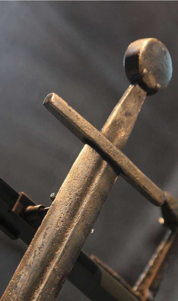

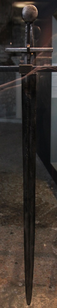

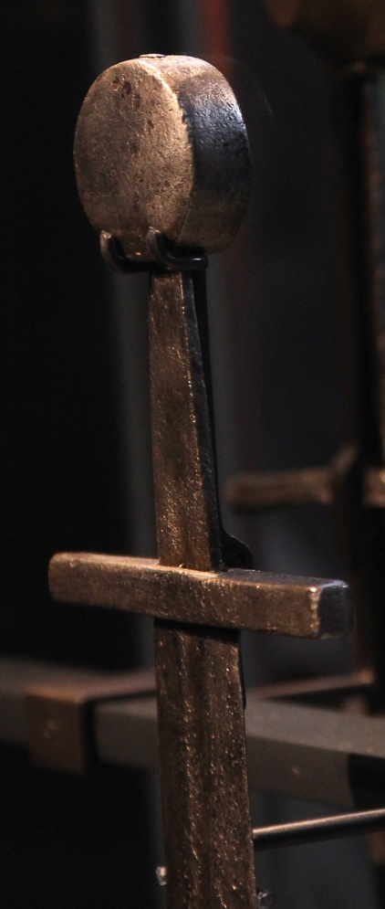

I see Vikverir has a few photos of the St. Omer Type IX, so I've re-posted them here.
The other photos that I did not include, plus numerous photos of other swords from the Musée de Cluny exhibition on swords that I did not include, can be found here: http://www.vikverir.no/ressurser/usages_mythe...amp;page=7
Edit: The link that Guillaume posted for the St Omer sword has a particularly fine image of the sword, which I have attached to this post.
 Attachment: 42.42 KB
 Attachment: 149.37 KB
 Attachment: 51.58 KB
 Attachment: 96.44 KB

PostPosted: Mon 13 Feb, 2017 11:27 pm    Post subject:         Reply with quote
Here is a french page on the Saint-Omer sword.
There's a few specs mentioned, unfortunately not the weight.
Total length 96.5cm
Blade width 4.4cm
Crossguard length 14.3cm
The symbols "OOOOOOO" are incrusted in silver on the blade
I'll try to contact the museum to obtain the sword's weight.

PostPosted: Mon 13 Feb, 2017 11:43 pm    Post subject:         Reply with quote
I am surprised by how short the St. Omer sword is. Initially, I was wondering if this was to offset what seems to be an unusually wide blade, but then I noticed that Søborg D 8801 (XI.3 in Records) is actually a millimeter wider at 4.5 cm, and the latter has a longer blade and overall length, too. So it will be interesting to see how much it weighs.

PostPosted: Tue 14 Feb, 2017 12:45 am    Post subject:         Reply with quote
In fact I wrote "total length 96.5cm", but I'm not very sure about it... Looking at the proportions, it could rather be the blade length. In fact I verified on the sources, it is just mentioned "length". I hope that the museum will answer me to resolve this ambiguity.

PostPosted: Thu 16 Feb, 2017 9:07 am    Post subject:         Reply with quote
That's funny, I actually never interested into type XI swords, but I must admit the Saint-Omer sword really has catched my eye! I love this combination XI.G.3 or XI.G.1. Thanks Craig for this thread Big Grin
So I actually tried to draw it at scale, using the datas I knew, and it seems that 96,5cm is indeed the blade length. If not, the blade would be something like 82cm, which would be very short for a type XI - and the handle would have looked proportionnally far bigger.
Incidentally, what a blade! If the point was originally acute, the blade must have lost like 1 to 1,5cm.
But as I obtained with Peter Johnsson geometry and the global dimensions I determined with the pics, the blade seems good. Maybe the spatulate tip was on the original.

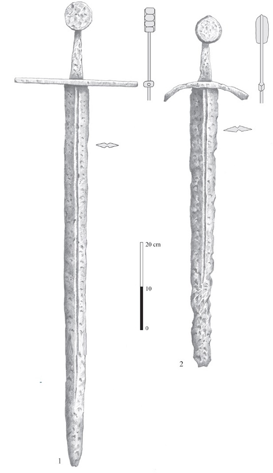

PostPosted: Fri 17 Feb, 2017 10:36 pm    Post subject:         Reply with quote
Marko Aleksić’s Mediaeval Swords from South Eastern Europe has a pair of swords, catalogue no.199 and 197 respectively, that he identifies as being Type Xa blades. However, assuming that his line drawings are accurate, the narrowness of the fullers means that both could just as easily be classified as Type XI blades. The sword on the right may actually have a Type H pommel rather than G, although the drawing seems slightly ambiguous.
 Attachment: 66.48 KB

PostPosted: Fri 17 Feb, 2017 11:46 pm    Post subject:         Reply with quote
The blade to hilt ratio is not right I think, for this type(mostly the one on the right, but also the one on the left). XI blades are much longer when compared to the hilt.
And I think it's a different story from the miscellaneous #24.

Craig Peters
PostPosted: Sat 18 Feb, 2017 7:33 am    Post subject:         Reply with quote
Oakeshott indicates that a Type XI has a slender blade, "generally [emphasis mine] long in proportion to the hilt, with a very narrow fuller running to within a few inches of the point," (Records, p. 53). Notice that Oakeshott is not precise on the blade to hilt ratio, so this alone cannot be used to rule out a Type XI. I think there's a stronger argument to be made about the fullers not matching the description. That having been said, the narrowness of the fullers seems to be the crucial characteristic of an XI blade, and Oakeshott undoubtedly had not seen many of the swords in Aleksić’s book, which do not always perfectly coincide with Oakeshott's typology. So long as the fullers are truly as narrow as they appear, I think XI is an appropriate designation.
