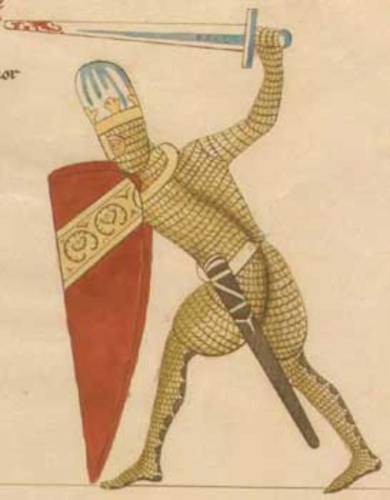

That seems the most likely answer to me too but there are many other similar images that seem to show mail "trunks" attached the hauberk, like the one below. I might finally try taking on my hauberk project soon so I wanted to be sure I'll be okay with a simple split.

PostPosted: Mon 01 Aug, 2016 11:43 am    Post subject:         Reply with quote
This image looks funky. It doesn't look like split, but I don't believe it's with attached chausses either. Artist probably just wanted to represent mail as well fitting to the person. Slit is probably only in the front.

PostPosted: Mon 01 Aug, 2016 12:00 pm    Post subject:         Reply with quote
Alternately, the flaps might be tied or otherwise fixed around the thighs like you can do on some modern dusters, to stop them from flopping about, especially when moving on foot.

PostPosted: Mon 01 Aug, 2016 12:38 pm    Post subject:         Reply with quote
I would concur with this, it seems a fairly obvious solution. It would be no problem at all to run a bit of string or lacing through a few links of maille and just bind it together after dismounting.
Mike Ruhala
Location: Stuart, Florida
Joined: 24 Jul 2011
Posts: 335
PostPosted: Mon 01 Aug, 2016 3:19 pm    Post subject:         Reply with quote
That thought occurred to me as well. It is a possible explanation for the apparently contradictory images in the Bayeux Tapestry and it seems like a conceptual continuation of the old saying about "gird your loins."
