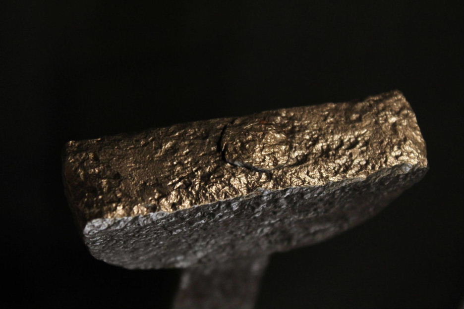

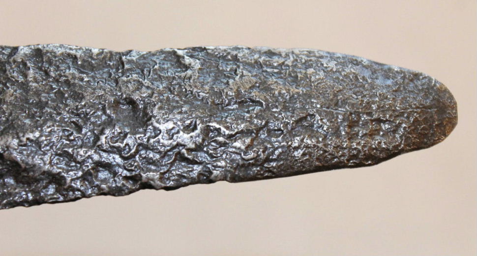

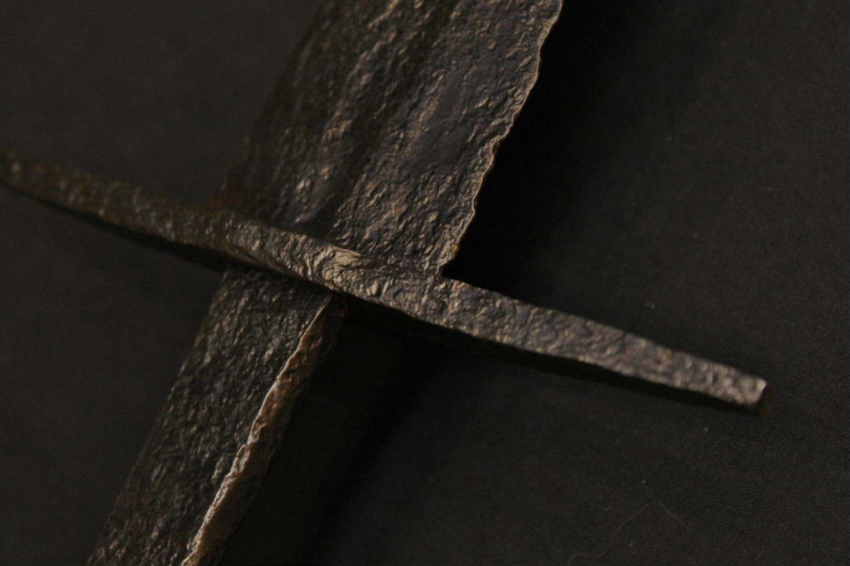

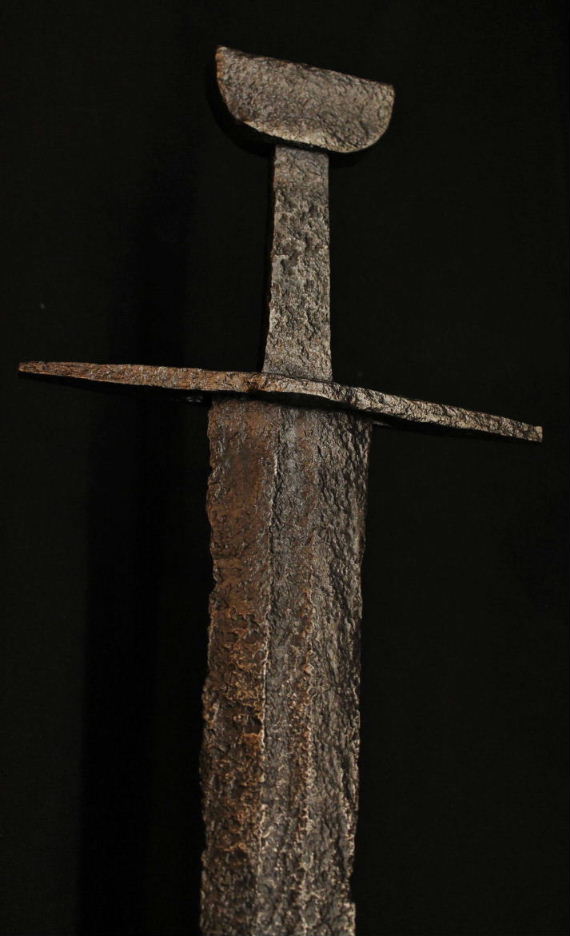

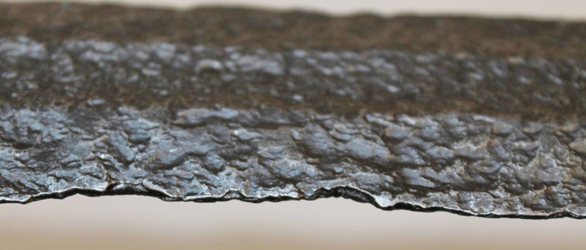

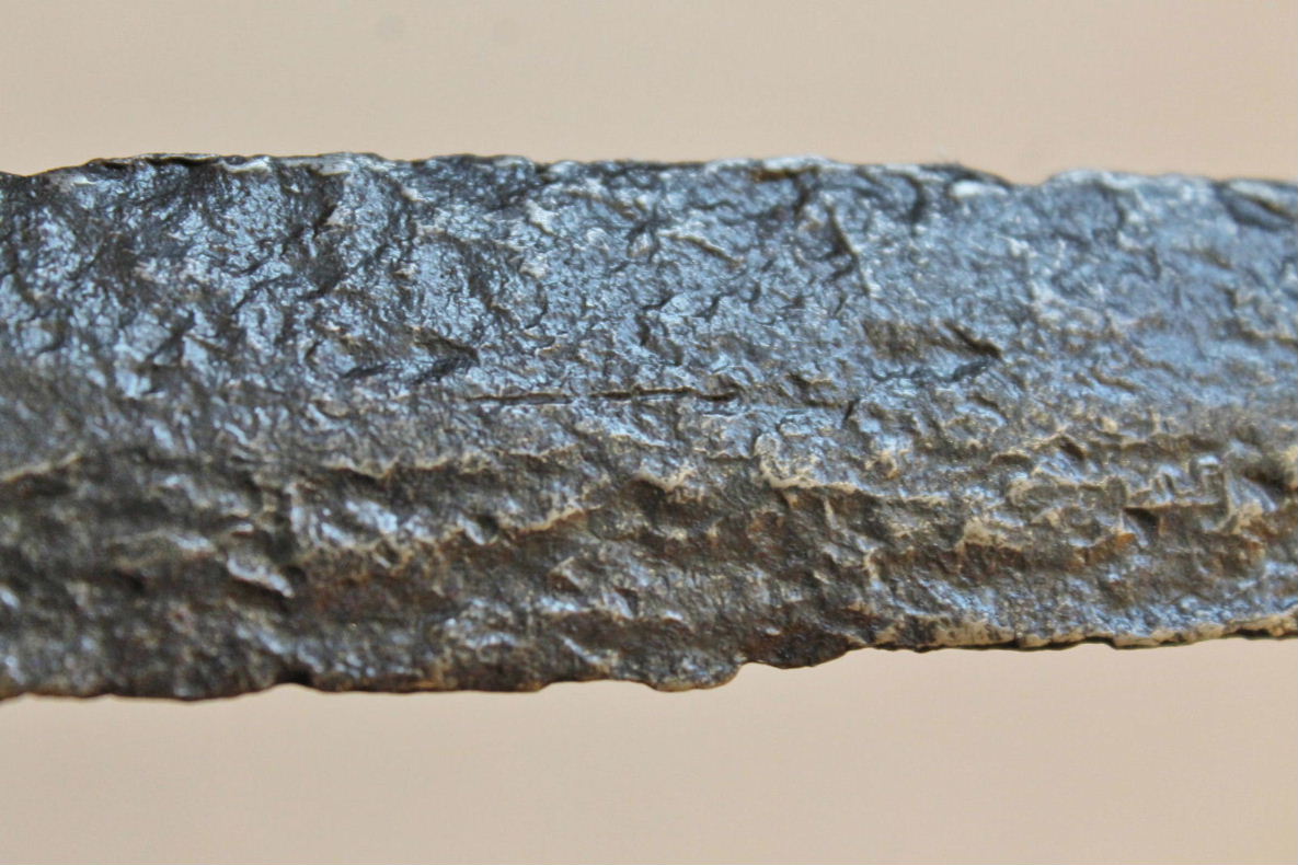

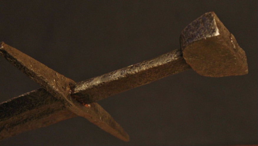

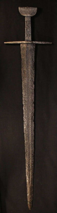

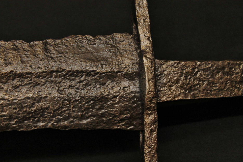

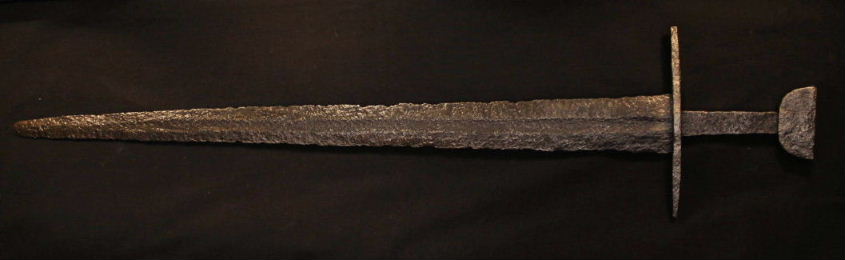

Hello All,
I recently acquired this sword with a rare type of N pommel with another one with a type j pommel, but this seems to be more interesting to me.
It came from the U.S. , from a woman who knew nothing about it realy, she said it is a 16th century german dagger, guess it was one of her relative's stuff or was given to her to sell, or who knows.
I could not find too much information, it seems to be authentic, although I have little knowledge about these sword since I collect japanese swords mainly. Not sure why would anyone fake a sword with a rare type of pommel anyway, on the edge I can see small lose laminations, folding layers, it is covered with some thick preservation wax but still easily watchable for details.
Cutting edge is 74cm, full sword length is 88cm
Can anyone tell anything about this sword or where should I inquire further?
If someone in interested in the other sword I am happy to take pictures and upload them.

The corrosion looks old, at least to me, but the sword is a bit suspicious to me. The blade tapers very dramatically for a sword of that type, the tang doesn't taper at all, the pommel is crude and a bit too big and thick, proportions are a bit weird... I don't know. Could be real, but I would suspect it's a 19th century or even later replica... But I would gladly be proved wrong...

Hello,
thanks for the replies,
the tang has a small tapering, around 1.5cm long from the cross bar eniding in a round point, it is hard to see but easy to fell and then notice it. About the pommel, I seen much cruder works than this, about size , this type and similar sized type pommels are this big, the balance is good for the sword so the size was done for a reason.
Victorian copies are having like a dark brown dried oil like patination, not a worn surgace as it was in the ground or river, it had a twist and small bend that had to be realigned by a restorer. If it was a copy of a rare type pommel they would copy exactly the same dimensions and would make it longer as long ones are more desirable.
I am not saying it is not a copy but feel your reasoning are not convincing enough and since I can see this blade has layers, forged, flexible, has age apropriate patination and wear, so I still have not decided what to believe yet.

Since you have the sword in hand you can definitely see and feel important details we can not. My reasons are definitely not decisive, it was just a few details I found suspicious.

What you need is a professional opinion, but here is another amateur opinion.
First, if this is an authentic sword it would be classified in Oakeshott's scheme as an XIV dating to approximately 1300, give or take. The tip of the sword shows signs of a diamond-shaped cross section which is common to some of those (as well as many cheap modern replicas). On this, Oakeshott commented that this might make it technically an XVI, but he went with the overall shape in classifying such swords as XIV. The fuller looks reasonable to me for this type. The other swords you picture are earlier types: Xa, XI.
Regarding the pommel, in profile it looks like some of the N variants you picture, but I believe this type by definition has a roof-like top and I think that is true of the examples you show. Your sword has a flat top, even swelling in thickness. That puts it closer to an even rarer type 'P', similar to the Naumburg sculpture, which dates a bit earlier to the standard range for XIV but has similar dimensions. So this is either a fake by someone who only knew the profile of N, or a more rare type.
The cross is interesting because of the slight curve. One sees this sometimes in originals, but very rarely in modern replicas - they tend to be straight or clearly curved. I don't know why, but this adds a touch of authenticity.
The tang, again, is the troubling part. As noted above, it is unusually parallel in profile and its chunky thickness. Some XIVs have pretty parallel robust tangs, but then those ones (that I know of) also had the fuller extending well into the tang. This unusual tang, plus the unusual pommel, give the sword its suspicious look. But unusual does not mean wrong: lots of medieval swords have unusual features that don't fit with expected typologies.
I don't see anything obviously wrong with the state of corrosion, although apparently anything can be faked these days.
Overall, just based on those features and intuition, this looks like a real sword to me, but with some unusual features that require more scrutiny for confirmation by a professional.
The Naumberg founder statue of Wilhelm of which Gajdos has given a sketch has that top pent-roof structure
http://www.flickr.com/photos/12575591@N00/5881912621
The myArmoury page says the Type P is only known in a statue from Nuremberg cathedral. Was there confusion between Naumburg and Nuremberg, or is there another statue in Nuremberg which gives another example of the type?

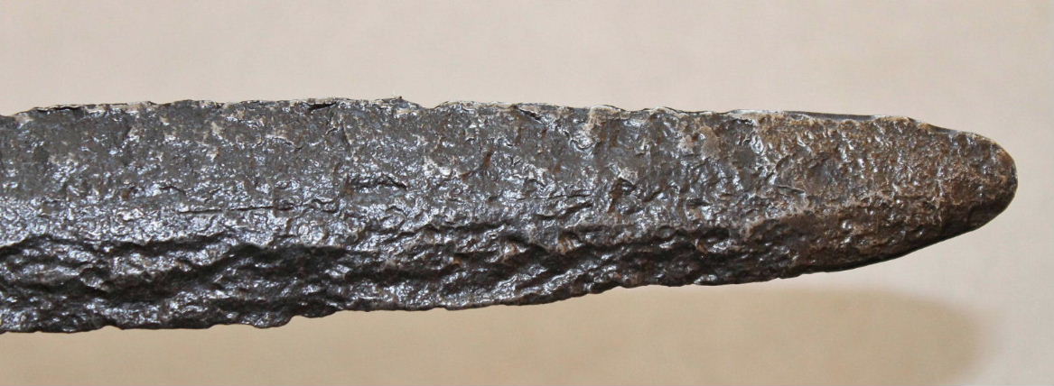

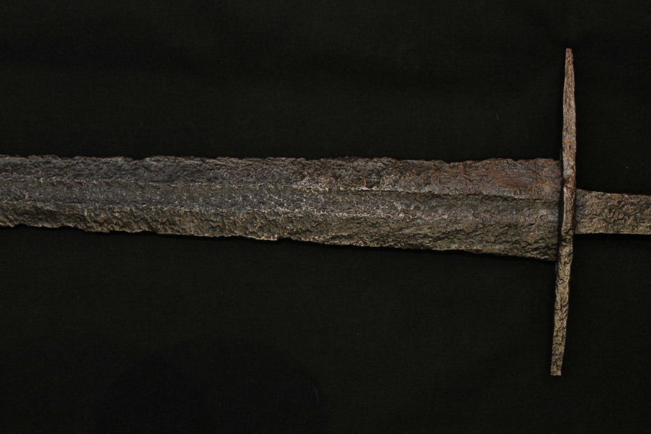

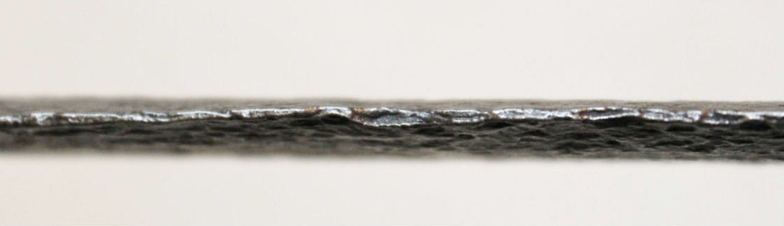

I'd call it an early XVI, XIV's generally have more strongly curved guards and the diamond section at the point helps confirm that IMO. A chunky tang can move more of the sword's overall weight into the hand which can improve handling, in this case that's probably counteracted somewhat by the seemingly largish pommel but Gadjos said it felt well balanced so perhaps it's just right for what it is. Overall it looks plausible to me.

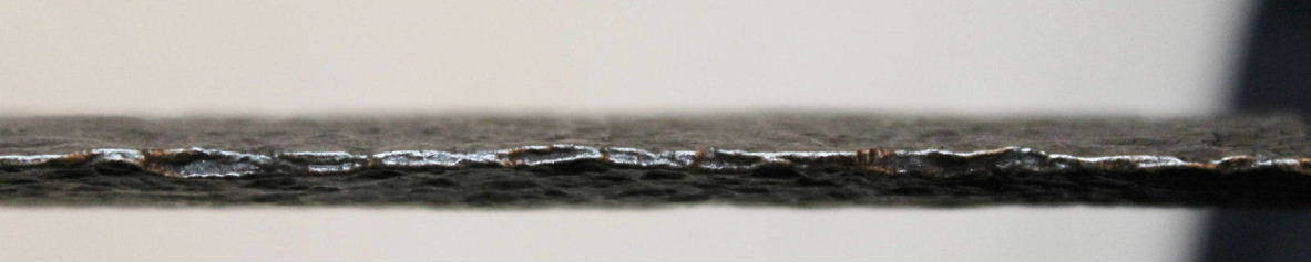

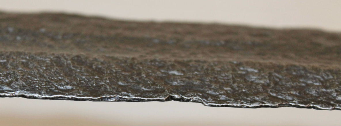

Gadjos, any chance we can have an edge-on pic of the whole sword so we can see the distal taper?
Where is the point of balance at?

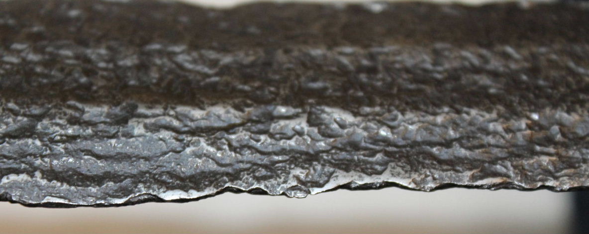

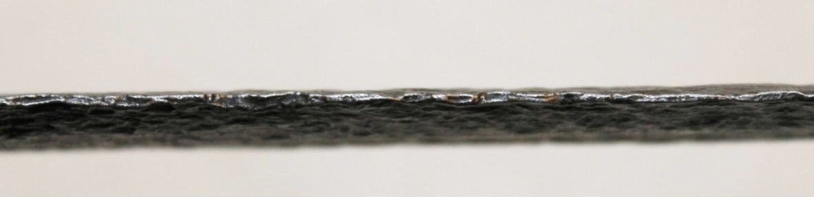

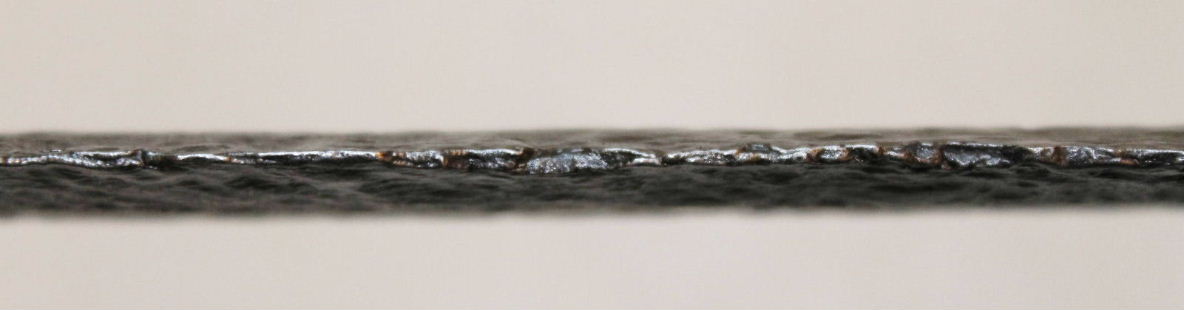

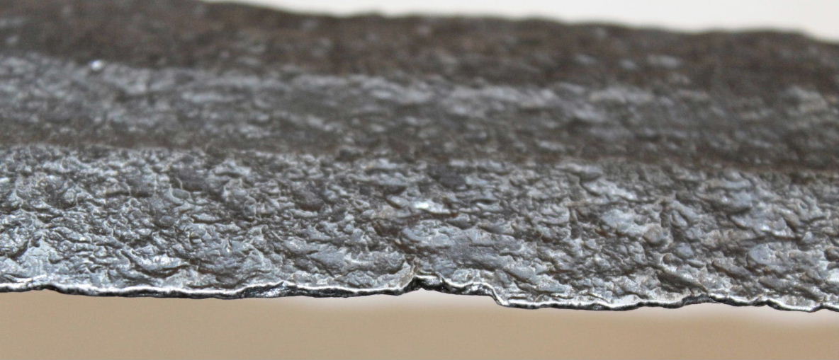

PostPosted: Tue 13 Jan, 2015 11:53 pm    Post subject: more pictures         Reply with quote
Thank you for all the replies,

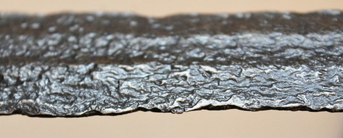

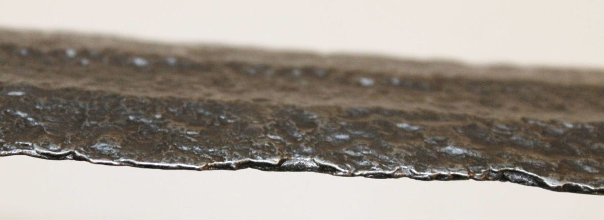

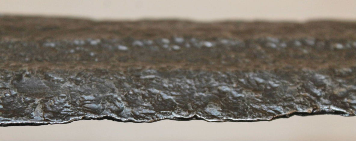

I will upload more pictures from the edge, there is a size limit but hopefuly the pictures are good enough, tried my best.
The balance point is about 5.6 inch from the cross bar, it is between the average 3-6 inch limit and I guess this is why the pommel and tang is so sturdy, otherwise the balance point would be higher up on the blade making it point heavy.
The tang starts with 2.6 cm width but at the pommel it is 2.1cm, so narrows down 5mm, so it is not completely parallel, but you are right, as far I can seen all european swords of this type has some differences and I think there is even more pommel type then noted down, since some only portrayed on statues or paintings and they noted ones have many varieties as well, of course this is my own mind.
"In japanese swords a certain age has a notable characteristic but they all differ and easily notable for an experienced eye, many many varieties, so many features that has many combinations, this is why an unsigned blade van be easily identified which smith family, which style, what province it was made in, and in most cases even the certain smith can be pinpointed out (and there were thousands), the cutting edge was also often measured to the warrior's dimensions or altered down, this is why the tang has more tang holes, due to multiple alterations."
On the pictures you can see that several layers are on each other, on the tip I noticed 2 small lose outside crack, in the middle and on the left side, I often see this in case of old japanese swords but not sure if it is the same thing, I am only knowledgable in japanese blades, not european but there are still similarities.

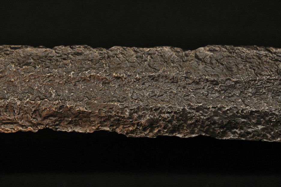

PostPosted: Tue 13 Jan, 2015 11:57 pm    Post subject:         Reply with quote
some more pictures...
By the way, would it help if I post pictures of the other sword I have from the same source?
Since than I noticed the lady sold some other swords and daggers from the 18th century up to ww2, they all seem genuine, I think it was a good collection and even if my swords are turn out to be fakes they deceived the previous collector as well.
 Attachment: 101.04 KB

PostPosted: Wed 14 Jan, 2015 10:46 am    Post subject:         Reply with quote
It may be an effect of corrosion, but the pommel looks as though it thickens near the top, or each of the large faces bears some slight overall concavity. It also appears that the 'corners' of the pommel may have been slightly higher than the top face, which would be interesting, if real. The tip portion of the blade looks oddly truncated or foreshortened to me, and the sheen on the overall patina also strikes me as a bit odd. That said, both the pommel and cross bear seem to bear some striking similarities to the carved counterparts in the posts above. Does the cross move? Can the blade shoulders be inspected at all?
That one definitely falls in the 'N' family. The one that resembles the current sword goes with Count Dietmar von Selbold as shown above. Isn't that at Naumburg as well?

PostPosted: Wed 14 Jan, 2015 12:28 pm    Post subject:         Reply with quote
The sword is covered with some kind of wax that gives its shiny look, I guess it is some kind or preservation wax, there is a small ding on the tip with about 1-2mm folding back at the very end, I guess this is the weakest point and easier corroded but I see no alteration there. Yes, it does seem the corners are a bit higher then the rest of the top of the pommel, and the pommel gets thicker going upward. The cross bar does not move.
