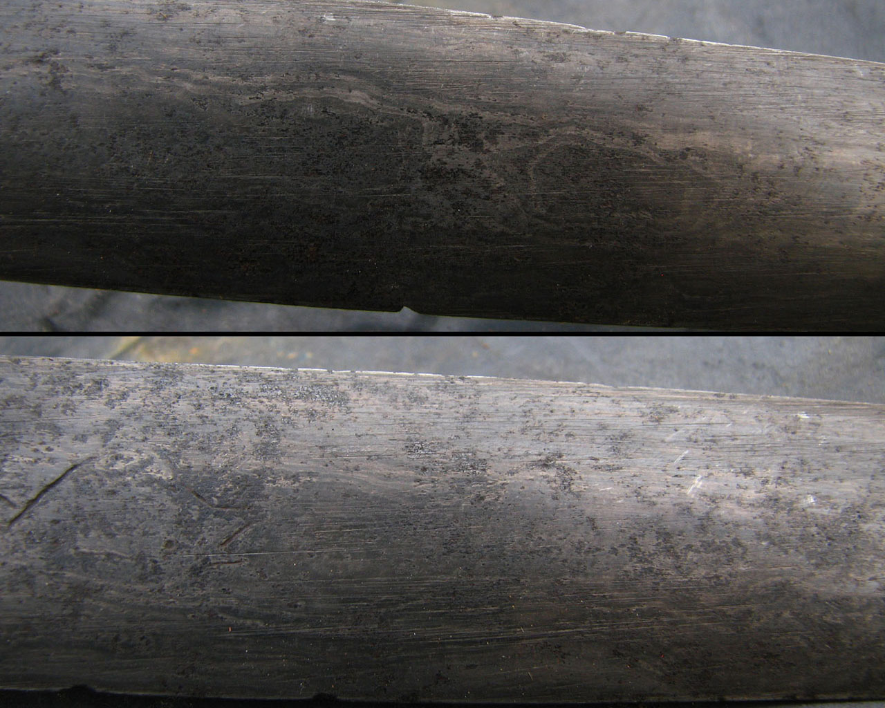

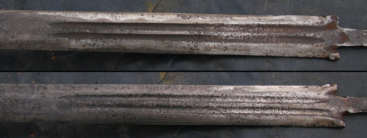

today i made small investigation. i want to show you its effect. these are two blades. first is any 17-18th century blade, other one is andrea ferrara blade from the mortuary broadsword.
1. blade looks solid steel(or two layers the same hard steel) with the soft steel tang connected in the line "/" it is construction similar to rapiers from attached document but connection with the soft steel is simpler.
2. blade is layered construction of medium and hard steel(it has about 15 layers) and its interlocked with layers of soft steel near the tang. soft layers form one side are going to the end of the fullers, from other side are finished in the middle of them.
