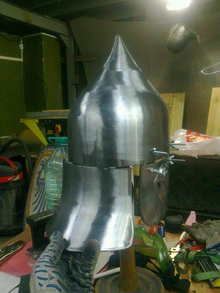

Well, my HMB practice helmet is 3mm mild. The faceplate (not historical, but Mamluks and Turks only wore bar nasals on Chichaks) is 2mm. I have a bar nasal for it as well.
It hasn't been hit yet (it's still being assembled), but my HMB club insists on testing helmets with a heavy axe before allowing them. They're all power-lifting martial arts guys, so there WILL be a dent, no matter how thick it is. I'll put up a pic when it gets tested.
The important thing to mention about it is that it weighs about 6kg, and close to 7kg... Quite a bit more than the 3-weapon masks and Kendo men I'm used to, and some of those historical ones must have weighed even more. That was my idea, to have a heavy practice armour ... my bazubands/mittens (inspired by the Stibbert Krug) are 2.5mm tempered spring and are 2.5+kg each as well..
To have weight like that in an actual fight would be some seriously hard-work though, and, on the head in particular, a bit of a hindrance to great balance without a lot of practice. So extra respect to those guys who wore these things into a pitched battle!
Here's photos. The screws are obviously to show how it'll look all assembled. :cool: It has been made by Edward Shaykhutdinov from Tatarstan. The guy's amazing, look him up on facebook.
 Attachment: 94.08 KB
 Attachment: 80.77 KB
