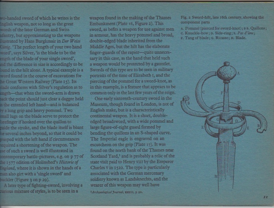

Here's the promised photos. They used this sword as a model to introduce hilt nomenclature, and so I've included the drawing of the hilt along with the photo. It show some details that aren't visible in the photograph.
The pommels have holes in them, apparently for a sword knot, but what I don't know is if the pommels are solid or hollow.

I think that the shells on the RA sword are later additions, because if you compare the RA sword with the excavated example, you'll note that the blades are virtually identical, yet the excavated sword doesn't have the shells, and doesn't have any indication that it ever had shells.
Given the similarity of the RA and the excavated sword, I have wondered if we're looking at a military sword "pattern". Pattern is in quotes because this is obviously way before anyone was designing swords dictated by government patterns. However, in England, those responsible for raising regiments would go to a specific cutler and have him make up a group of similar swords with which to arm the troops. Are these swords relics of a particular regiment?
While one can find essentially similar hilts from Europe, these hilts with the lack of lower rings and the "bite" out of the quillons are an English style. Interestingly, this quillon treatment is also seen on some English baskethilts of the 15-1600s, and the London Museum has a largish left hand dagger with these quillons as well ( I just remembered: I think that Claude Blair's book, "European and American Arms" has a photo of the dagger). The dagger also has a pommel shape that matches that of the sword that's the subject of this thread: was the dagger made to match a sword like this? Were they perhaps sold as a set?
