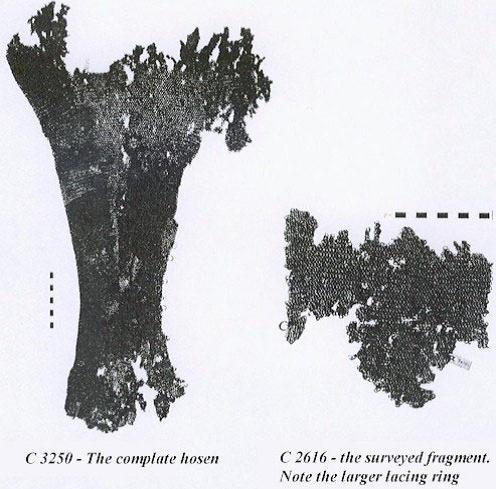

Last year Mac alerted us to a Vegard Vike article which may document an existing mail chausse, previously mis-identified as a sleeve, C 3250 has large "lacing rings" covered by a mail fly, but may be of a later 15th century date. If the dating is correct, even "enclosed" chausses might actually be closed by lacing.
http://www.kernaud.net/pub/Maille/ringweave.pdf
http://folk.uio.no/vegardav/brynje/Ring_Weave...fsson).pdf (cached)
The hosen (C 3250) show a split in the legpart, along the edges of the split there are several sets of lacing rings. These are of double size compared to the largest rings in the weave and they are riveted. The surveyed fragment (C 2616) had such lacing rings fastened by the edge and it is therefore most probable that it is a part of the other hosen in a pair with C 3250. The better-preserved hosen is designed for a left leg, at least if one interprets the lacing as running on the back of the leg. If that is a correct assumption, fragment C 2616 will have been part of the right hosen.
If you read the article, you might see why I think they're inside out and the other way 'round.

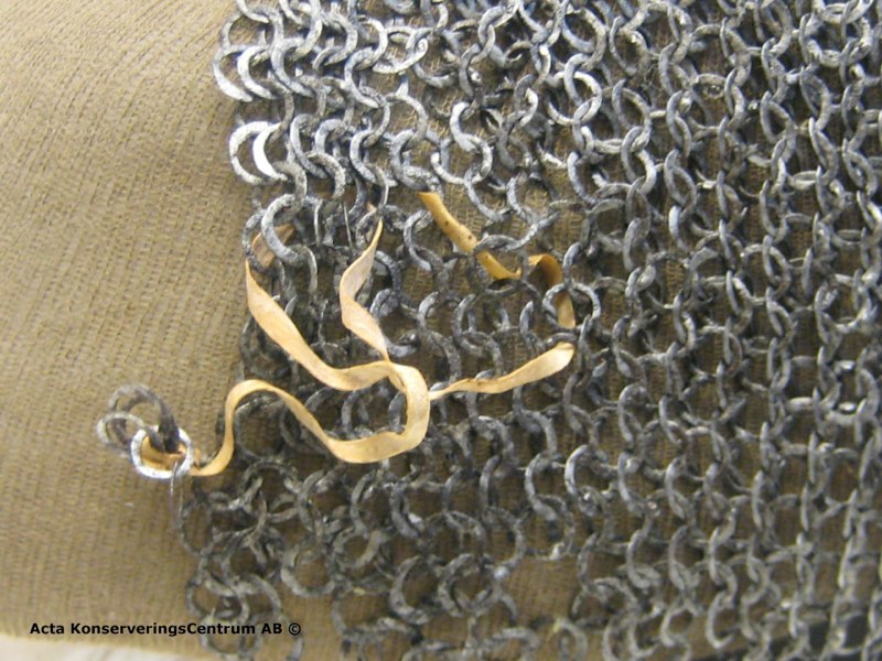

Finally, there are the extant flat thongs from the Tofta coif, which were described as rawhide, IIRC.
 Attachment: 135.35 KB

So I guess leather tie will be the best thing to go for to tie them on. I was going to try jute cord but leather would probably be tougher and less likely to fail (as well as not split apart). All I have currently is a suede tie which I KNOW isn't period and it also snaps quite easily. Does anyone know where I could get deerskin cord thats not sueded or the next best thing? I'd prefer either oak tanned or vegetable tanned leather cord as thats closest to period lace.

PostPosted: Sun 05 May, 2013 9:31 pm    Post subject:         Quote
A simple Google search for deerskin laces turn up a number of vendors. Here's a couple.
http://www.leathercordusa.com/mm5/merchant.mv...ry_Code=DS
http://www.coloradoleathergoods.com/Laces,%20Sinew,%20Thread.htm
