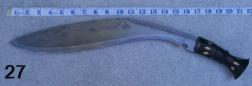

A little while back I purchased the Windlass " Gigantic Ceremonial Kukri " at the very least out of curiosity.
Windlass is the official maker of Kukris for the Gurkha regiments so whatever the qualities of this Gigantic Kukri I suspect that the steel and heat treat matches the military standards.
Here at Kult of Athena are the basic statistics and a few pics in addition to the ones posted at the end of this Topic by me:
http://www.kultofathena.com/product.asp?item=...nial+Kukri
The price is a bargain and it is put together very well, I don't know what hard wood they use for the handle but it might be teak which is available in India ?
Well, first impressions: " IT HUGE ", much bigger than it looks in pics because the handle is much too oversized for a comfortable grip unless one has a hand the size of a gorilla.
It really looks as if someone had taken the blueprints for a normal sized kukri and had just photocopied it at 175 % or 200% and not just increased the scale of the blade but also the scale of the handle. Eek! WTF?! Laughing Out Loud
Now the above 2" diameter of the handle is the only negative I see assuming that one can handle the weight of the piece if one wanted to use it ....... tree chopping or " Zombie Killing. Wink Laughing Out Loud But overall I really like it and I took pics as received without modification but I intend to slim down the handle reducing it's diameter and making it oval in the fat middle rather than round. Oh, two handed one can handle it fairly well by the way.
The edge is sort of butter knife sharp on the wide belly and positive curved part of the blade but very unsharpened in the negatively curved and narrow section closest to the hilt: I intend to sharpen the edge with a variable geometry where the secondary bevel would be very obtuse in the narrow section and very sharp in the belly. The narrow section really doesn't need to be very sharp or even sharp at all in my opinion.
Just using a diamond hone I can tell by feel that the heat treat is at least as hard as most Windlass swords or knives: Something in the high 40's r.c to low 50's r.c.
I will probably refinish the blade using the lemon juice/mustard method to etch the surface to give it an aged but well cared for sating finish with some surface activity.
By the way in the pics I included a Coldsteel CarbonV Kukri that has the kind of finish I'm talking about, and also to show the scale of this Gigantic Kukri next to a normal one. I also have a Windlass Dresden left hand dagger with a blued finish to also show scale in some of the pics as well as pics of my hand holding the Gigantic Kukri and next to it.
If and when I refinish this one I will post pics of the DIY project where I will have slimmed down the handle, maybe carved it a bit, and sharpened the blade.
Oh, the Kukri also come with a very good scabbard for it.

PostPosted: Tue 02 Oct, 2012 5:22 pm    Post subject:         Reply with quote
More pics of size comparison with hand on the handle and next to the handle.

Here's my giant "ceremonial" kukri (the brass handled one). These are also described as "sacrificial" kukri, being used for killing animals for sacrifice (also for non-sacrificial slaughter). This is is modern and more properly described as as tourist kukri than ceremonial or sacrificial. It's substantially shorter than yours, but still monstrously heavy (for the size).
You can get larger ones, too, like this one. The Nepalese-made ones, if one chooses a traditional style, are much more in the style of old kukris than the Windlass ones (or other modern Indian-made kukris).
Also a modern design that's the length of yours, but much, much lighter. Shown compared with a wakizashi and a tiny kukri.
The last one is an old (i.e., not a modern tourist one) big kukri, pre-WW2, 760g.
(More kukris here!)

PostPosted: Mon 19 Nov, 2012 6:53 pm    Post subject:         Reply with quote
Well I did some work on the handle tonight and thinned it down to a comfortable cross section.
The wood seems reasonably hard but easy enough to carve and didn't give me any problems.
Finished the basic reshaping and it now feels like a very heavy weapon with enormous presence, but that is not a surprise, but it's now at least wieldable when before is was like holding a bowling ball i.e. one of the large type but without the finger holes !
Kept the shape similar and made it slightly oval in section. You can see a step down from the diameter of the front bolster/guard.
It would actually be usable with both hands. The wood is unfinished at this time and I still have to do a wood burning " Zombie " logo similar to the one on the Zombie Slayer sword scabbard and I might do some metal " aging " later.
Zombie Slayer DIY project for context: http://www.myArmoury.com/talk/viewtopic.php?t...highlight=
If and when I do more work on it I'll post more pics
Refer to the top of this Topic for the " before " pics " for comparison to the " after " pics below.

PostPosted: Tue 20 Nov, 2012 10:54 am    Post subject:         Reply with quote
Ken Speed wrote:
Jean removed a LOT of wood and I think the dimensions of the handle look much more human scaled now although I am still startled when I see how much of the butt end of the handle protrudes from Jean's hand no to mention the size of the butt end. I imagine that the butt is now even more like the knob on the end of a baseball bat or axe handle and would aid in making an axe type two handed cut. I imagine a hard two handed cut with that kukri would feel somewhat like splitting wood.
I didn't remove as much from the butt end of the handle ( None at all at the very end next to the butt plate ), but the grooves or risers where reshaped and ended up being also smaller in diameter. The flared butt is a lot like a wide sword pommel and if one ;lets the hand slide on the handle the flaring helps in securing one's grip.
It is also a good place to put the second hand for a two handed hold: One would have to almost invent or adapt longsword techniques for a unique fighting style: Although massive it is relatively to a longsword short blades, but it's mass should be able to displace another's blade easily and very hard to deflect.
Might even be good against a pole arm after and initial bind and defective blow followed up by closing in ......
Well, I always tend to at least imagine how I would tactically use just about anything in my hands from this Kukri to even a shovel when clearing snow or even an umbrella. Wink Razz Laughing Out Loud[/u]

PostPosted: Thu 22 Nov, 2012 9:50 am    Post subject:         Reply with quote
Looks good Jean!
I have a few myself:
