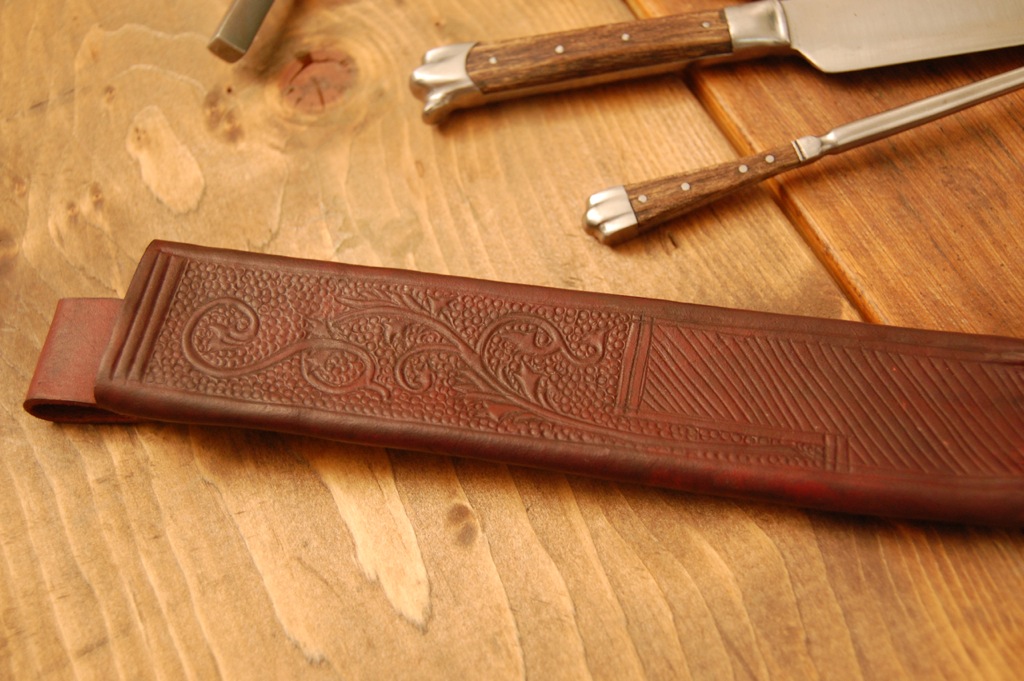

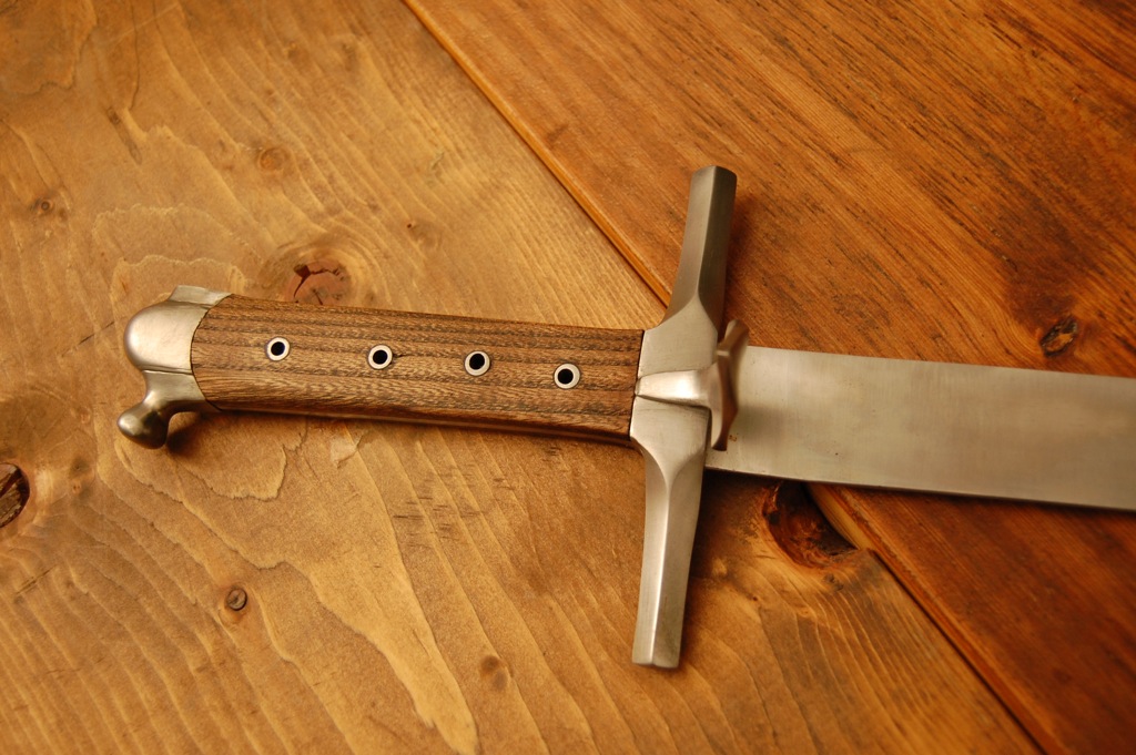

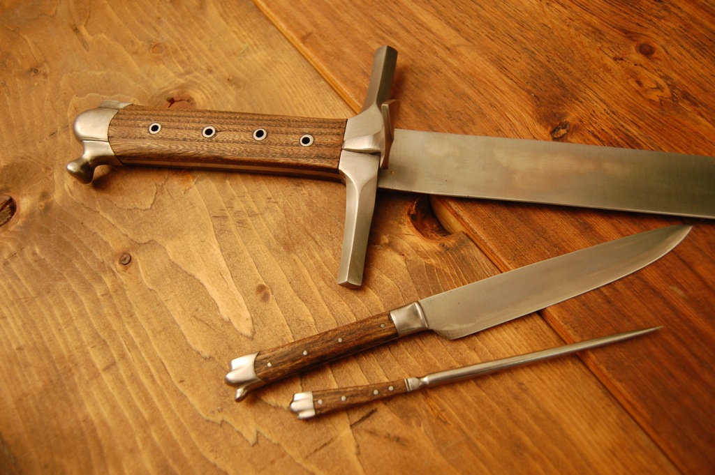

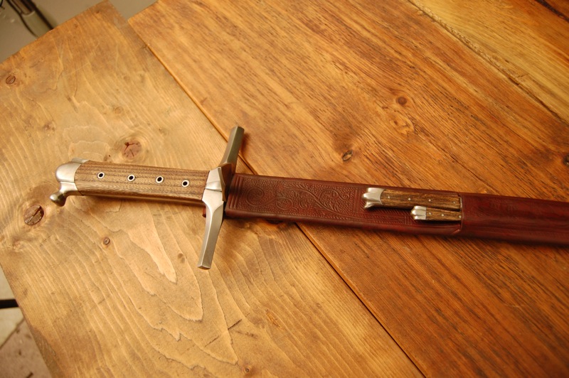

Hello all,
Here is another finally finished piece after a couple years sitting in the pile of "projects in process"

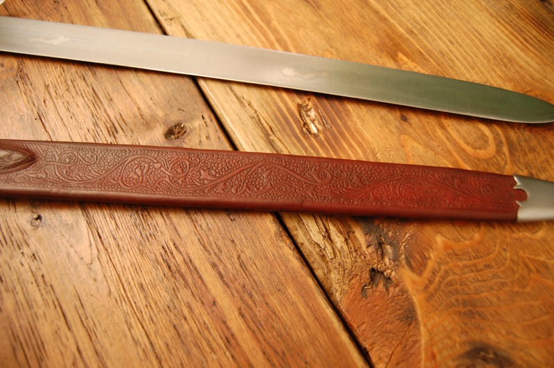

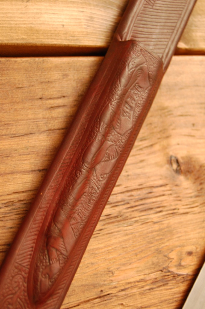

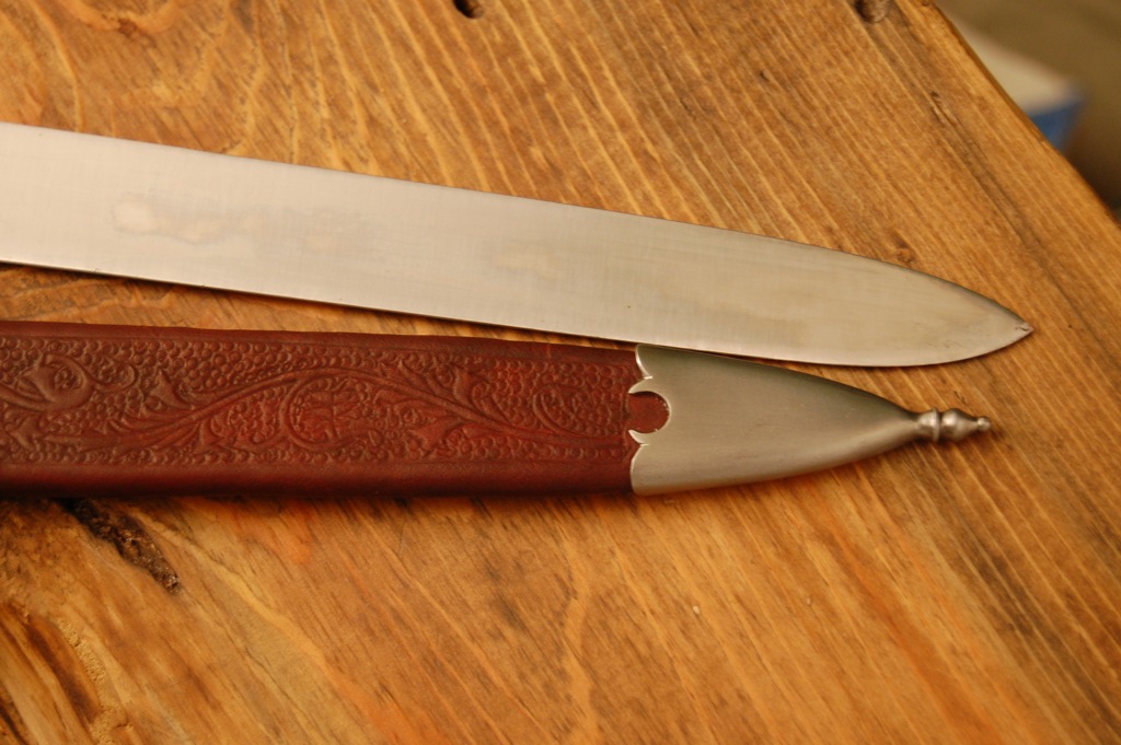

The messer is based on an example I stumbled upon in an auction house in Augsburg, Germany...however sadly it was not for sale and only a display piece. The by-knife and pick are made to match the messer but were not included in the display. The messer is hollow-ground and 24 1/4 inches long with the balance point around 2 inches, and the scabbard is constructed of two layers of leather. The technique used on the scabbard was an experiment in a more medieval approach of tooling leather. The technique I used was simply a warm sharply beveled dull knife on damp leather with a simple circle punch used for the back ground. I did not use any hammers in the detailing and it was done with a propane torch to keep the heat to the point just before the water would sizzle. Also the tooling of the scabbard was done post construction in trying to keep with the medieval process. I will post some pictures of the tools when I get back to the workshop but here it is...
For more projects and contact info you can now check out my site:
www.davisreproductions.com
 Attachment: 151.79 KB
 Attachment: 155.94 KB
 Attachment: 214.03 KB
 Attachment: 215.8 KB
 Attachment: 206.43 KB
 Attachment: 196.52 KB
 Attachment: 159.67 KB
 Attachment: 181.9 KB
Stefan Hanson
Location: stockholm sweden
Joined: 10 Jan 2007
Posts: 20
PostPosted: Wed 31 Oct, 2012 7:51 am    Post subject: nicely tooled tool         Reply with quote
That is a beauty Josh ! Very convincing 15th century ! Is there a source for working the leather damp with a heated tool ?Would love to indulge in this. I know my friend Martin Siennecki, the foremost leather worker in the 15th century re-enactment community used a heated needle on one of his scabbards with a fine sculpted result. Why did you chosse to have no wood in the scabbard at all ? Will it be sturdy enough ? FINE work !

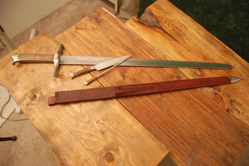

Here are the measurements of the blade and complete sword:
Overall Length: 30.5 inches
Overall Weight: 642 grams
Grip length including pommel and cross: 6 3/8 inches
Cross width: 5 inches Thickness: 5/8 inches
Pommel width: 1 1/2inches Thickness: 3/4 inches
Blade thickness: 3/16 inches
Blade width at cross: 1 1/4 inches taper to 3/4 inches an inch from the tip
And here is the overall shot I have.
I will also address the leather tooling questions in another post where I will break down my process and include my sources.
Josh

Wow, I find it interesting that the spine of the blade is so thin considering the hollow-ground blade geometry. It must have a simply wicked thin edge. I really love everything about it, that is my kind of weapon. Thank you for the dimensions.
