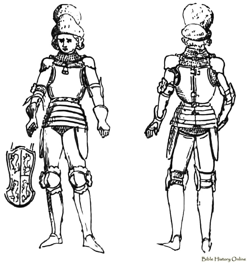

My group is portraying 1415, the early 15th century. There seemed to be a great deal of different styles with that era too, we are trying to portray all the different examples of armour.
Im not sure why more people don't experiment with the different styles..perhaps cuz most armourers don't. Just stick within there comfort zone.
Also could contribute to people not really doing there research. I'v met many people who choose a period and get whatever comes to mind, not at all looking through the art or surviving examples.
-Reece
 Attachment: 59.99 KB
Where I based my cuirass
 Attachment: 81.48 KB
My cuirass I made. Notice I have the "saloon door" styled back plates [ Download ]

Very nice, Reece, do the two backplates overlap on the spine? I am in the process of planning a new cuirass for eastern european style buhurd. It would be crucial to protect the backbone there.

@Reece Nelson:
I doubt that an armour in the early 15th century had such back plates which you described as "saloon door like". Seems also that you had used hinges at the sides.
The system was much simpler, see the following video: https://www.youtube.com/watch?v=-y4j4QhU2nI&list=PLA576F7A4BB0D2D17&index=17&feature=plpp_video (or search on youtube for Die Sendung mit der Maus - Ritterrüstung ). If there is a need I can make a short summary of the comment.
What's the origin of the picture which you had posted?

PostPosted: Thu 12 Jul, 2012 6:24 pm    Post subject: 14century reproduction armour         Quote
@ Michael
The back plates that are dipicted in the art show a line going down the middle with straps going across the back, joining the plates together. This image is from France and there are several more images that show these type of "salloon" styled back plates. Also I plan to adject the hinges for the inside of the curaiss, to prevent from any fabric or mail to catch on them. The video you showed was of a 16th century styled harness...during the early 15th centuries were you start see fully covered back plates ( haven't documented to see them in the 14th century yet, still looking)
During the early 15 centuries you see a lot of man at arms and knights not wear a jupon over their chest, so you will see a lot more detail on the armour.

Another depiction of a center-opening backplate in the early 15th century:

PostPosted: Fri 13 Jul, 2012 7:45 pm    Post subject:         Quote
Hmm, such a kind of armour we have never seen. :cool:
Is the drawing a picture from the Chronicles of Jean Froissart (about 1337~ 1405) where he had described the first years of the Hundred Years War between France and Great Britain?
Or exists other sources with such armours? Then some links would be nice. :)
@ Josh
This is a picture of the statue of St. Georg as he kills a dragon: http://www.combatmedieval.com/mitaines-armure-saint-georges/ . See more here: http://en.wikipedia.org/wiki/Saint_George
I don't know how realistic such a statue is, presumable not. Surely it's not a picture of a knight. The part of the back plate could be also a part of a cross or a scabbard for a sword or a long knife.

PostPosted: Sat 14 Jul, 2012 6:18 am    Post subject:         Quote
Ah yes, now I see it. :eek:
The picture of bible-history.com is the only source (and only available in the english spoken corner of the Internet) which shows both parts (front & rear) of an armour which William VI of Holland / William II of Bayern-Straubing used. The site name this armour as a dutch armour, perhaps this kind of armour was produced only in this region.
The statue of St. George was also made by artists of Flanders (today it's a part of Belgium, Holland itself is a part of the Netherlands) in the same era. So the flanders artists used a dutch armour for the statue.
The pictures of Jean Froissart's Chronicles then also shows soldiers in dutch armours (together with french and english knights / soldiers). Perhaps these soldiers where mercenaries from this part of Flanders which belonged to France. Froissat lived prevailing also in this region. If the posted drawing is from Froissart then the dutch armours exists some decades.
But I don't know where the knight on the stone frieze is.
So Reece's cuirass is authentic - and we should visit our National Library to expand our knowledges. Such a big Black Hole is really painful. :cry:
