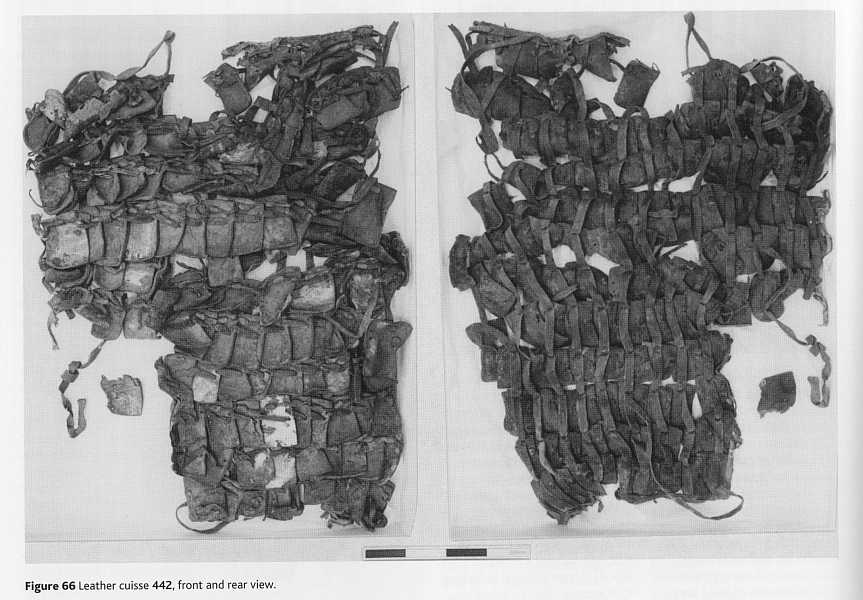

PostPosted: Wed 15 Feb, 2012 11:01 am    Post subject:         Quote
Sean Manning wrote:
There is no evidence for Roman leather armour at all, except for a leather scale cuisse from Dura Europos and a few sculptures which seem to show floppy breastplates. I think the idea of leather lorica segmentata comes from old movies which couldn't afford metal armour for everyone, or possibly very old books on armour from before there were any excavated metal loricae segmentatae. Bishop and Coulston is a good reference for issues like this.
Are there any pictures of that cuisse online?

PostPosted: Wed 15 Feb, 2012 2:13 pm    Post subject:         Quote
Wilhelm S. wrote:
See attachment.

Wilhelm S.
Joined: 09 Jun 2011
Posts: 53
PostPosted: Wed 15 Feb, 2012 6:47 pm    Post subject:         Quote
Matthew Bunker wrote:
Wilhelm S. wrote:
See attachment.
Thank you. I will start cutting pieces this weekend.
