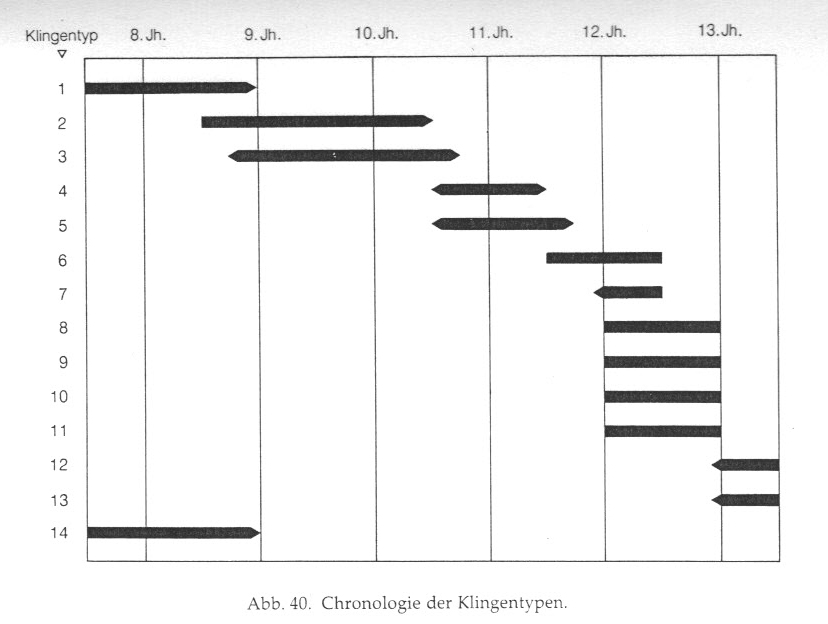

Posted: Thu 23 Jun, 2011 12:06 pm Post subject: |
Attached you'll find a scan of Geibig page 151 with an overview of his hilt types with chronology.
Two pages further, there is an overview of his blade types with chronology, so I've attached that one as well. ;)
Because his work is very, very thorough, it is not so easy to fully grasp. And I must admit to not really having had the time to really go into depth with it.
Both images copyright Alfred Geibig / Karl Wachholz Verlag, 1991. I hope it's ok to post them here, in an unaltered state. Otherwise, please let me know, then I'll delete them.
Attachment: 126.78 KB
Attachment: 112.61 KB
J.D. Crawford
Posted: Thu 23 Jun, 2011 1:56 pm Post subject: |
Thanks for the images. If I'm reading this right, he puts his type 12 pommel (similar to Oakeshott's B) from 950-1100, and type 15 (similar to Oakeshott's A) from 1050-1275. Right? That sounds right to me.

Luka Borscak
Posted: Mon 27 Jun, 2011 4:06 pm Post subject: |
| J.D. Crawford wrote: | | Thanks for the images. If I'm reading this right, he puts his type 12 pommel (similar to Oakeshott's B) from 950-1100, and type 15 (similar to Oakeshott's A) from 1050-1275. Right? That sounds right to me. |
I interpreted it as 950-1175, if the first column is 8th century, and last one is 13th century...
