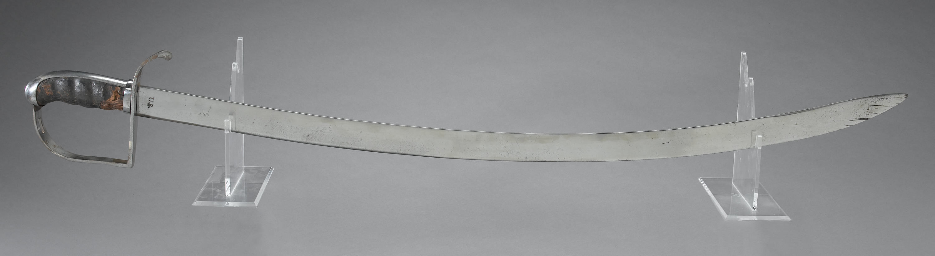

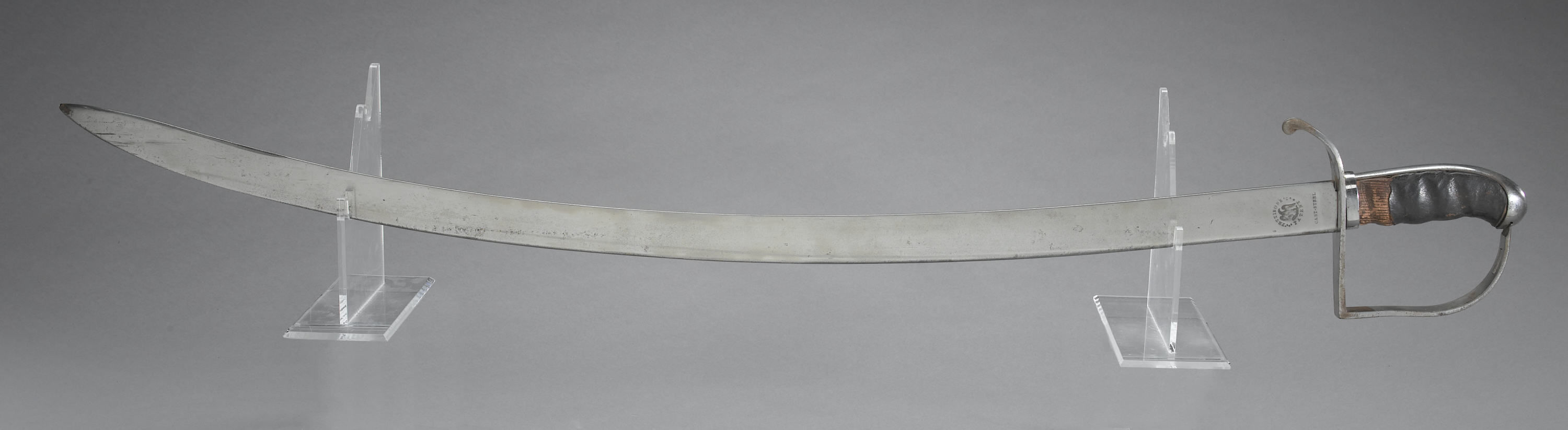

This is an early American saber made by Nathan Starr of Connecticut. He and his son Nathan Jr were the leading sword makers in America until 1830 when they stopped making swords and gave up the US military contract to Ames. They made roughly 2000 swords of this and later styles.
This is one of the more early swords by them. They started making swords in 1798. The later swords have more pronounced curves in the blades.
One reference says that they were the first production sword company in America. Making this and other swords by them a true part of US history and well worth sharing with you all.
The sword has seen some improper 'cleaning' but is still quite sturdy. Not sure how long it will be in our hands but we wanted to share.
Blade length is 33.75"
POB is 8.25" from hilt
Small fuller up the spine that ends 6.75" from the tip
fuller width is about .25"
blade width at shoulder 1.5"
blade width just before point 1.25"
distal taper is from 1/4" - 1/8"
It has a slight false edge and the point is rounded about the same as a quarter
The hilt looks to me to be iron as it looks much like old wrought. The handle is wood and spiral fluted with leather over. There is 2 small pieces of brass wire at the top of the hilt making it obvious that the flutes once had brass wire inlayed.
Here you can see the top of th end cap is brazed on with brass.

Thanks for sharing Matt
I think you may be misreading the reference mentioned, as the elder had been producing swords before the 1798 contract. That contract is listed as a run of 2000 but to keep it in better context, Abel Buell of Hartford received a US contract in 1798 for 1000 of the same pattern. In a different context perhaps all the work in in PA including Prahl's contract for 1000 horsemans sabres in 1776 and another smaller contract in 1781. Sword making was full tilt after the war of independence and many thousands of swords produced before the 1798 contracts. The Starr family US contracts were well over 30,000 edged weapons by the end of the 1812 conflict Nathan the elder had been a militia armourer during the revolution, as were others across the colonies. The & Co was Nathan's partners Francis and his son Wilbert Sage.

Ah Glen! I was hoping to hear from you on this. Thanks for sharing. I was thinking of posting this at SFI for others to see.
Thanks for the info my friend. I have held many swords with great history but this one somehow hit home for me. Being a family of smiths and US makers and all. Nice that there is so much info out there on the Starrs. I honestly had only done about 20 mins of research befor posting this so it was nice hearing what you had to say.
Thanks a bunch. Hope you enjoy seeing this. Shame someone had to try and "Clean it up" with a dremmel but it is still a nice piece of US history.

The Nathan Starr & Co. that is printed on the Forte of the blade seems awfully modern in its script. I have a M.1818 N. Starr Cavalry sword and the markings are quite different. Just curious....
inkothemgard!
Glen A Cleeton
Posted: Fri 28 Jan, 2011 7:36 am Post subject: |
HI Morgan
The mark is perhaps not like you might see on some old swords, or not the same font/size as the later Starr marks. Take a look at the 1798 pictured in David Radcliffe's article linked above and compare that to the images above. The same as others I have seen, including in the article. What is your suspicion? An aged reproduction? Have you looked at other examples of the earlier mark? I know the nco spadroon has been reproduced but the signs are obvious, while still troubling for a novice collector.

| Morgan Butler wrote: | | The Nathan Starr & Co. that is printed on the Forte of the blade seems awfully modern in its script. I have a M.1818 N. Starr Cavalry sword and the markings are quite different. Just curious.... |
I will have to search for a link but i found some recently sold pieces that had the mark just as this piece does. I dont think it is a fake.

First of all, Nice NCO sword Glen! 2nd, my comment on the script was pretty much what I wrote. I have never seen markings like that on a Starr sword. The script looked very modern to me, especially with the ampersand. I was just curious is all. The markings on your NCO pics is what I am more familiar with and is what is stamped into mine as well. I cant really say much more than that. Not to say that it is a fake. Perhaps who ever owned the sword years later, put that on the blade. By the by, here's a pic of my Starr Sword. I love saying "Starr Sword" by the way.

| Quote: | | I cant really say much more than that. Not to say that it is a fake. Perhaps who ever owned the sword years later, put that on the blade. |
Do you own a copy of Peterson? While I do have other book examples of the 1798 Starr, Peterson relates in his simple Starr family bio regarding W Starr & Co. The 1798 saber was the only sword produced by this firm. That should put matters in a little better context for you,. You might note the younger Sage son Wilbert inspecting swords (hence the oft found WS mark).Further expanded in Peterson in sword "20" is the fuller explanation of the blade mark exactly as shown in examples apparently unknown to some As you seem to indicate).
Bezdek the mighty compiler has quite a bit more information on the Starr family in his 1812 title.and if that period of the war of 1812 war both prior and after, it is a book to hold indispensable as so much data found in one place. All of the information is found in other texts and Dick Bezdek usually acknowledges his sources but all in one place with leads to other research, invaluable. Be that as it may Morgan, if you don't own the Peterson title, you may forever overlook what is well noted and not hard to find.

This is a good 1798 Starr saber, no faults with it other than someone took a grinder to the hilt and a good part of the blade. Shame.
