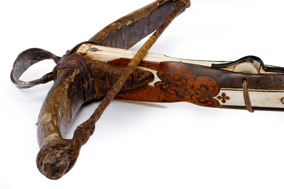

I did a bit of looking and found a few, later crossbows that have bolt clips - I can't seem to find earlier ones though, nor anything on their disadvantages (if any). Could anyone offer some insight on the subject? As a note, I am looking for information on disadvantages to the bolt clip more so than if it's strictly historically accurate, though that is welcome as well.
 Attachment: 24.48 KB
German, 1730
 Attachment: 146.77 KB
Close-up of ivory bow, and what appears to be a bolt clip at the top, Unknown provenance/period
 Attachment: 240.07 KB
German, 1475 [ Download ]

As Randall and Addison point out later in this thread bolt clips were not really around until about 1500/1520 or so, so really they would be innappropriate for the 15thC which is where this bow fits. I will not argue that a bolt clip is a handy addition to a bow, but it does depend on how historically pure you want to be.
If the bolt is well fitted to the nut or lightly wedged in with a slip of cloth etc they can be pointed down, it is also possible to hold the bolt down with your left thumb just in front of the nut and let the string skid under your thumb ( courage is required but generally not pain killers). Both methods allow you to hold a bolt in place without a clip.
Addison - caution. The bolt clip will need to swivel out of the way for the goats foot lever to operate so use only one fixing point and you are better off with a screw or a bolt (both OK historically if you use a slot head) as a nail is likely to loosen. The trigger mechanism passes right under where you need to fix the clip, so keep the fixings shallow to about 3/8" or so. Finally it is better to have a clip that flexes and though a nice bit of forging, I think this should allow for flex more. I have seen them made in thin sheet steel, so you could kill a hacksaw blade. Failing that I could send you a horn one.
As regards any negative points to a bolt clip? They slow the reload slightly and as any museum collection will testify, you will break it off at some point due to accident. On the plus side, they hold the bolt in place if you are shooting down or moving about and they look pretty.

Thanks very much Tod, this is exactly what I wanted to know. Also thank you for pointing out the fact that it needs to swivel - I hadn't considered that but I now see the problem. I will see how things go without a clip, and if I still feel it's necessary after actually using the bow, perhaps I'll make another.
