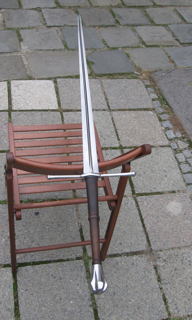

Hello ,
I finished long sword.
The sword is made from spring steel.
Length of blade 100cm, length of handle 33cm, width of blade (at the cross quard) - 4.5cm.The balance point 3.5cm from cross quard. Weight 1625g.Hardened cca 55HRc
The pommel and cros quard are riveted. The handle is made from wood + covered with leather.
all best Stanislav

PostPosted: Sun 17 Oct, 2010 11:59 am    Post subject:         Reply with quote
Does the fuller extend to the tip of the blade? If so, it's a strange feature. Or does it only look so on the images?

PostPosted: Sun 17 Oct, 2010 12:05 pm    Post subject:         Reply with quote
I really like the look of the first sword, very well done!
I'm also interested in details about fuller(?) in those swords, looks definitely uncommon.
Are those two sharps, anyway, or 'safe' pieces?

PostPosted: Sun 17 Oct, 2010 12:08 pm    Post subject:         Reply with quote
It is a ridge isn´t it not a fuller!

PostPosted: Sun 17 Oct, 2010 12:44 pm    Post subject:         Reply with quote
Hello,
I makeing the blade according to originals blade.
The blade with this profil is light but, it is stiff.
The sword are not sharps and are for training. The edge is cca2.0mm
All best St.

PostPosted: Sun 17 Oct, 2010 12:50 pm    Post subject:         Reply with quote
That's interesting.
Anyone know how blades with such a ridge, like in Stanislav's sword, fall into the Oakeshott typology ?

PostPosted: Sun 17 Oct, 2010 1:29 pm    Post subject:         Reply with quote
That's interesting.
XVa? XVII?
XV/XVa or one of the XVIII's. Type XVII would not fit as they have a hexagonal section.
