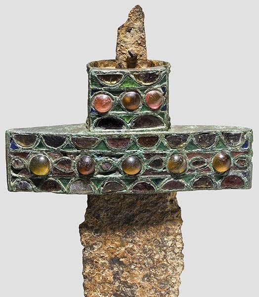

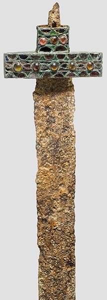

I was recently searching the internet and came across this page: http://www.royalathena.com/PAGES/MigrationMed...L0901.html depicting a migration period sword that seems unlike any of this period I have ever seen. Based on the museum display cited on the page I would assume it is a hunnic sword but alas, I have no images of any hunnic swords for a point of reference. Anyone know what this might be?
 Attachment: 30.29 KB

PostPosted: Fri 14 May, 2010 1:45 pm    Post subject:         Reply with quote
I don't know about the ethnic form of the sword type, but the decoration looks like gold leaf cloisonne. I have an interest in it, but no budget for tools and supplies at present. This was typical of Merovingian decoration, but is also thought to have older "Persian" origins. So, it might be a "Hun sword" as you suggest.

PostPosted: Sat 15 May, 2010 5:22 am    Post subject: Re: Migration Period Sword         Reply with quote
Based on the museum display cited on the page I would assume it is a hunnic sword but alas, I have no images of any hunnic swords for a point of reference.?
I think that's part of the issue here. Identifying Hunnic artifacts as being distinctly Hunnic is usually a difficult thing to do, given the diversity of peoples in the Migration Period and the apparent expanse of trade between them. I don't really know of anybody who has images of Hunnic swords, at least not any that can without a doubt be claimed Hunnic in origin.

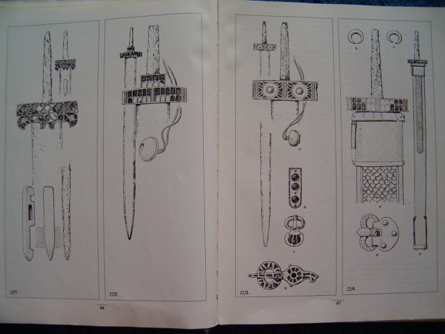

Really interesting sword!
The seller references "Attila und die Hunnen". A few pictures of this sword can be found attached.
I have Behmer's book, as well as a few copied pages from "Germanen, Hunnen, und Awaren". These two picture the same sword, and it's similar (but not the same) to the one attached**.
In the attached pictures, you can note the lack of a pommel, the "flat" lenticular blade which appears to be not pattern welded and the prominent crossguard. These features are common for Hunnish* swords. Finds of Hunnish swords with pommels are quite rare.
In contrast, this sword has a very prominent pommel in a shape that reminds me of the later Germanic migration age swords, e.g. Sutton Hoo. This hilt looks to be a solid casting which I've never seen on a Hunnish sword. The scabbard fittings look a bit similar to other Hunnish swords, but these are thicker.
According to this website: http://www.eskenazi.co.uk/Exhibition/Stoclet/StocletIntro.html the Stoclet collection focussed mainly on Asian artifacts of shady provenance (as usual in that period). So this item might even be Central Asian and of a different period than commonly associated with the European Huns. Who knows... It does have a Chinese taste to it...
Another interesting comparison can be made to the so-called "Stilico Diptych": http://upload.wikimedia.org/wikipedia/commons...iptych.jpg although I think that sword has more Persian than Hunnish features.
*note that when I say "Hunnish", the correct term should probably be Eastern European steppe nomad. Of course many of the finds identified as Hunnish could just as well be Alan...
** also note that the the sword I posted pictures of was auctioned at Hermann Historica. It has been published in "Attila und die Hunnen", but I don't know it's provenance.
 Attachment: 13.15 KB
Yes and no. The Hunnish swords that I've seen presented as such are quite different from, say, Roman swords. Nearly all of them are found in Eastern Europe and therefore mostly published in Russian and Hungarian. There are also a few German language publications, and these are probably more accessible. I can really recommend all the publications referenced by that seller for some issues of Hunnish swords.
Of course, whether the occupant of a single grave was an ethnic Hun (whatever that is) or that he belonged to a people allied to the Huns is nearly impossible to say.

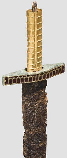

PostPosted: Tue 18 May, 2010 1:01 pm    Post subject:         Reply with quote
And another Hunnish sword, also from Hermann Historica.
Also here: lenticular blade, prominent crossguard, no pommel. The gold leaf hilt resembles the later Germanic gold hilted spatha's.
Interesting swords, but it seems that the Huns cared more for intricate decoration than for nicely shaped blades. Strange for such a practical people...

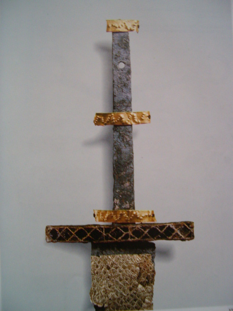

PostPosted: Sat 28 Aug, 2010 4:19 am    Post subject:         Reply with quote
Easter swords from István Bóna: "A hunok és nagykirályaik" (The huns and their (greath) kings)
Made long, to kill enemies from horseback.
I love these swords too.

PostPosted: Sat 28 Aug, 2010 5:47 am    Post subject:         Reply with quote
Thanks for the pictures. I think I have the same book, but translated into German. The title is "Das Hunnenreich". Quite an interesting book, and the best overview of Hunnish swords I've seen sofar. Do you have any other recommendations for books on Hunnish weapons? From my side, I can recommend "Attila und die Hunnen", which has quite a few nice photo's.
Still, I've not seen anything close to the sword that started this thread.

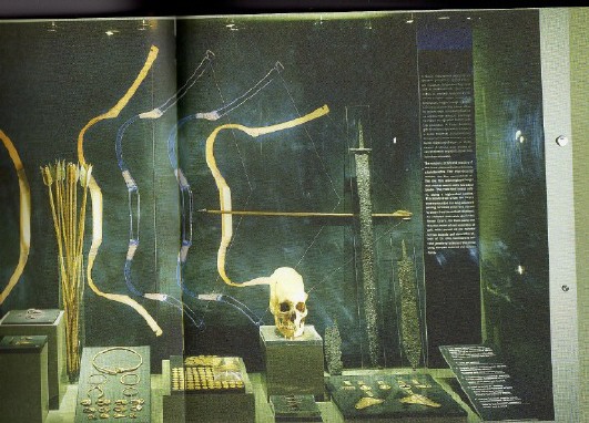

Easter riders and their weapons:
http://www.transoxiana.org/Eran/Articles/mode.html
Permanent Archaeological Exhibitation of the Hungarian National Museum, Early Migration Period Room, hun artifacts:
Zoltán
